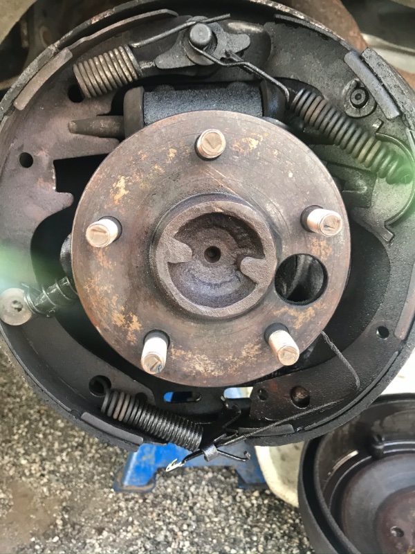

Ok, this is an odd one and I’m currently stuck. When I first got my car I notice that if I reversed a little fast there was a clunking noise somewhere at the rear end. A few days later noticed a hot rear brake drum, posted on FB about the struggle to get it off. Did eventually and found the spring for the star wheel hanging loose, fixed it and drove on.
Today whilst driving out I noticed my brake pedal was sinking too much, I managed to get back through town constantly pumping the brakes and arrived in one piece. Here’s where it gets wierd..
I checked 3 of the wheel cylinder and noticed one had a slight leak. I checked the MC and noticed a tear in the diaphragm and thought that may be the cause.
I then reversed the car down the drive and heard some nasty metallic nose from the rear, suddenly lost all pedal and stoped the car via handbrake before I crashed it :roll:
A quick check showed that the rear wheel that I’d had trouble with previously had completely blow out and there was fluid everywhere. I’m sure something is wrong with the brake parts but no idea what.
Any ideas what happened here?
Also, the drum
is stuck on and refuses to come off and I’m stuck.

Thanks fo the offer, much appreciate that. I’ve already ordered a bunch of parts from Rockauto.
Dave was spot in with his diagnosis as usual. Pic shows the carnage :o
