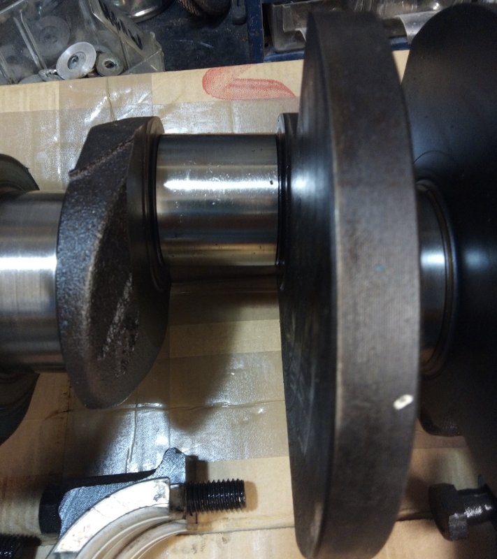

Heres the crank out of the UK engine . am happy to go again with this crank
- IMG_20201202_074842_862.jpg (93.45 KiB) Viewed 1930 times

PPS crank looks alright doesn't it, someone might have aggressively measured that rod journal with micrometer, doesn't look like anything to be too concerned about will p o l i sh
itself in use.

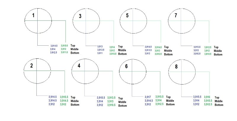

Thanks Mr
been busy today over 160 measurements on the bores did everyone at least 3 time 3 1/2 hours sat on a stool in the garage even with heating still fkn frozen now.
This is what I have
This is what I have
- bore sizes zzz.jpg (38.45 KiB) Viewed 1878 times

Cylinder Bore (standard) 3.910"-3.912"
Cylinder Bore Out-of-Round(Max. allowable before reconditioning) .005"
Cylinder Bore Taper (Max. allowable before reconditioning) .010"
sorry still at work so haven't looked too hard its worn as you expected or was bored for a none standard piston that demanded greater clearance

So if the block above is short term you could just hone it and put the pistons back in... see how it goes.
and the stroker in the other block will want proper bore and hone to get the best out of your investment.
be good idea actually to choose the block with the tallest deck to give you flexibility on the stroker build as its is going to be the keeper but i guess the one that really needs the rebore should be the one that gets it
the one above does needs one, but not as much as the previous one, and for minimal outlay you could build a motor that functions with it
