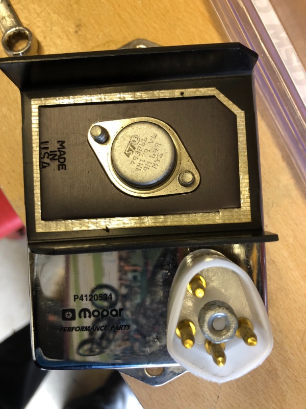

Hopefully you can guide me to an answer on this please.
I have a Mopar Performance module on my Road Runner that I believe to be defective,the direct replacement for mine seems to be discontinued or unavailable and there is a lot of internet chatter about good and bad modules. Firstly does anyone know a supplier for the module shown? If not could I have opinions on what route I should go. I have seen an FBO system which says I must run their coil too a d was contemplating that. Thanks in advance Stewart.
Re: Mopar Performance Ignition Module
Far as I knew you can pop virtually any box on there. There are 4 and 5 pin but I had FBI, orange box and I think there was even a blue one in there somewhere.
4 pin orange box should be easy enough to get ?
I think I got one from frosts or hausers off the shelf when I went though my blowing-them-up-phase. Check voltage reg too ! Got caught there thinking it was box. Also, good earth.

This is it.
http://4secondsflat.com/Ignition.html

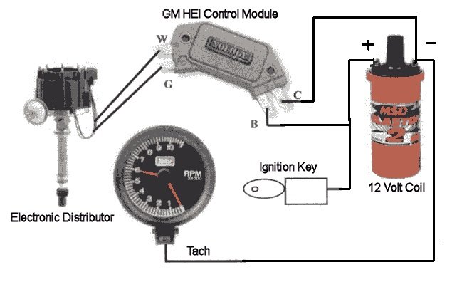

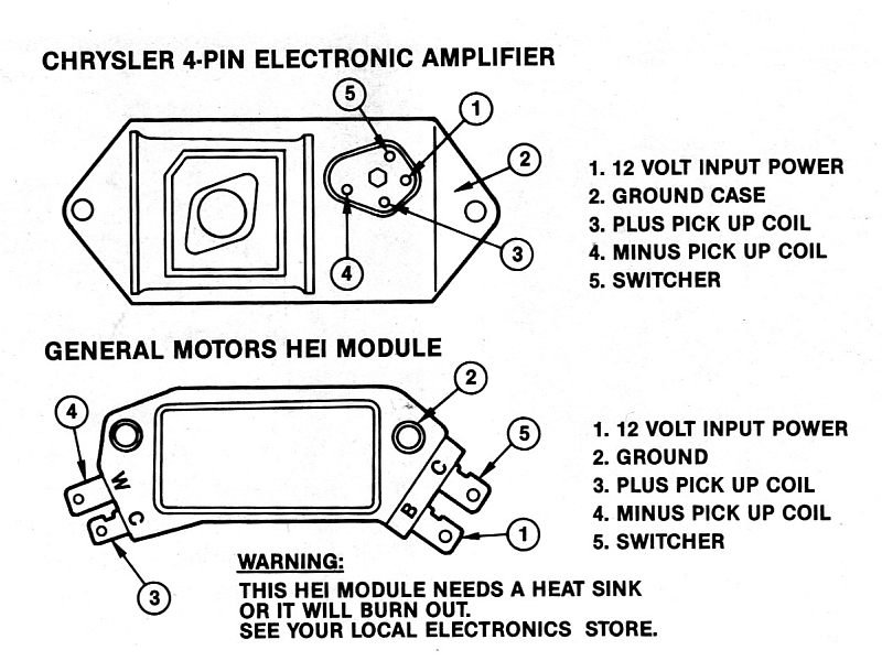

other option is to gut your current box, keep case and heat sink, snip off the legs of the transistor and glue it on to the front
put in GM hei module bolt through into heat sink, and wire it to the connector, you can run it with a range rover and SD1 v8 coil DLB198 about 23 Quid for the coil and £7- £70 for the module....
you will need to snip off its mounting n 1 p p l e s to get metal to metal contact with box interior
the modules fail every 5-8 years as i found at the HRD this year but they are cheap as chips i never pay more than about 15 for one
just bypass your ballast (i.e move the coil + feed to the other end) and good to go
does the same job with electronics in a chip rather than discrete resistors capacitors and a big shiny jacketed transistor
once its bolted inside the mopar box and wired up
cut a piece of nylon chopping board and silicone it into the back of the box..
dave
dave
This is exactly what I did on my Polara
When I did my conversion, i mounted two modules onto a computer heat sink. If one packs up, just swap the wires onto the other one to get going again if needed.
I know the module earths through the mounting bolts but I made up a small earth cable that I ran from one mounting point to the car bodywork. A bit overkill but bad earths are a constant source of issues with our old cars. Definately worth doing in my opinion
Cheers Steve
Cheers Steve
