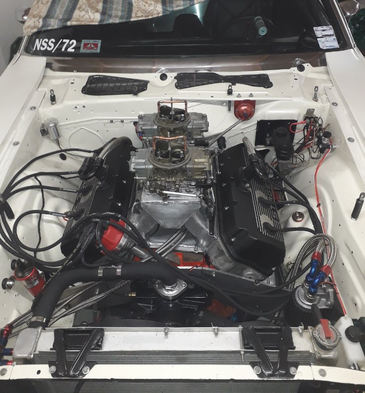

Does the Engine have a "Hemi Head"????
- Engine Bay.jpg (148.52 KiB) Viewed 1081 times

Hi Pete,
You mean them two big silver things? They are a dead givaway! Yes Stage V Hemi, on a 440 block, built about 25 years ago.
Spike.
Spike.

Looking at your picture the motor looks a lot lower, particularly on the drivers side. Is there a dimension to head for, say height from the top of the wing?

The dimensions are as Blue says, as you are getting the balancer / crank bolt in the correct position.
Chrysler engines are off set 2.5" to the Pass side, but you have to get the height correct too.
My engine is on a motor plate, but the same basic set up still applies...
