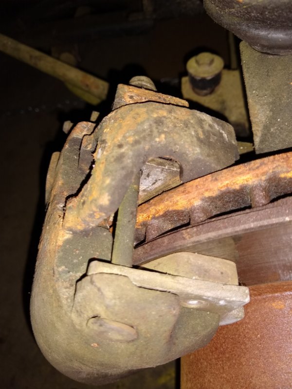

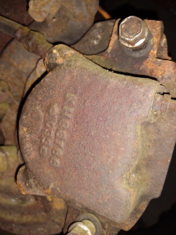

I found the part number on the back of the caliper, they are Kelsey-Hayes. Looking up the part number, which appears to be KH86166, I'm not sure they're correct for a '73 Challenger? I think they're supposed to have a retaining spring / clip as an anti-rattle device as you say, but it's not present, and I can't see where that would fit. It also seems to only act on the outer pads, whereas the 'loose' ones on mine are on the inside. They only move in a front-to-rear direction, not side-to-side (as you may be able to see in the youtube video), so not sure there's any problem with the piston / lack of shims etc in that direction. I might try putting copper grease on them anyway, to see if that helps.
Couple of pics:

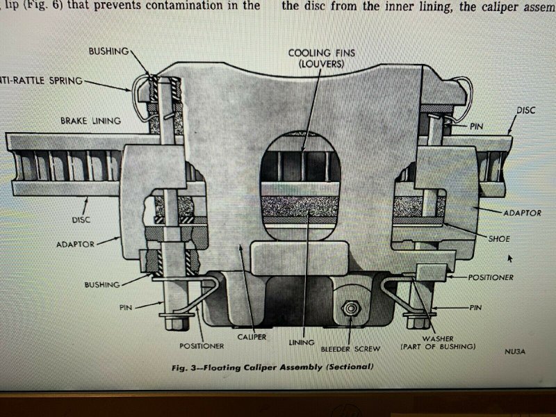

Thanks for all that Dave! At least I know I can get the springs from RockAuto without the pins. I found someone selling the postioners on eBay, and although they're more expensive than the ones you linked to, they did provide a diagram of where they go:
...still not sure they'll stop the inner pad from moving backwards and forwards, as they don't appear to touch them?

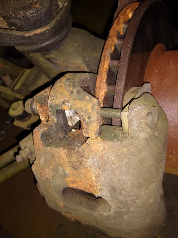

I just took this video, which shows the inner pad seems to have too big a hole for the pin, so it moves back and forth. Not sure any of the springs or positioners I've seen would stop this?:
Edit: I think there might be a bushing missing. I'm thinking I might just squish some RTV sealant or similar into the hole either side of the pin, which would hopefully stop the rattle!

yep agreed the positioners are really about keeping the caliper centred onto the rotor, suppose it helps stop the caliper being biased to 1 pad or the other..

do the pads both have the same sized holes and are they the same inner and outer? i.e have you got front in the back and vice versa
short of making a little bush for it.... yes stuck
unless combo of anti rattle springs and positioner just keeps the caliper tensioned slightly so that the pads are always driven against a hard stop, kinds seems wrong as the disks would get hot....
