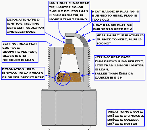

Any ideas on the heat range of the plugs Blue? Could the miss be detonation? I’m running BP5S ngk.

You need to read the plugs earth strap, that will identify the heat range the engine wants. You can get a misfire by using too hot a plug, I've had that in the past. Detonation itself sounds like a metallic rattle rather than a misfire
- unnamed.gif (35.88 KiB) Viewed 683 times
