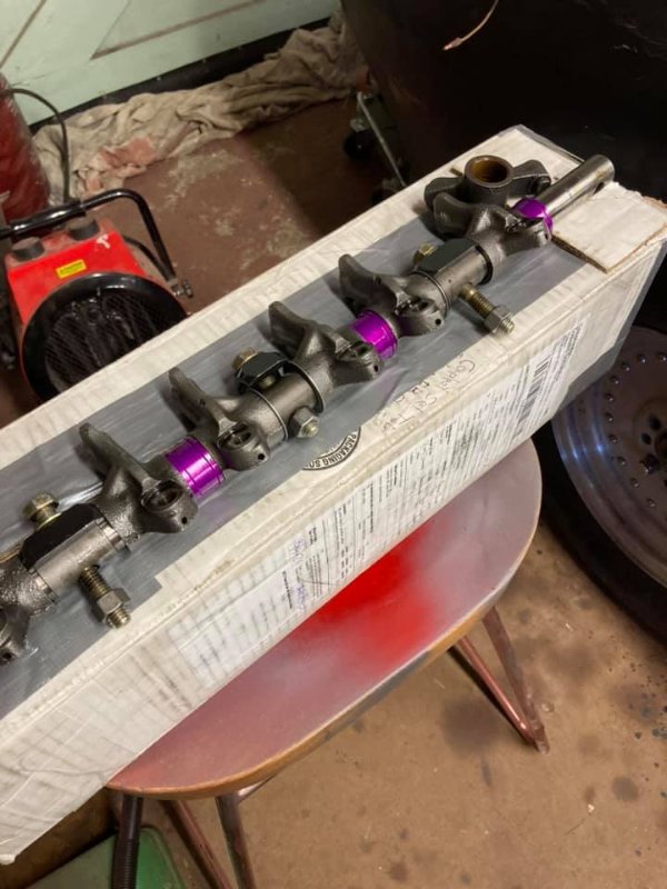

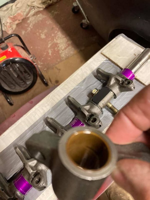

To be honest i had them done just to be safe ,and the cost was not that great compared to a new set of ali heads ..All in i reckon the heads stand me in for about £850 that includes valves and work by the machine shop ... so in my book that is half the price at least of a fairly ordinary set of ali heads ....i am being told a hydraulic flat tappet cam is the way to go for my goal but if i step up and go all in a mech flat tappet is the option .....but that will mean chucking a good few quid at the valve train with ceramic coated lifters and fancy pushrods ....i have a real cool set of OEM MW rocker arms that have been bronze bushed and reworked at some expense ..I got them of a guy in Sweden who is a serious SS racer ..I did not want roller rockers one because its about factory parts for me with this project and two when they let go with them needle rollers its damage right through ....the old MW rockers are almost bullet proof i believe
174444548_5591491394226337_6254991480328658286_n (1).jpg (72.82 KiB) Viewed 1224 times

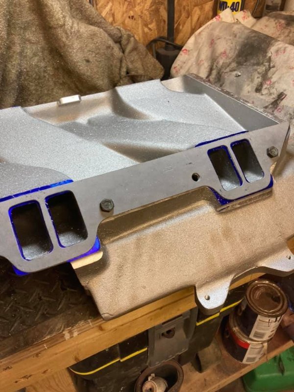

Blue wrote: Tue Jun 29, 21 5:57 pm I’d block the heat riser as well if I was me…
Blue i need educating here mate ,my inlet has no provision for heat exchange so is that closing them off in a way ???
182995362_5697275433647932_1125039914114445679_n (1).jpg (99.85 KiB) Viewed 1217 times
Posts: 14459
Re: Porting Heads
Ah yes, I was forgetting you had a cross ram! No need to do anything else in that case.
