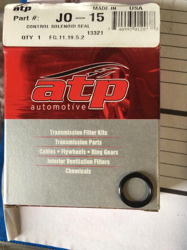

Aaaaaaarrgghh!!!
Just checked the delivery and the wrong fricking parts again!! :banghead:
No O ring, just this teeny little thing along with the pinion seal...
Doing my head in now. :angryfire:
Note to self, check delivery off line by line. Another lost day.

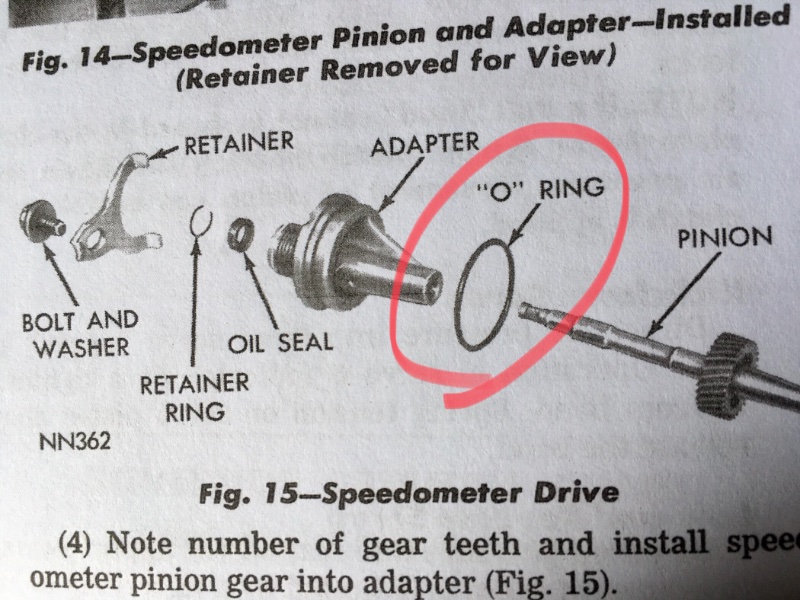

Anyone know the correct OD/ID of the o ring in question? No joy finding one in the UK and need it for Saturday, so going to have to try and source from a local supplier and hope I can find something that fits. It’s the one circled in the pic. No joy on wanted thread.
Posts: 9567
Re: Transmission leaks
i purchased one of these about 20 years ago
https://uk.rs-online.com/web/p/seal-o-r ... lsrc=aw.ds
and have been using the nearest metric o-ring in just about everything i have ever needed to o-ring
apart from one designed as a grommet for my brake bias that needed a split o-ring of specific 1.5 inch dimater to act as a grommet but look like an o ring
ended up puchasing 3 one too big one about right and one too small.... too small ended up getting the job
I think what you need is an O ring 1.75" OD by .100" thick based on tinternet rather than any experiance with 727 904 or a833 ad their speedo holes
44mm or 45mm by 2.5 or there abouts Buy a couple and vary the OD and the cross section 1 will do the job
or the nearest metric equivelent
https://simplybearings.co.uk/shop/Produ ... gcQAvD_BwE
Posts: 14457
Should have mentioned it Today fella, I have one now! Drop me a PM we can sort it.
Posts: 7128
All good thanks, chaps, I’ve since picked one up from Flea Bay and fitted it a while back, stopped the leak that the metric equivalent had. 👍
