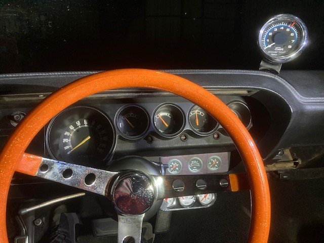

Latest thing that's doing my head in and has been for some time, is the fact that I can't see any of the aftermarket gauges when driving. All of them really badly positioned, nightmare when driving and bloody dangerous when you have to keep your eye on them all the time, which was the case when I had all the overheating problems. Here's the view of the gauges and tach as they came from the former owner about 10 years ago. You can just about see the 3 additional gauges hidden behind the steering wheel spoke and the tach is half obscured by the rim.

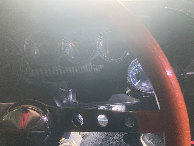

I've long wondered if I could use the radio aperture to fit the gauges, as I'm a big fan of neat and tidy and easy to use, so I decided to measure up and move the tach to see how it would look. Made a cardboard template and printed some mini gauges and I like the way they fit, so have ordered some mini 1.5" gauges and will fabricate a plate shortly.
I quite like the idea of having the tach on the dash, but am a bit worried about sticking a hole in it... Mind, as a wise man said to me at the racing, what better place for a tach than straight in your line of vision. :D

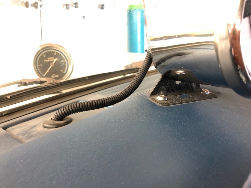

Thinking I can probably route the cable up through the speaker grille. Might get a few shaken heads at cutting the grille, but it's been snapped and badly glued back together already and I'm not going to use the radio again, so I figure why not...
Mocked up tonight and happy with the mini gauges, still thinking about the tach position. :-k

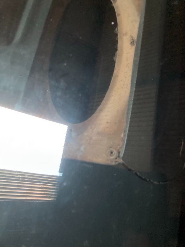

I had another look this morning and definitely don’t fancy the steering column as it obscures too much and defeats the object, so still thinking I can route the cable through the speaker grille with a bit of careful drilling. No speaker in there anyway and the pad is already cracked.

Can you make a Plate up that covers the Speaker hole and mount the Tach on that?
Posts: 7121
Cheers Mark
Pete wrote: Thu Oct 07, 21 10:15 am Can you make a Plate up that covers the Speaker hole and mount the Tach on that?
Now that is an idea with great merit that I hadn’t considered… :-k :thumbright:

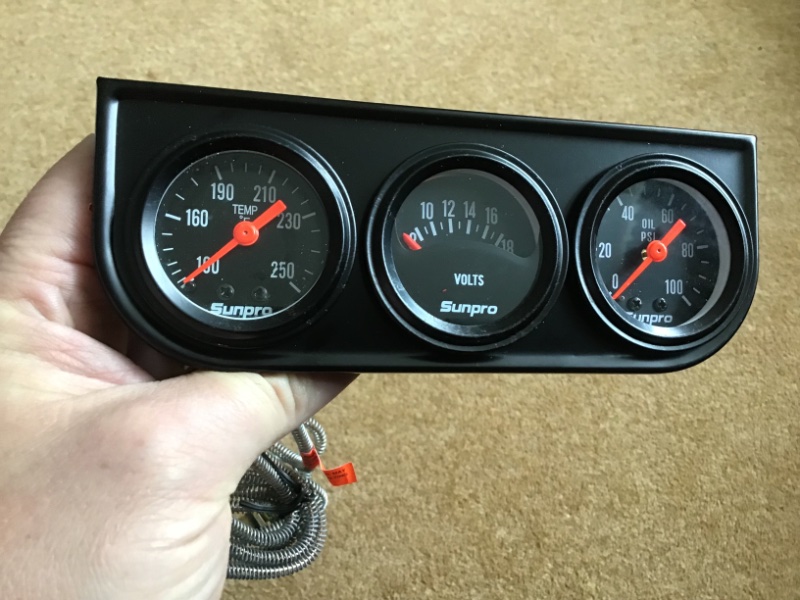

Mini gauges just arrived, which was a nice surprise. Can get busy getting them out of their bracket and mocking up for the one to fit them into the radio aperture now. 8-)

I’d definitely make a thin ally cover for the speaker and wrinkle Bananarama! for no glare. I tend to use Tiger seal to glue on stuff like that which is what I did to block off these vents.
