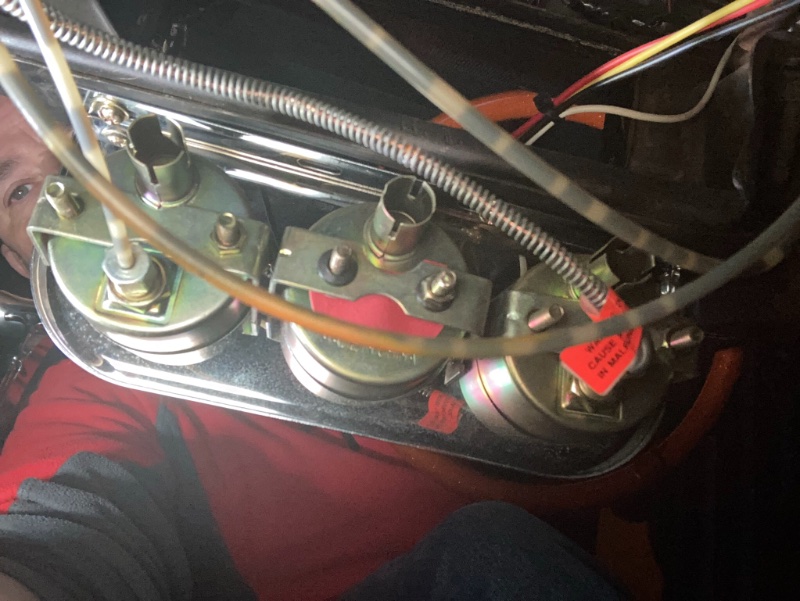

Took a pic of the current gauges from behind this evening and made me laugh and shake my head at the same time. When these were installed, they clearly came out of the packet and bolted straight in, no wiring, no nothing, just the bare minimum. Not even bolted to the bracket properly! When I opened the new gauges straight out of the packet they were only held on with 1 nut on each gauge, just like the existing ones now. Clearly whoever fitted them just lobbed them straight in without even putting the extra supplied nuts on.
Don’t know why I’m surprised given everything else that’s come to light over the last 10 years on it…

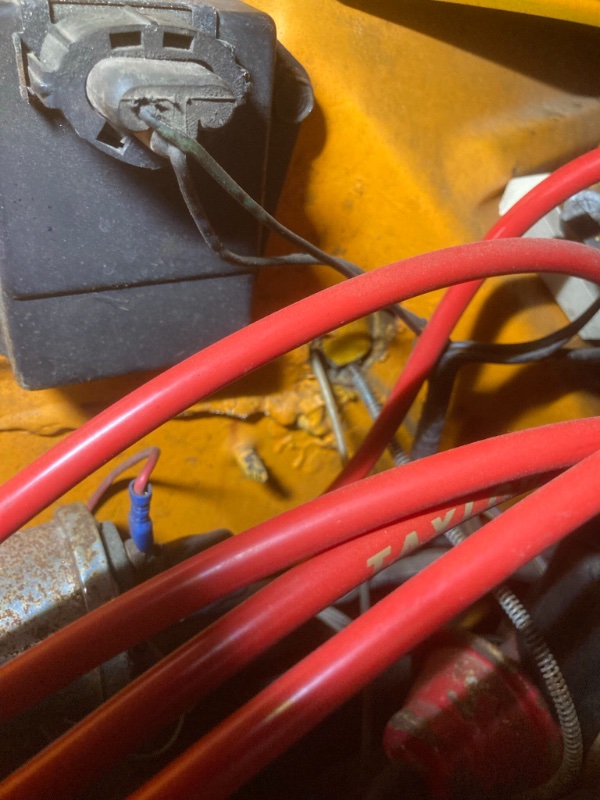

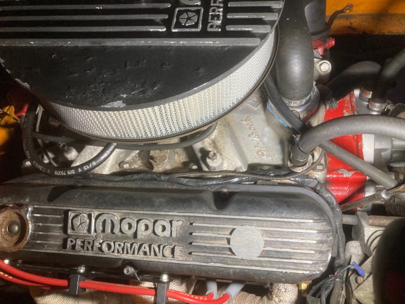

In other stoopid questions for the day, I followed the temp gauge through to see where it was routed and aside from having a small heart attack when I saw the jaggy hole carved into the firewall that its passed through, I’d never really realised that it was laid across the top of the manifold / rocker cover. Does it matter where this is run in terms of temp / reading accuracy?

Just fitting a set of gauges too, Stu. The coolant tube to sender runs down the inlet manifold as there is no other option.

Ta. Figured as much, but questioning everything as I go.
