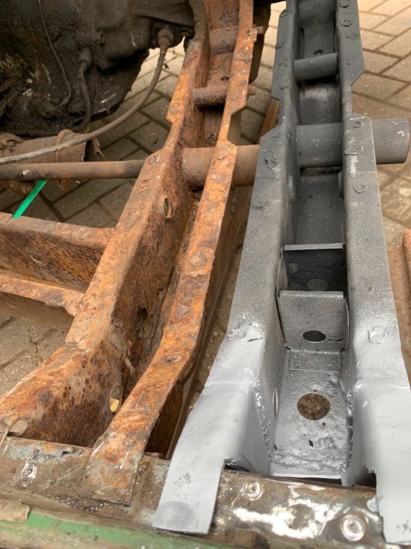

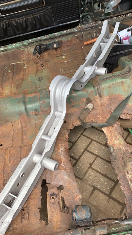

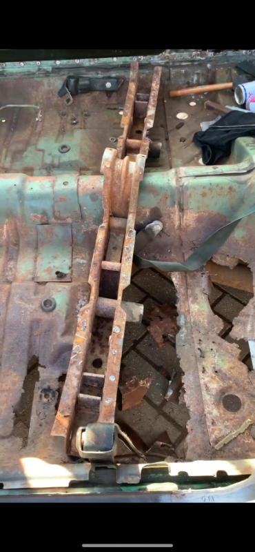

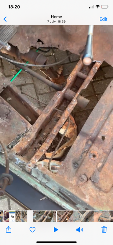

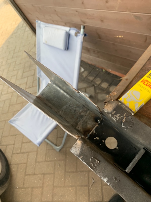

So it’s been a few weeks since my last post, but I have not yet quit! Still at it and slowly progressing. A big big big one out the way….
New torsion bar rail installed
New front floor installed
New centre floor installed

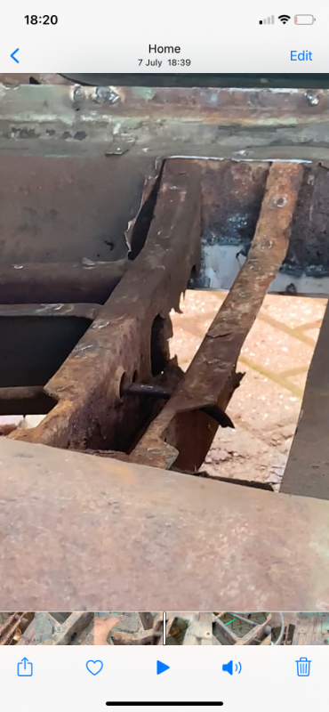

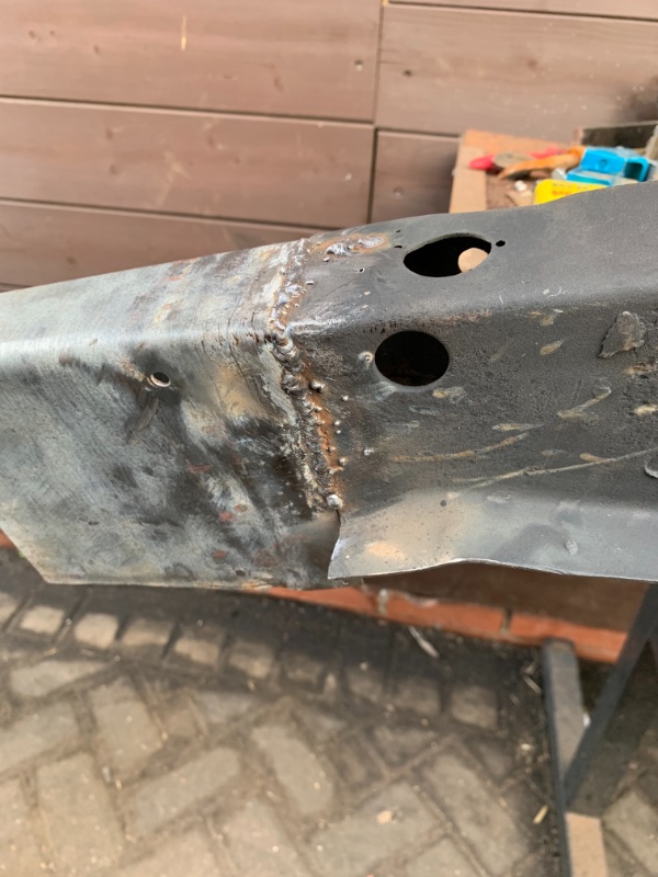

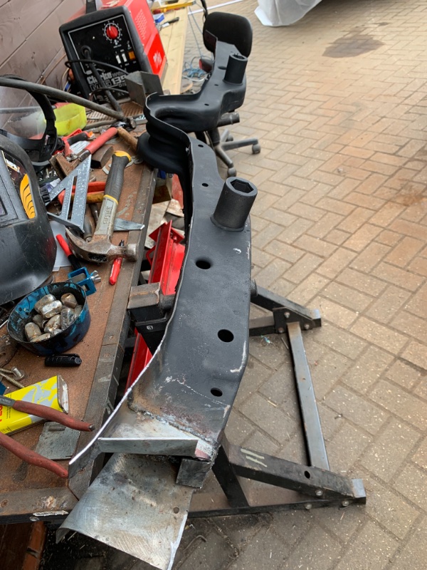

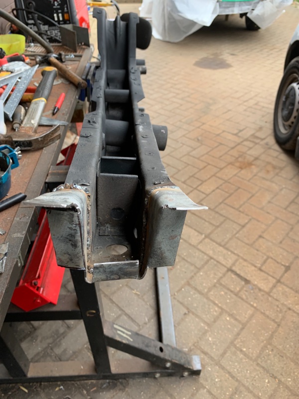

So, after removing the old floor (or what was left of it) I supported the car to remove the torsion rail that was rotten and crispy. Lucky for me, the seller left one in the car that was removed from another charger. The part however was just cut out and was to short so I had to re fab the ends and that was trickier than it sounds, as if it does not go EXACTLY in the place of the old one, of course the torsion bars will not seat without bind. Took the part for blasting and it was in fantastic shape so the quest to get it right began. Honestly really lucky I had that part otherwise it would have been months on delivery and another £600 in parts, tax and shipping. Monetary issues aside I’d have lost that time on the restoration.
This was the state of the floor and the torsion rail

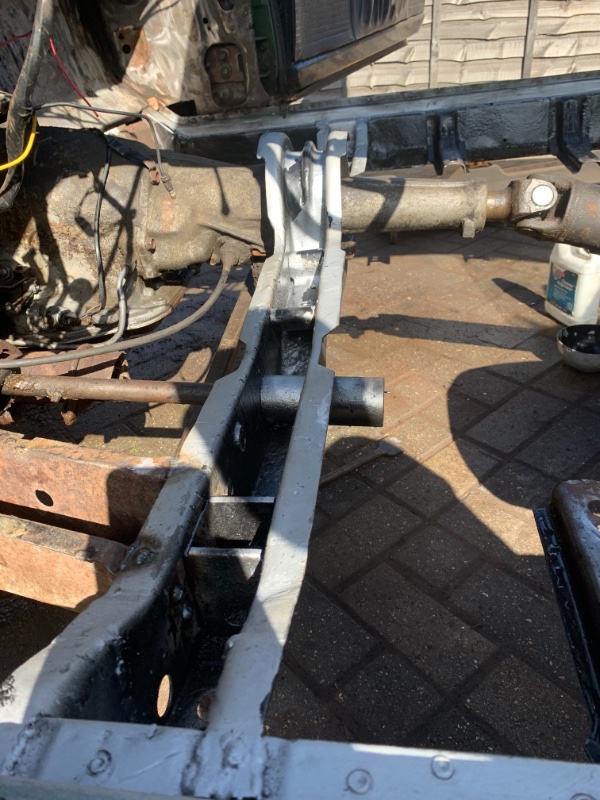

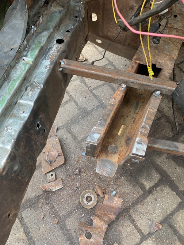

This was the cut short replacement piece
After blasting
Then fabricate the ends Once happy with the torsion cross rail, Then we go on to prepping for the new the floor. My god, the never ending prep work
The car was braced and supported from below so nothing moves. The bracing was only removed once was the torsion rail was welded in, with the the lower supports left in place. I stupidly did not take pictures of this and I really am kicking my self for forgetting to picture that. But basically I welded in inch square rods to keep the frame rails where they need to be, and welded in again between the rails, so when the new torsion rail and floor goes in, it should align exactly where it needs to be.

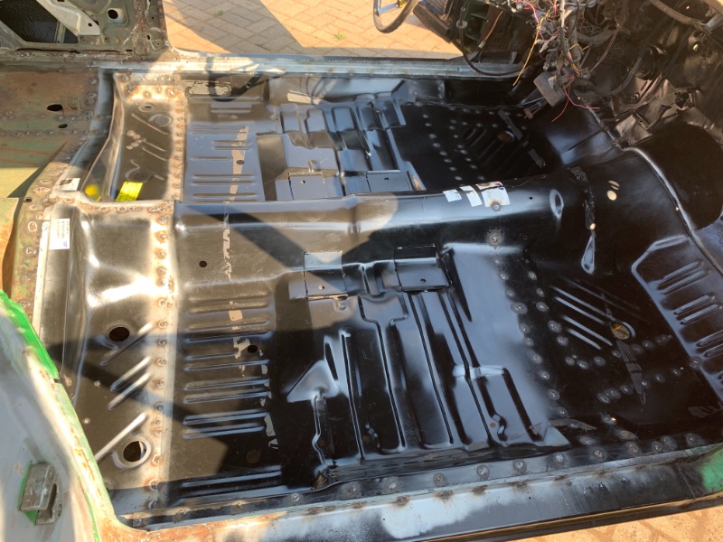

After cleaning and prepping the inner rockers~ I was happy to leave them in place. They were in good condition and I know this as I cleaned and prepped them when installing the outer rockers. After prepping we was ready to weld in our new floor.

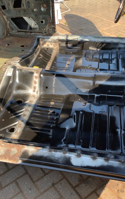

I used the AMD for the main front floor, but as they never had the two centre quarter pieces in stock when I was ordering, I ordered the goodmark ones from rockauto. What a HUGE difference in quality. The AMD floor is about 2mm thick with the goodmark being about 1.2mm thick. I struggled to weld it in as my welder kept blowing wholes through it was that thin.
Anyhow got there in the end and this is where I am now. Once the welds are grinded down, it should almost look factory. The AMD B.Body front floor pan is a fantastic part in quality and fitment. The goodmark parts needed work….
I’m in the last of the panel work after this. Iv got welds to grind down all around the car (neighbours will love me!) and cleaning up to do. Trimming here and there and seam sealing.
That’s all after the new roof goes on… that’s the next post hopefully. I can almost smell the smell of fuel at this point….

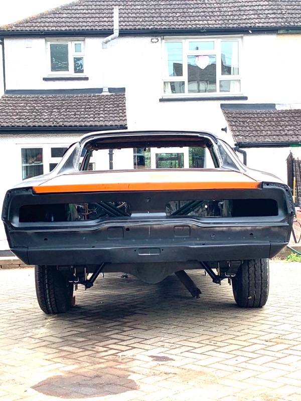

Hello wonderful Mopar community
I’m back! Sorry Iv been off for a while…. It’s been a busy time. Between my last post and now Iv had to do a new kitchen for the Mrs (part of the deal when I brought the charger
) work got incredibly busy after coming out of lockdown and when restrictions where eased and really felt the kids needed weekend time.

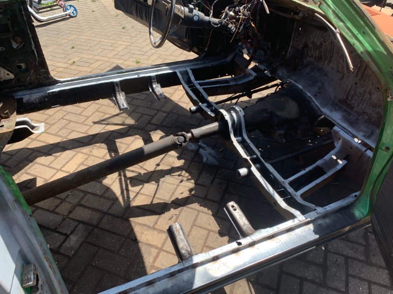

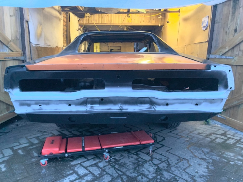

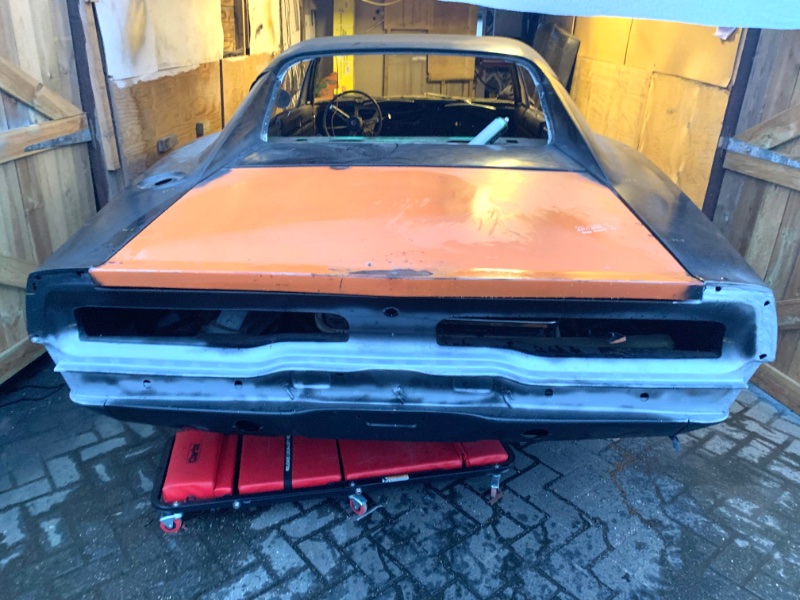

However Iv been doing bits and bobs. Stealing an hour here and there. Yet again another back track to report. Iv spent the last few months coming and going from an issue. If you look at the pic below, you’ll see the right quarter is ever so slightly lower than the left.
I only picked up on this after getting the car back on wheels. So off the wheels again, back on to straight and level floor and out comes the tape measure. It turns out I actually installed the right quarter almost a centimetre lower than the right. God knows how I done this but I’d did! Problem is when you weld things tend to pull and push a little. Take your eye of something for a second and the smallest amount off at the front end of the car ends up being a centimetre or more at the back.
What a pig of a job to put that right. Very carefully undo each weld along the the underneath, the light panel off, the rear valance off, the corner valance off very carefully and slowly without distorting the new metal. I done this over an hour a day as any other way I’d have probably ruined everything. I’m really happy I did this as now the quarters line up better and even if it’s wasn’t noticeable to the eye I knew it was off! I think you can even see the difference in the picture if you look hard enough.
Also, whilst I had the welds “opened up” again, It was a good time to install the correct rear valance as before I had installed a 68 one that I had purchased locally with the intention of cutting the 69 light holes in. So two birds with one stone I guess as the 68 rear valance was another thing that I was not happy about. Honestly hated every Minuit of this part of the build but it’s all back together now and the measurements are spot on so I feel I can carry on comfortably. A couple of “after” pics below.
Another after pic from slightly higher angle
I can now continue with finally getting that roof welded on! Yay!
Hopefully progress will be hard and fast from here on.
