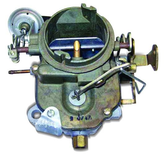

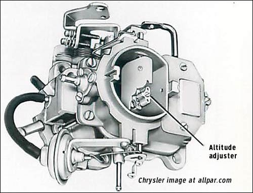

high top, early version with an cast alloy top to the bowl and a later version that gets called a tin top, as per the image below
the high top early one, has the accelerator pump through the top cover of the float bowl its flat rod sticks straight upwards. and it is actuated by a linkage on the side of the air horn. should have a metal disk and a clip to act as bowl vent control around the flat rod.
this is the early style carb. 1960s to about 1972
the other has a tin top, a pressed steel plate bolted over the bowl and the accelerator pump rod is enclosed under the pressed square section it is triggerd by a shaft that goes into the side of the float bowl
1972 until they stopped putting them on jeeps in the early 90s

- Tin top BBD 1970s see the plate over the bowl to the right
- bbd tin top.jpg (38.52 KiB) Viewed 912 times
- see the flat rod through the top of the bowl High top early BBD
- High top BBD early.jpg (44.49 KiB) Viewed 911 times
