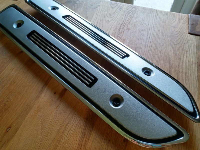

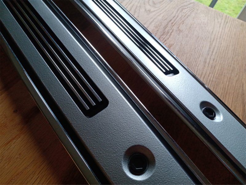

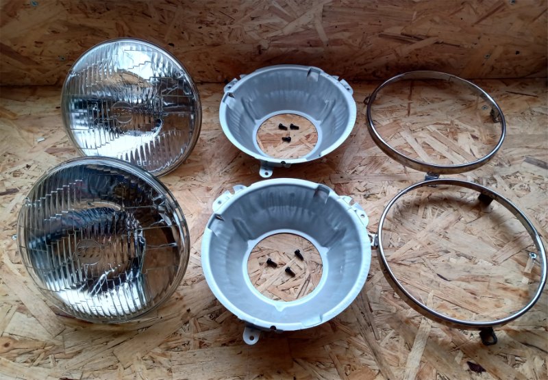

A few bits I worked on a while ago. headlamps/bowls/trim rings given a going-over, and replacement bonnet decorative castings sourced from a guy in London. Mine were very pitted so I managed to find these which were part of a small job lot of other bits & bobs. The paint was shot but the chrome good, so lots of cleaning, masking, painting & swearing later they came up nice. I think I ended up painting them 3 times as the detailing kept bleeding!
Happy with the results though.

Those have come up fantastic. What did you use to paint them with?

Re the hood castings- etch primer, truck bed textured spray, colour & satin lacquer.
The fiddly masking is always the awkward bit on bits like these!

Good call on the truck bed spray, I'll try and remember that one for a textured finish.
