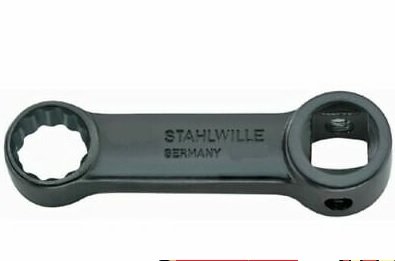

I meant one of these... But yes, making it or a crow foot might be easier !

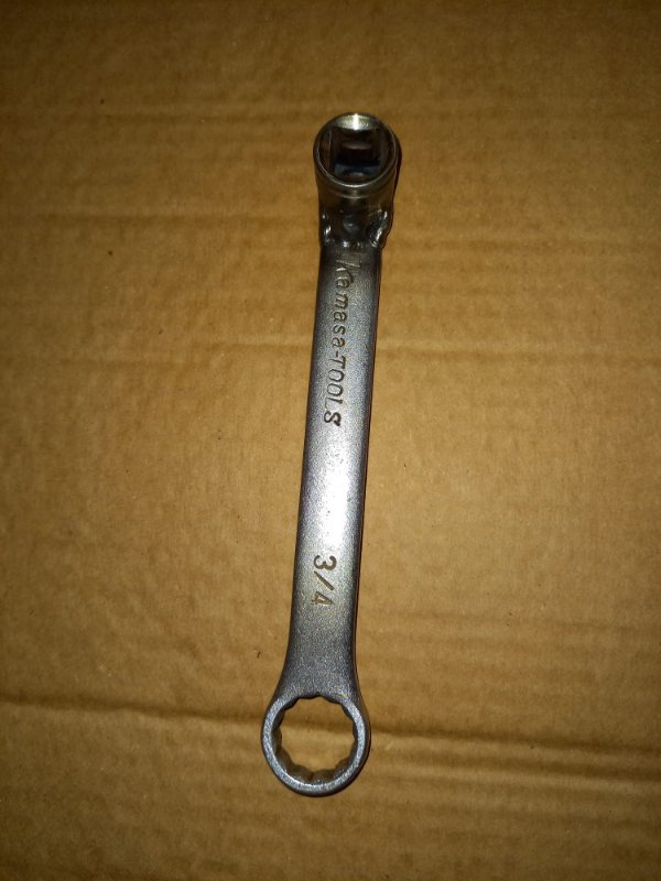

This is what you need, Morgan:
A "Blue & Pete" Custom spanner for use with a Torque Wrench when doing grown-up Torque Convertor Bolts up with an extended Engine sump fitted.
80 ft/Lbs sir? No problem...
Custom Spanner.jpeg (64.91 KiB) Viewed 15740 times
