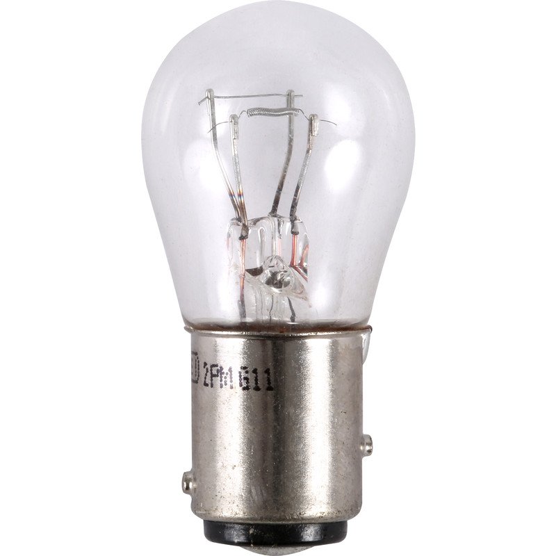

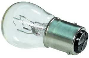

Have you checked to see if you have power at the sidelight bulb holders, Are you puting the bulb in right, is the bulb twin filament with offset pins at different heights. Bulb should be a 480.

Re: Turn signal/front side lights
Thanks Derek, I’m sure the bulb is wrong, doesn’t have offsets. I also used a test wire which established that the bulb holder isn’t earthed. A double reason why it’s wrong. I’ll get the right bulb and try again.
