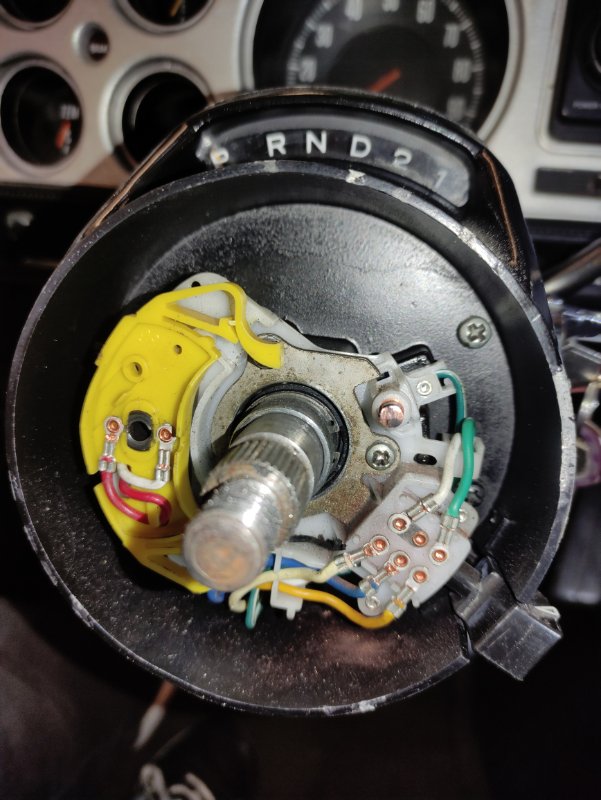

Can anyone explain how the hell you test a turn signal switch on a 79 d150?
I had all lights working except the drivers side stop light,now i have no indicators at all,but that single brake light still works.
Pull the hazard switch,all indicators flash apart from drivers rear,but indicate right at the same time and the bulb flashes ok.
I have cleaned the earths,obviously the bulbs are ok.I can't find a switch in stock anywhere at the moment except this one from summit

That's an 8-wire switch, is that what you have? There's an 11-wire version which seems to fit more of the later models "for full size models equipped with cornering lamps":

Hello,yes,I deffo have the 8 wire one ![Image]()
- IMG_20211123_125442.jpg (94.98 KiB) Viewed 2076 times

Hello fellas and thanks for answering.I ordered that switch from summit and it arrived today,fitted it and everything is working mint.It doesnt have the "feel of quality" of the original switch,but it seems to be working fine.
Miles,thank you for explaining how the circuits work,it was actually very interesting,i was racking me brains over it for ages and that cleared up things for me.

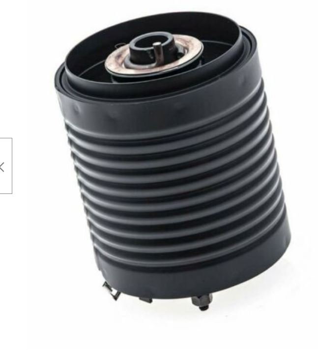

if the switch part works but the self cancelling cam has bits snapped off
buying a new cam is often a better bet than a whole new switch
US and Aussie Ebay https://vansauto.com/product/turn-signa ... -b-c-body/
and similar
self cancel only works if your steering wheel boss has a pressed on spring steel ring with its end bent down to ping the cancel cam
i have 3 crush tubes and two of them have this bit missing
if yours never had one you'd be unlikley to spot anything wrong as the horn still works even if that copper conact is missing

- crush tube.JPG (42.04 KiB) Viewed 1871 times
