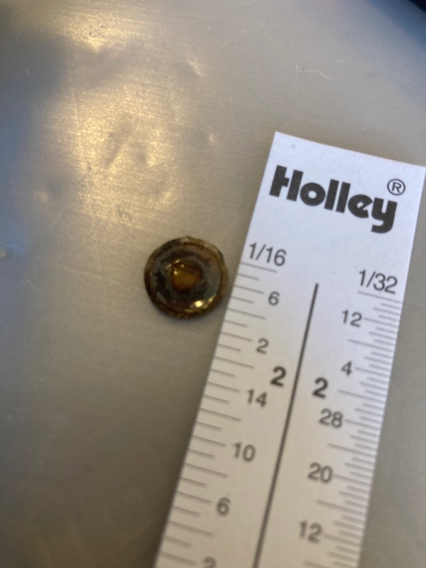

I don't recognise that, is it like a brass disc or something?
Posts: 22113
The one top right is probably a Shooter gasket.
The other looks like a Float Lock screw upside down, cannot really tell from the picture.
There will be lots of "spare" parts in a gasket set that you will not use as they are "universal" which is code for "Fits nothing!!"...

Not 100% sure what it is Blue, but think it’s fibre and got some sort of adhesive or sealant on it.

Top right one wasn’t meant to be on the pic, sorry! :lol: you are right though, it is a shooter gasket. :thumbright:
It’s the little round disc that’s got me confused.

Nope, no idea!

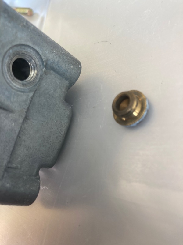

Next dozy question… should there be an o ring or something around the fuel bowl sight plugs? Doesn’t look like there was in the photo from when I took it apart, can’t tell from the diagrams, but the slight recess in the outside of the bowl suggests there should be something. Can’t find a perfect fit in the kit, though. Closest are the ones below . :scratch:

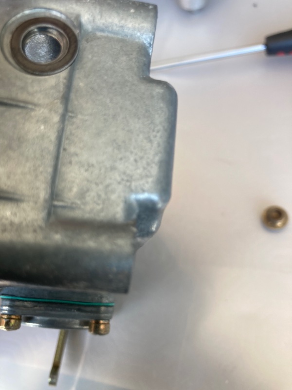

Came to the secondary metering block and the gaskets in the kit are completely wrong. Old ones on the left, remaining ones in the kit on the right. Looks like someone may have swapped the block at some point, but leaves me without the right bits.

I seem to recall your carb has had a secondary metering block conversion so the gaskets will be wrong, it would normally have a metering plate which doesn’t have replaceable jets.
Posts: 7121
Yep! That looks exactly it. Guessing I’ll need to order the gaskets same as for the other side. Am I right in saying it’s effectively been converted to 4150? :help:
Posts: 14434
Yes uses same gaskets front and rear. 4150 also has metering blocks back and front but other than that it’s a very different beast to a 4160.

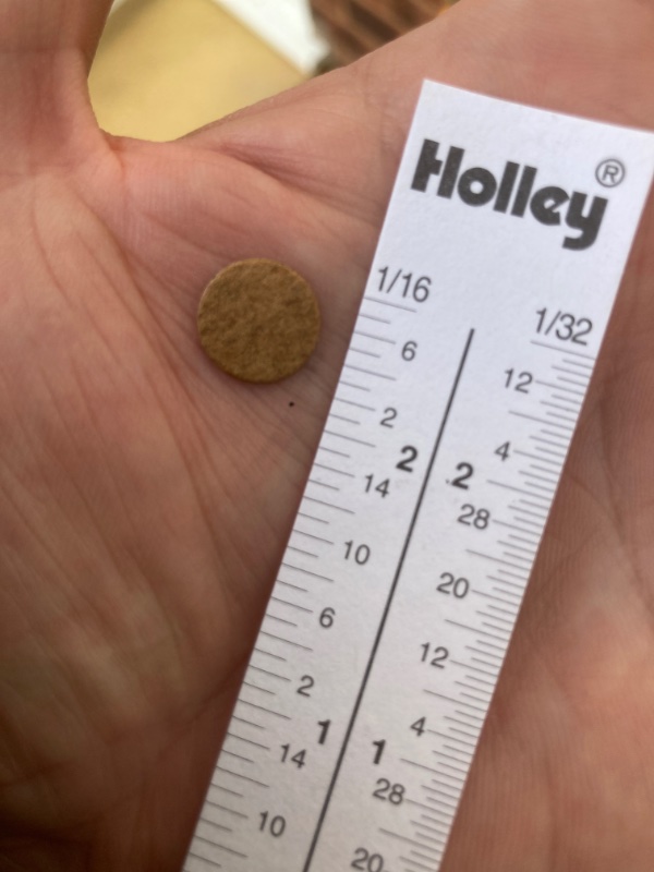

In the meantime, I found this in the kit, which looks very much like the disc we we’re trying to to work out earlier… :-k
Posts: 14434
Still don’t recognise it! Is this a 600 carb?
Posts: 7121
Yep!
