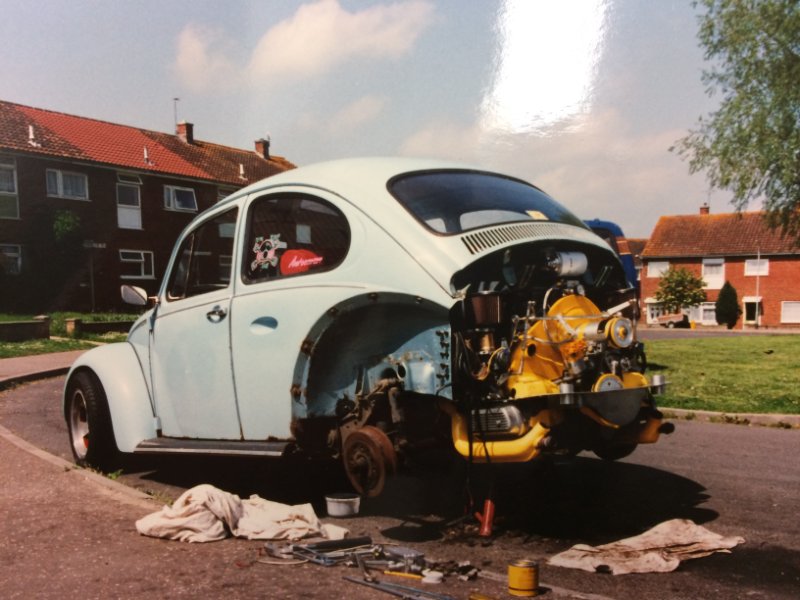

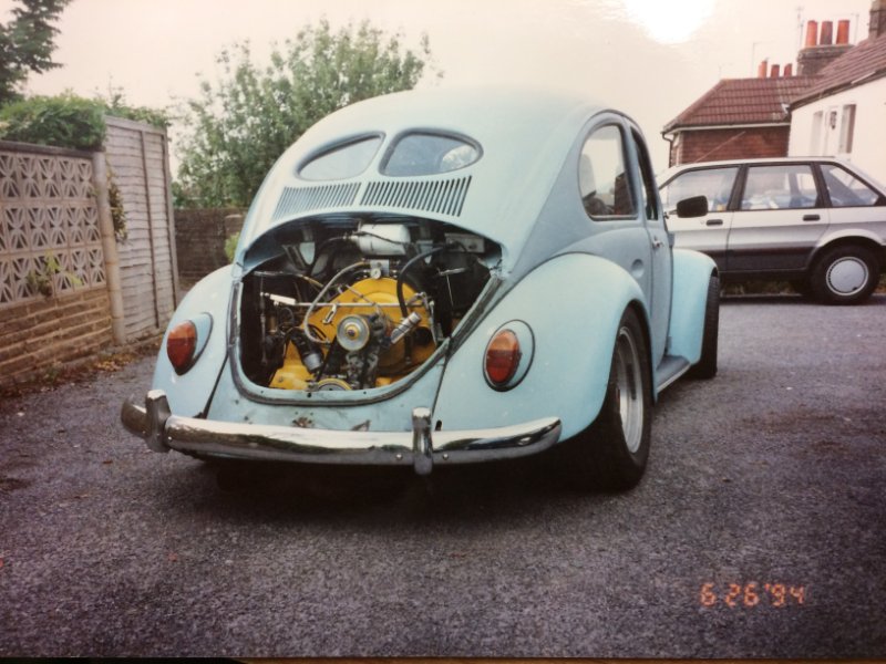

I used to have mine in and out so often, I cut the back of the car off...
You could undo the wing bolts and the jointing plate I made up by the cut line, and lift the rear valance, bumper and both rear wings away as one bit.
You could only see a small line between the wing and the decklid when it was all bolted back.

Yeah that's a useful mod to do Dom. Makes life a bit easier!
