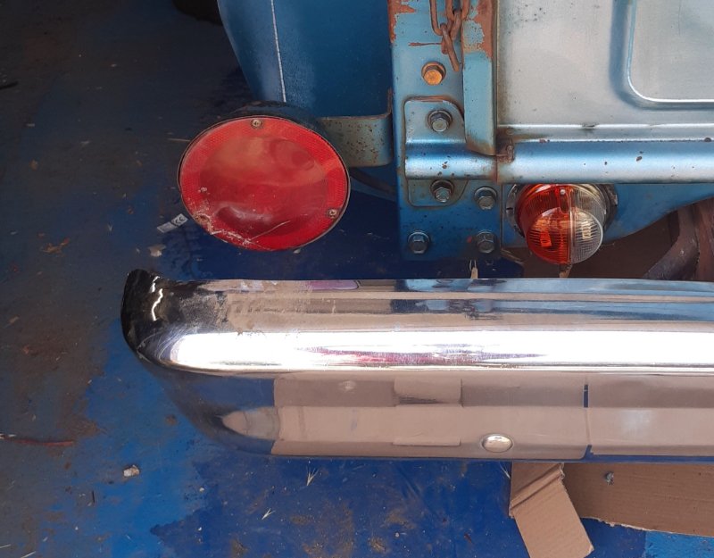

Starting sorting the lights straight away, I wanted to keep the original tail lights rather than put modern ones on so have fitted indicators where the original reversing lights were just by making an adaptor plate and sorting wiring of course. Don't know it's just age related or coming from a hot state but all bulbs I found has concave indents on the bulb contacts
Oh and the tailight lenses are available on amazon from the original manufacturer!

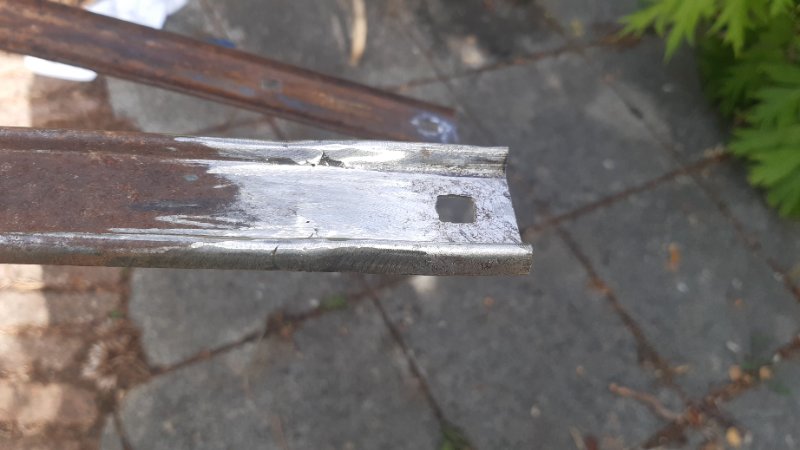

Got some new tyres on today, found some marks on the back of the slot mags saying size (15 × 8.5) "wheel dist inc" and "Ontario Cal" so nothing special I'd imagine there were loads of people making wheels back then
Rather than stainless strips in the bed I've used the original repaired one section and am painting them hammerite blue in a nod to the original finish as Dodge would have painted everything inc wood body colour
