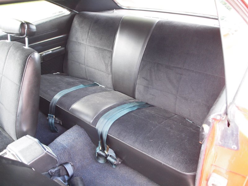

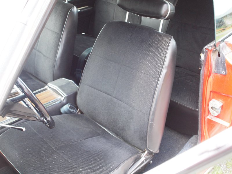

Mine is C5
Any idea if this is for cloth or Vinyl?
Seats currently cloth so want to know if they are original or not
Thx

Unless I’m reading it wrong, that’s C55, which is bucket seats. :read2:

The only cloth & Vinyl seats listed in the red book are C5X, that I can see, so pretty sure that would confirm yours were vinyl buckets originally. :-k :thumbright:
