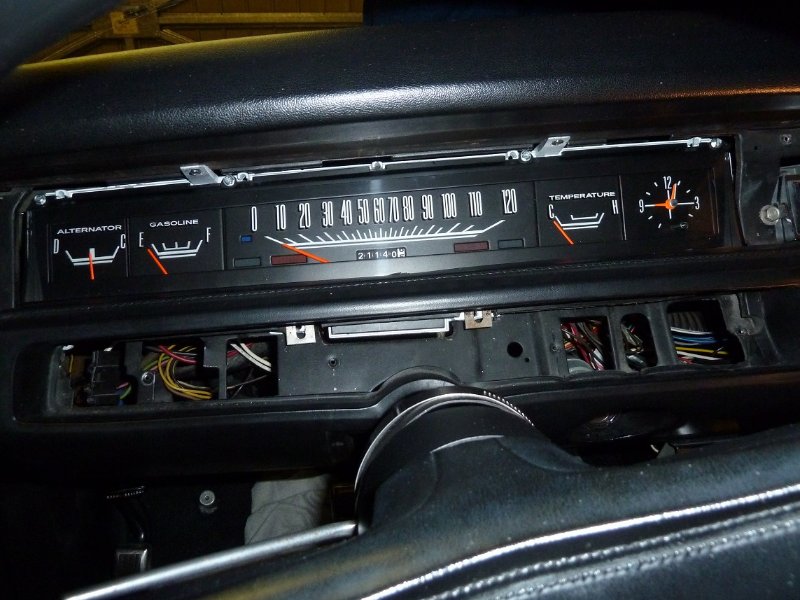

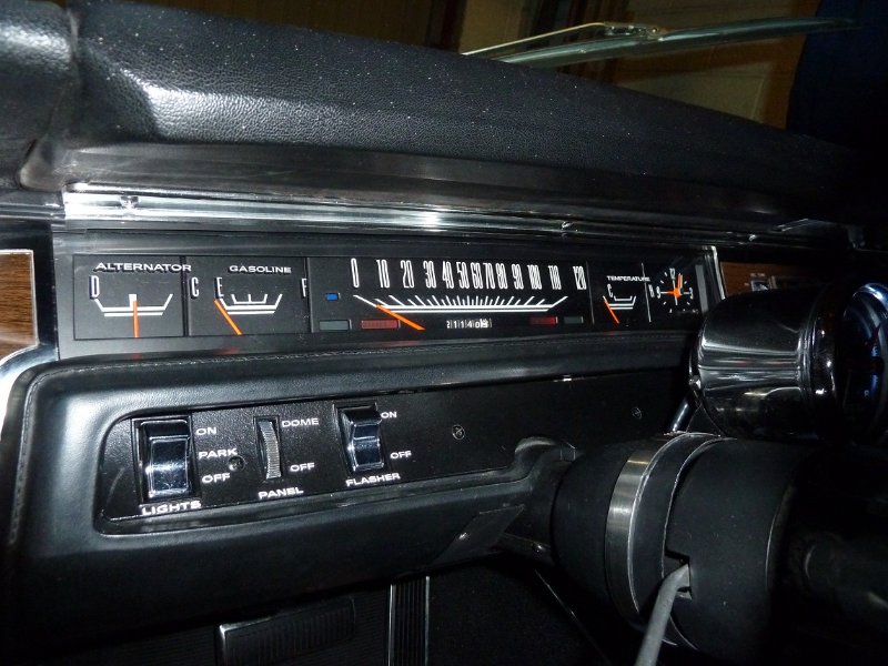

Minor update. (but quite a few words, sorry)

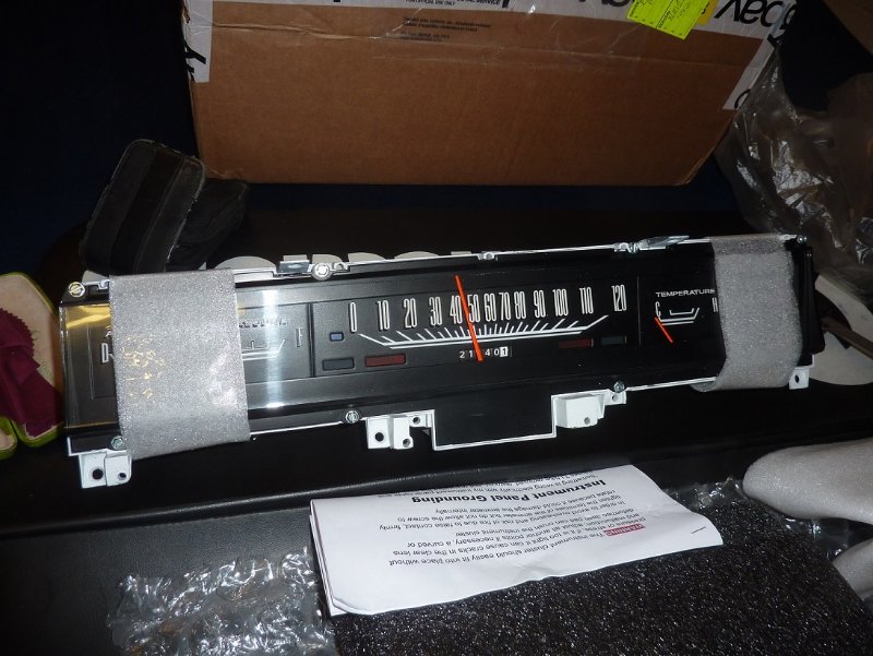

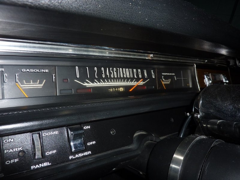

Something we should have done last winter is change out our speedo which went kaput after sitting idle while the new engine went in.
Seems like it 'lost it's magnetism' and the needle gradually moved from zero at rest. Even with cable disconnected it's now showing 130mph at rest.
So with an MOT due (yes I know it probably isn't really an issue) and the mileage still where it was before the last MOT we thought hey why not spend a couple of weekends lying under the dash to fit a new one.
Found a US seller on Ebay over a year ago now who offered restored instrument clusters for either Satellite / RR's (120mph) or GTX's (150mph).
Seems that our Stellite had a 150mph speedo fitted by the previous owner which probably replaced a kph speedo? Or maybe the old one just broke.
Either way it lasted us 35 years so can't complain.
150 is kind cool but 120 is correct so that's what we went for.
Trouble is, when the new cluster arrived the speedo was showing 50. Credit to the seller he sent a new speedo (just the speedo section), but that arrived with the needle bent. ho hum.

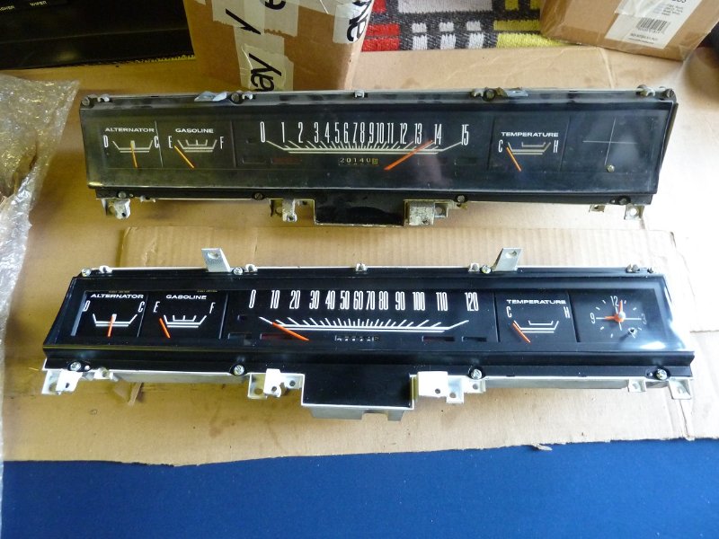

So I took the 2 'new' speedos to a very helpful guy just the other side of Gloucester who checked them over, calibrated them and set to zero.
https://www.magnetic-speedometer-repair.com/
Oh yes and we thought we'd fit a clock that we got years ago. Not hooked up but better than a black square.

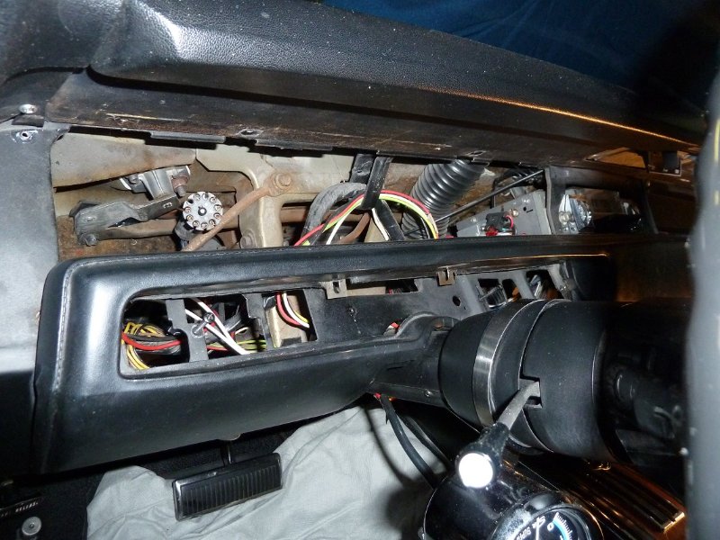

So a couple of weeks ago I started dismantling stuff. Had a look at some threads on FBBO which were quite helpful, and rob came round to help.
It probably would have been easier without the steering column in but didn't fancy going to that extent.
Photos below show a 'before' with the needle at 130
, then the 'new' speedo with it at 50
. And then a few of 'during' and 'after'

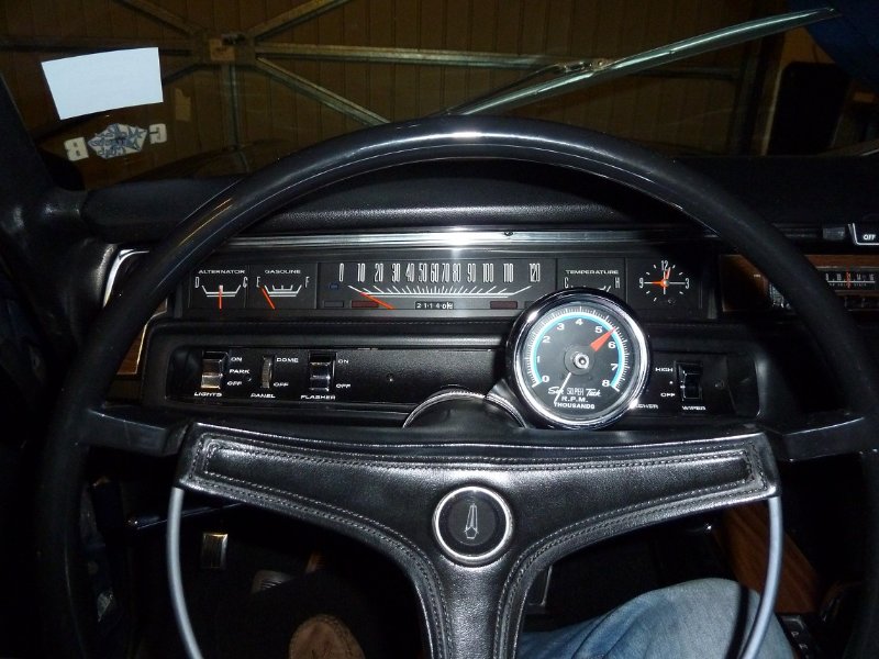

With the new cluster in place and everything else back in we turned the key. Couple of things didn't work:
Dome wasn't coming on with the dimmer, Brake (E brake) indicator wasn't working, and the indicator / hazard wasn't flashing.
Turns out the dome / dimmer was because I hadn't replaced the 4 screws retaining the black switch panel (earth). Brake indicator was just a dodgy bulb / fitting which I took out of the old cluster. Flasher / indicators would flash with the engine running so i'll take that for now.
I wonder if it just needs a new flasher unit? We found that Andy (Mustangbooks) has them on ebay so might order a new one.
Do these need to be earthed? or squeezed into it's spring steel housing somewhere up under the dash?
If anyone is thinking of changing their 68/69 RR etc speedo, here's a list of what we removed to make access easier:
Driver seat, drop column, ashtray, full width ally trim above cluster / under dash, trim piece to left of cluster, switch panel, loosen Pal nuts that retain the lower dash pad, Vent pull levers under dash.
All this is more suited to a teenager with very small hands rather than a couple of 60 year olds who need glasses to see under the dash.
Anyway here's some pics:

- Before
- P1250457.JPG (103.85 KiB) Viewed 14405 times

- new (repaired) vs old

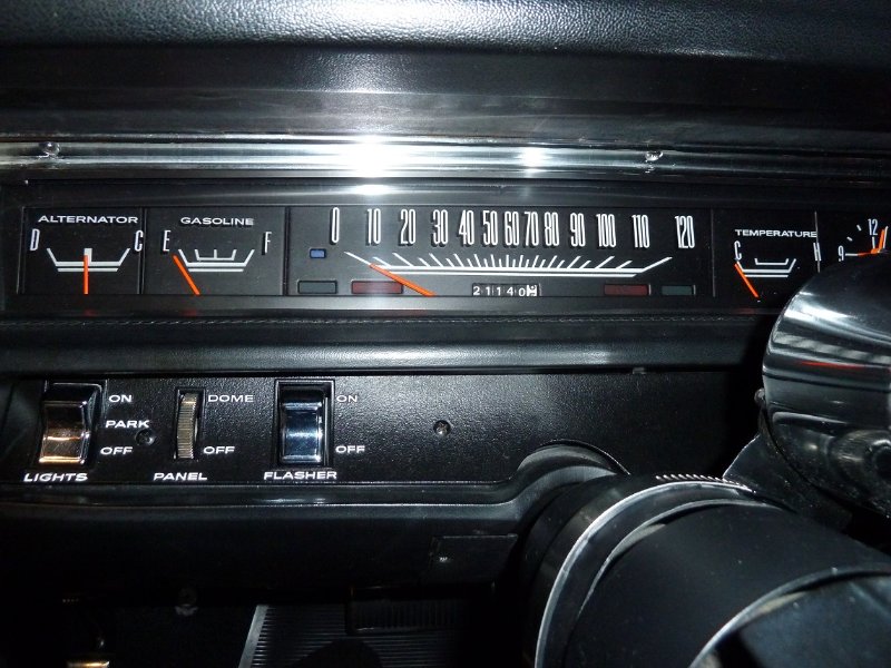

- Done !
- P1100154.JPG (110.31 KiB) Viewed 14405 times
- P1100155.JPG (110.77 KiB) Viewed 14405 times
- P1100159.JPG (115.41 KiB) Viewed 14405 times

Looks great, but yes I know the pain of working under the dash, done it 2 times on my Barracuda and it is a killer.
Nice to know there is Dr near for the instruments repairs.
Good job guys

Yes, working under the dash seems to get harder and harder as time goes by. I particularly enjoy the “upside down with feet over the back of the seat” position, when I always lie there wishing I had been bothered to take the seat out after all.
Looking like a good job done.
Wity all the speed and average speed cameras around these days, definitely better to be sure.

Like your new avatar Stu1Stu wrote: Wed Oct 19, 22 7:17 am Yes, working under the dash seems to get harder and harder as time goes by. I particularly enjoy the “upside down with feet over the back of the seat” position, when I always lie there wishing I had been bothered to take the seat out after all.![]()
Looking like a good job done.Wity all the speed and average speed cameras around these days, definitely better to be sure.
We've been relying on a piece of paper resting on the dash with rpm / mph listed so we can stay legal near speed cameras so it'll be nice to get back to having a real speedo

Cheers Rob, figured it was time I moved on from the Barracuda avatar as it hasn’t turned a wheel for so long.RobTwin wrote: Wed Oct 19, 22 7:54 am Like your new avatar Stu1![]()
We've been relying on a piece of paper resting on the dash with rpm / mph listed so we can stay legal near speed cameras so it'll be nice to get back to having a real speedo![]()
Yes, I used to have memorised equivalent speeds too, I reckon at least half the forum must have speedos out.
I downloaded a speed app on my phone in the end, just in case, but once I get into the winter projects, I reckon I might have to take inspiration from this!

I always remove the column and take the seat out these days when working under the dash. Seems like a lot of effort but it really isn't, just makes life so much easier.

When i spoke to the 'speedo guy' (his job, not what he wears LOL) he really bad-mouthed the build quality of speedos used in american cars, saying he'd have a look but couldn't guarantee anything as it's 50 year old plastic blah blah.
But i really wanted someone to give them the once over so he agreed but said he couldn't look at them for a few weeks and I'd likely have to collect them from him next month at the NEC. But luckily the box they were in was so big, it was all in his way so he phoned me back the next day to say they're fixed! 2.5 hours labour, all sorted.
He's exhibiting at the NEC Classic Car show so check him out. Dr Mike Flannery.
