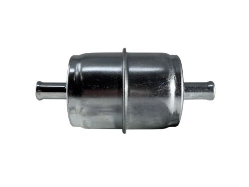

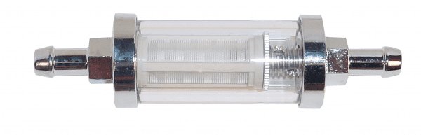

We're planning on (re)fitting an in line electric pump upstream of our mechanical pump, and was wondering whether either of these types were recommended:
The metal cannister type which we already use or the glass type which we used donkeys years ago?
Not sure if either would be called 'premium' when it comes to high flow, we just want something upstream of the new pump that filters and doesn't restrict flow.
I know some say glass is a no-no.
Failing that what do others use? It'll be tucked up under the rear wheel arch so originality not an issue.

The glass ones like that are generally poor quality and I don't like them
THe metal canister type are good but you can't see inside or service them.

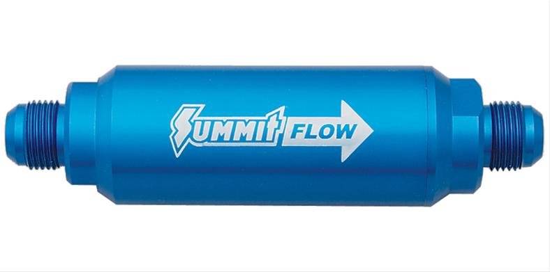

I like the ones like this . Available with paper or metal filter elements, not expensive, and fully serviceable. You could use one with -6 connections and adapt to hose barbs quite easily.
sum-230116_xl (1).jpg (22.57 KiB) Viewed 758 times

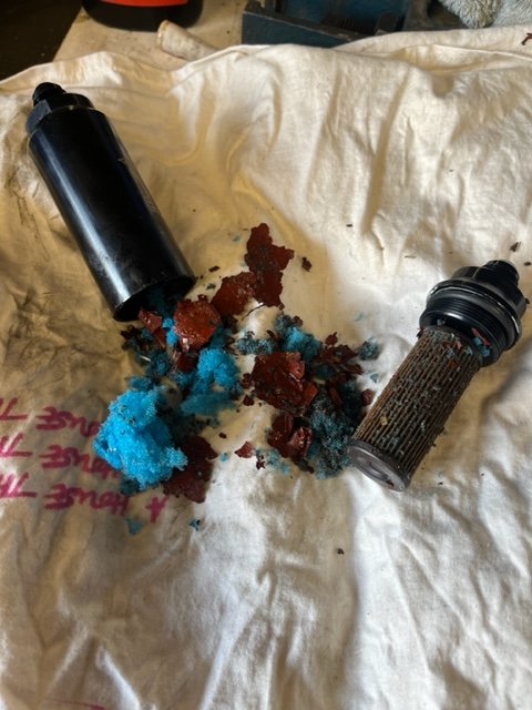

I have one in the Cuda and it caught all this without complaint. I only opened it out of curiosity . Cleaned it out and good as new.
THe blue stuff is foam from the fuel tank, the red stuff is jerrycan lining . I now have a mesh filter in my fuel funnel...

I would not dream of using a Glass filter....
Re: Fuel filter?
I use the metal ones and change it as a matter of course on a service. Glass style is asking for trouble IMO. Matt’s one look like a good investment also.

Thanks guys yes I agree glass probably not the best where dirt gets kicked up. Metal canister should be ok as the tank is new and cheap enough to change regularly. Or as an equivalent to the ally one, Demon Tweeks do one with a changeable filter, -8 size is about £40 but I’d need hose ends as well.... https://www.googleadservices.com/pagead ... QWA&adurl=
