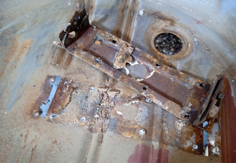

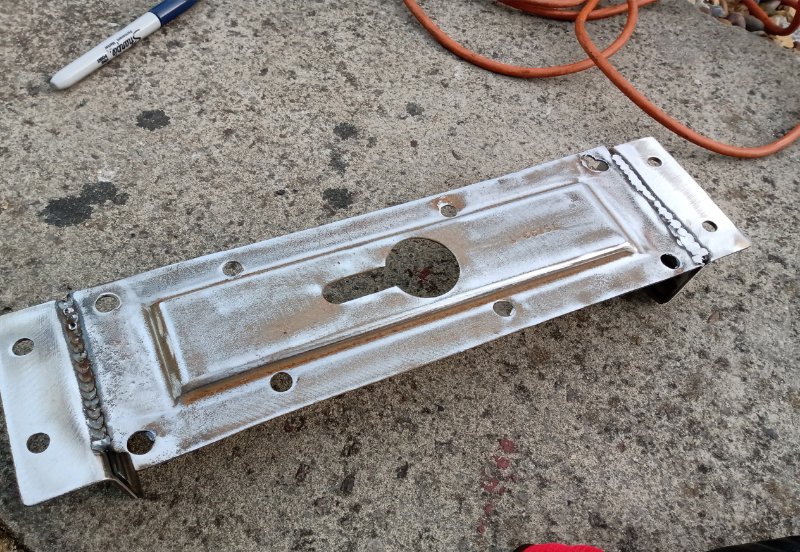

Tank strap bracket angles repaired

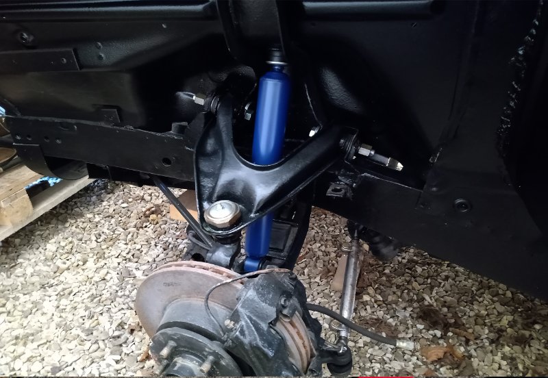

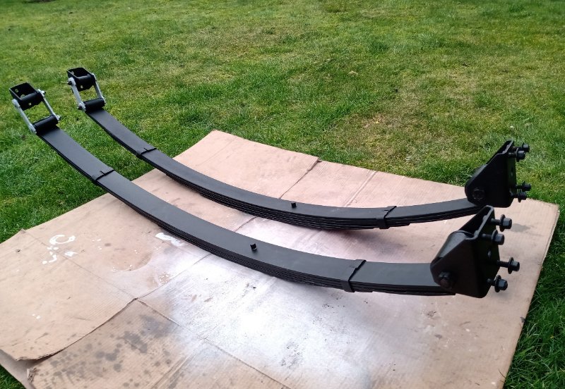

Front suspension loosely assembled with new bushes, shocks, ball joints etc
Leaf springs reassembled with new bushes & shackles

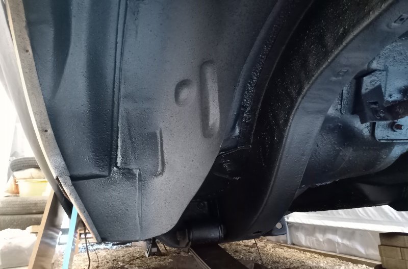

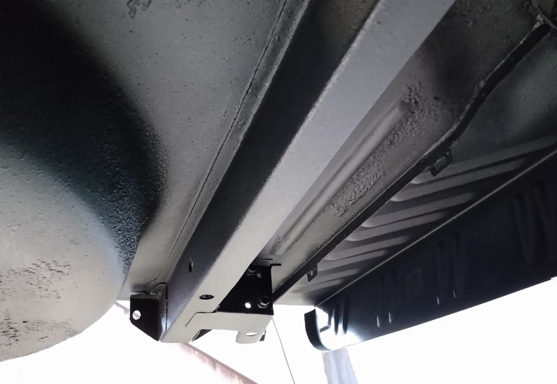

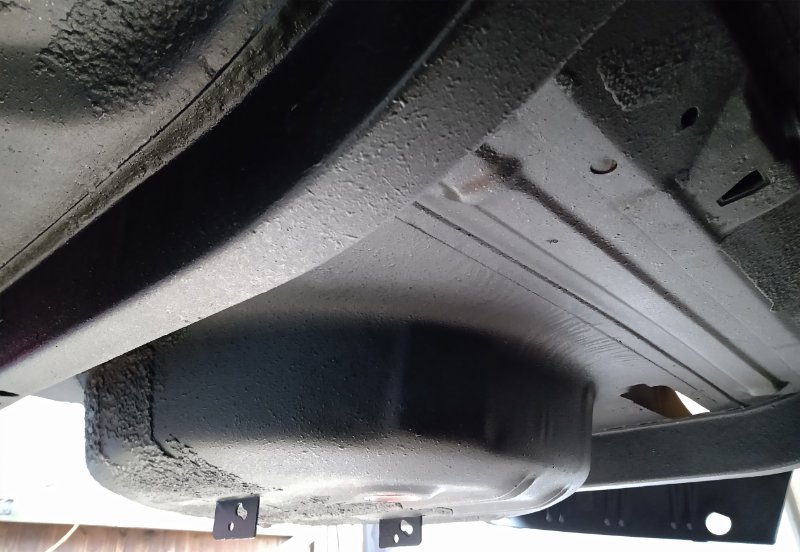

N/S boot floor dropoff - pretty crusty!
New drop-off fitted & localised repairs
All now given a coat of protective black..

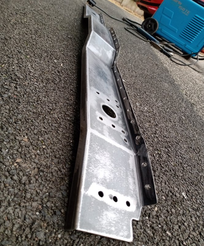

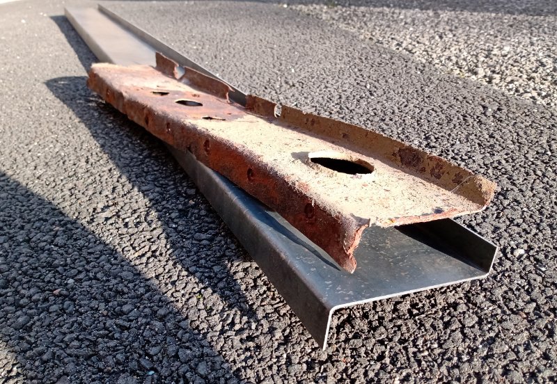

Z Section for rear crossmember

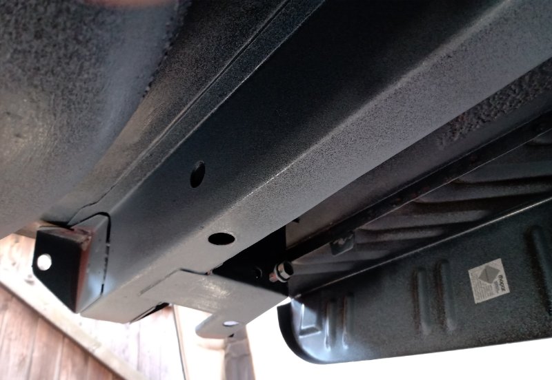

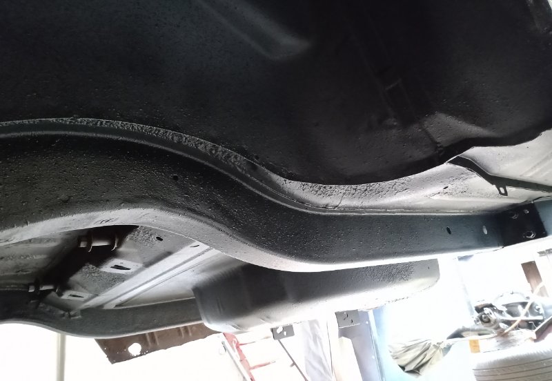

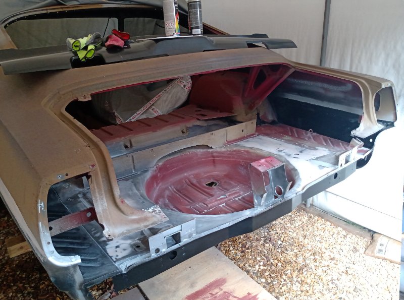

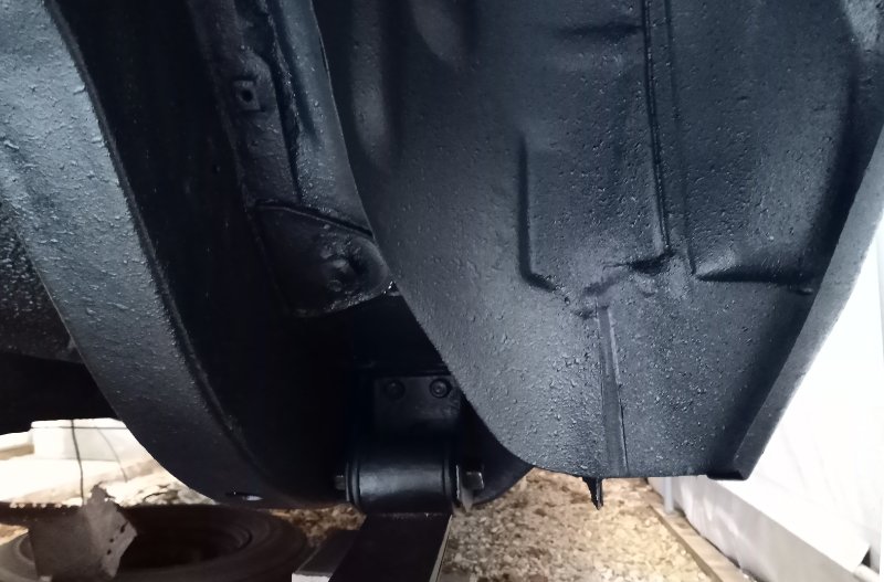

Rear crossmember finished off & welded into place over the weekend. Also a few pics of the finished lower portions of the wheel tubs which were cut out & replaced a while ago..
REAR CROSSMEMBER.jpg (216.99 KiB) Viewed 12911 times
CROSSMEMBER IN SITU.jpg (139.67 KiB) Viewed 12911 times
NS WHEEL TUB.jpg (96.75 KiB) Viewed 12911 times
OS WHEEL TUB.jpg (89.52 KiB) Viewed 12911 times

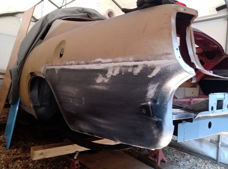

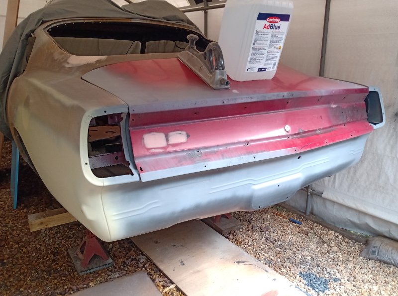

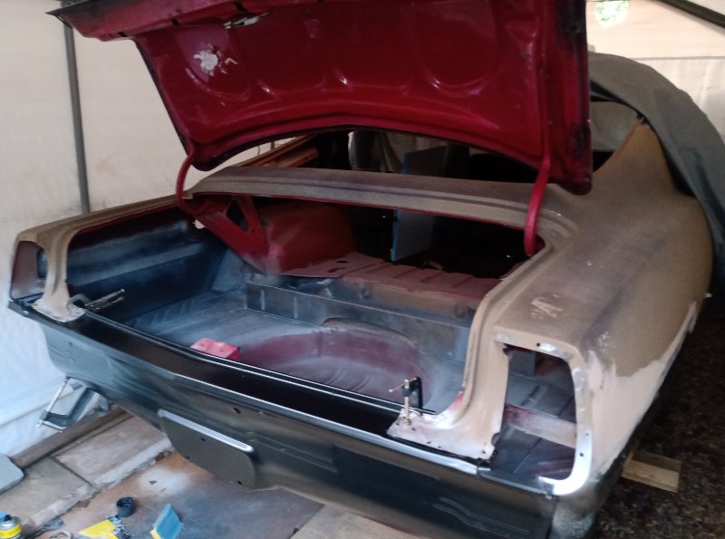

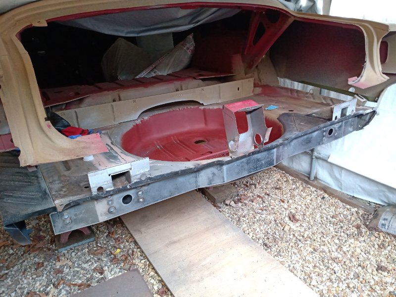

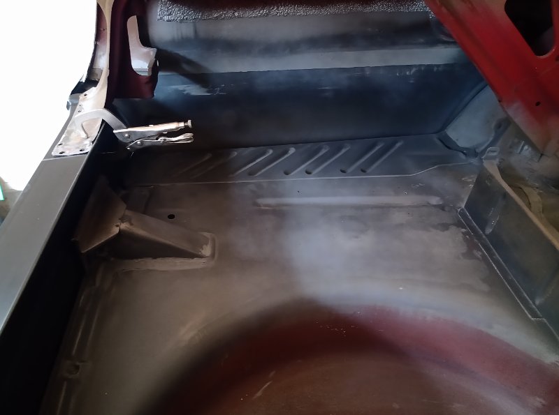

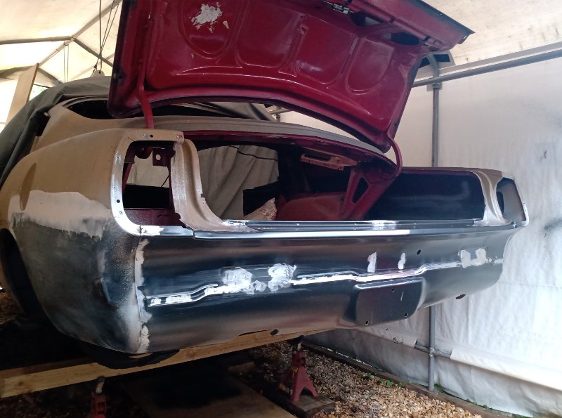

I've been chipping away at the rear end over the past 6 months, and (albeit slowly) things are now coming together nicely.
It's a bit of a struggle in my "tent" & time has been limited, but it's getting there.
With the dropoffs, boot floor & rear crossmember finished I've been on with the lower 3/4 sections & new rear panel. All AMD panels which I was really impressed with the fit & finish of. This has been a more rewarding stage as the rear end has finally come together & it looks something like a car again!
I can actually see a result of my time spent.
Various pics of this stage as follows:

Re: RHD '68 BARRACUDA RESTORATION
Good progress! Unfortunately AMD have now discontinued the lower rear quarter patch panels as I found out when I tried to order a pair for my RHD project. Had to replace all those panels on my LHD car due to rust and damage, and I was impressed by the panel fit as well.
