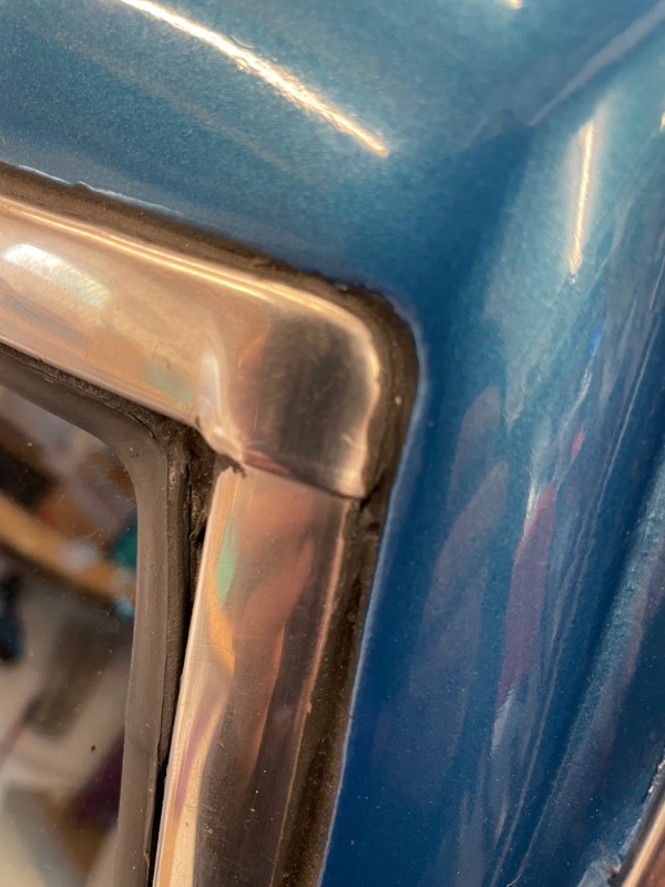

You can make a real neat job of it.

Neat job.
Do you use water or a solvent to wipe it off? or just lick your finger?
I used masking tape mainly because i thought the vinyl roof would make it difficult to get a clean edge.
Re: Rob & Stu's 69 Sport Satellite
Just paper towel to get it off and to smooth it. Because it’s non setting you can go back to it anytime if you notice a bit you’ve missed.

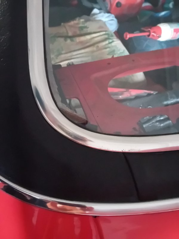

Here is my Freehand effort at sealing the Vinyl roof to the trim, the trim to the Glass, etc, etc....
I have found the 'Cuda window shape inherently more difficult than the "B" body arrangement (such as my Super Bee) as the curvature and the generally poor fit of the trims have proved challenging.
..and finally the 'Cuda is water-tight!
This sealant does not remain flexible and does cure, so you have to work quickly.
We shall see how this holds up in the longer term.

Well that looks good from here, Pete
Do you think that seam in the vinyl could be a place where water's getting through? It's only a short length but like our rear lights, it doesn't take much
Actually Rob it was leaking everywhere, the previous owner(s) did not do a correct job; so I had to dig all the old stuff out and start again....
