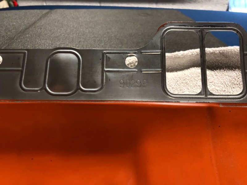

Looking to replace the ‘bathtub’ tin gasket on our 440. Having removed the one that was fitted, I feel we should refit a new one despite the one removed looking quite serviceable.
Trouble is the part number stamped on ours doesn’t show up on the Fel-pro website.
Number on ours is 90299. And has the heat crossover blocked off. When I search for Fel pro 440 gasket I keep getting 96000. But this looks to have the holes for the crossover.
Anyone know the correct spec and a UK supplier for one with no holes?
Photo shows ours. (not sure why it’s upside down?)
Thanks, Stuart.

- D83DA9E2-799E-459A-9F16-89938AEF3017.jpeg (128.24 KiB) Viewed 4991 times

Don't worry, you can all stop looking now.
Found it. (with a little help)
If it helps anyone, the RB part with the heat crossovers blocked can be bought as a kit - Pn Fel-pro 1215. (comes with 4 separate fibre intake gaskets)
Whereas if you want one with the heat crossovers open, you can get the bathtub on it's own - Pn Fel-pro 96000.
