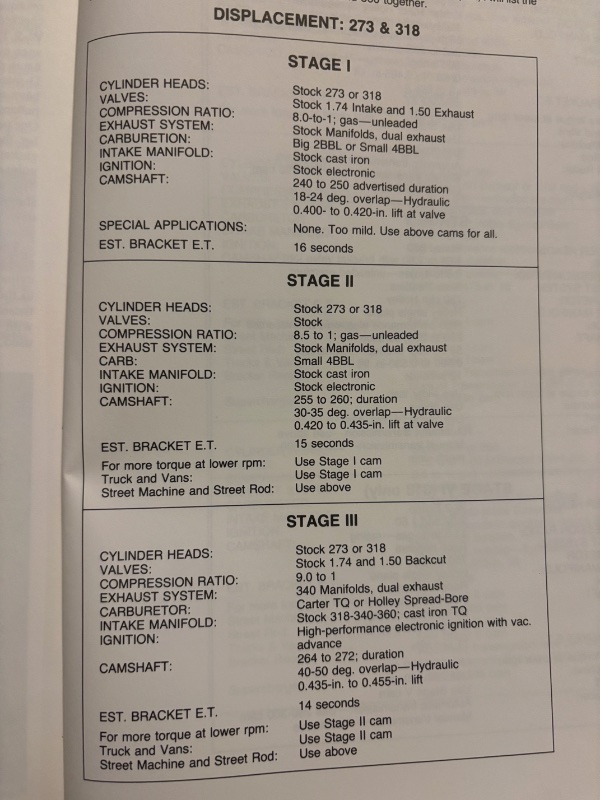

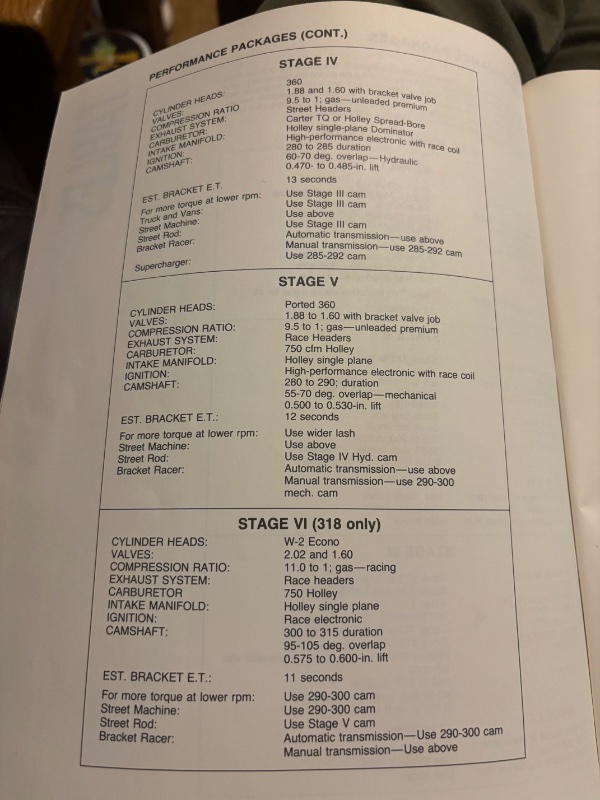

Posts: 7111
Re: 318 upgrade ?
Some pics from a recipe book I have, as food for thought. :D

Stu wrote: Sun Jan 26, 25 8:57 pm Some pics from a recipe book I have, as food for thought. :D
Thank you Stu Copied now :thumbright:
