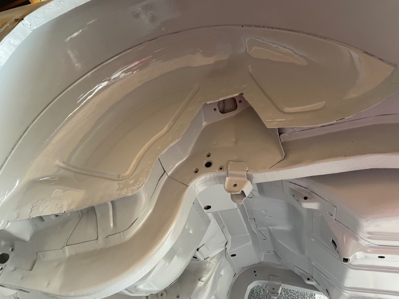

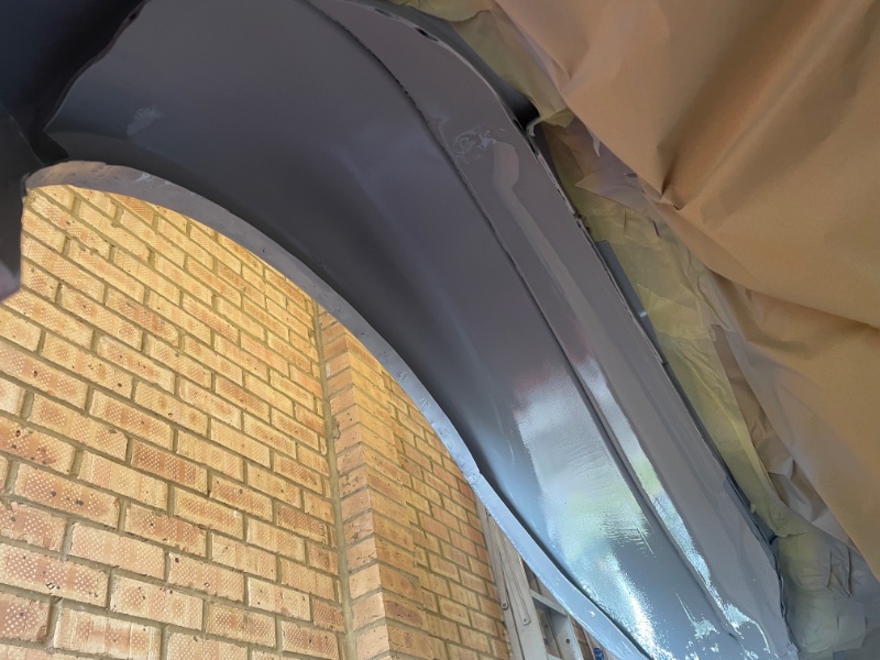

Finally finished the underside!
Left wheel house and rear drop off completed and in epoxy
Thank goodness!
12 weeks I’ve been under the Turd , losing the will to live!
Thank goodness!

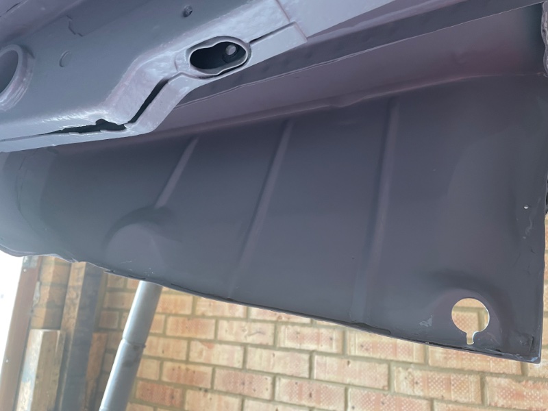

Re: My very last restoration!!!
Pics
- IMG_4796.jpeg (169.42 KiB) Viewed 4908 times
- IMG_4801.jpeg (118.72 KiB) Viewed 4908 times

I appreciate it’s a long time, but the results show it was worth it…newsatten wrote: Sat Jun 07, 25 6:14 pm 12 weeks I’ve been under the Turd , losing the will to live!
At least now you get to enjoy working topside for a while

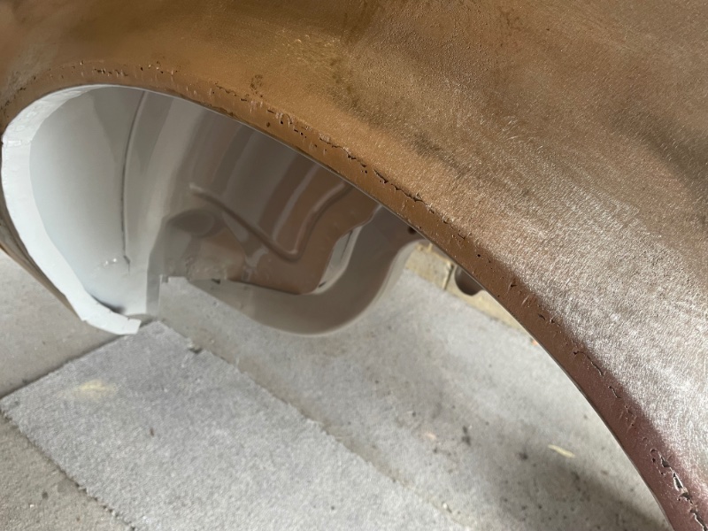

Decided to lip the arch , generally the quarters are solid and sound, however the was a few tiny pits and it’s virtually impossible to judge how far the corrosion has penetrated the steel, so belt and brace approach necessitated a new edge and arch lip,
This needs to be as filler free as possible so if the arch is scanned it will just show a paint/ primer thickness,
However polyester is part and parcel as far as body refinishing goes and some filler will always be required,
Appreciate the support!

There’s also another reason for doing my arches
As I’ll be able to either roll them or just cut them down which will give me a tad more flexibility with rear tyre width
Past experience has shown me tyres often clear when just two up and rub when carrying two in the back
So want to avoid this if possible!
