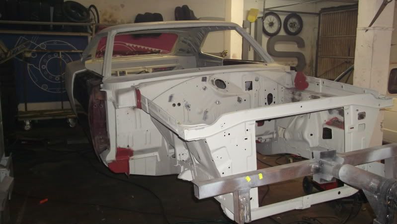

So back to the real world so the fun can start again

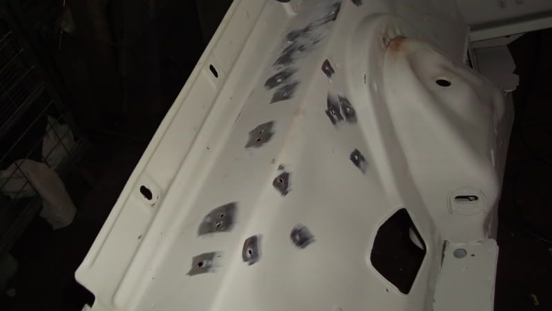

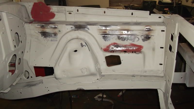

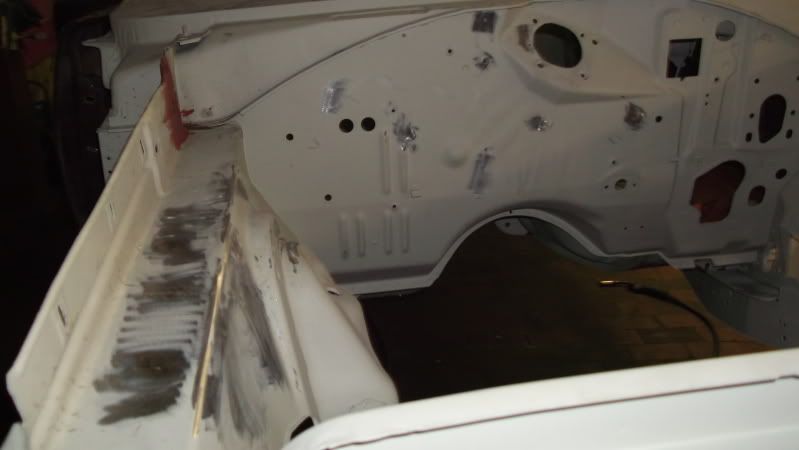

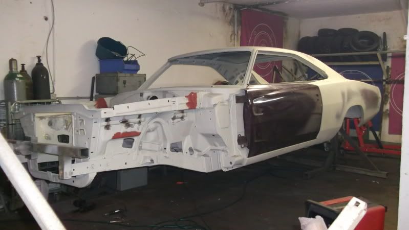

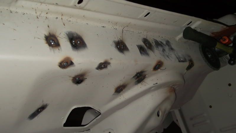

First i welded up all the holes in the engine bay area.
I know that some holes where drilled using the teeth of Chrysler corp unicorns but im going for a no cable no mess engine bay.
<a href="http://photobucket.com" target="_blank"><img src="http://i73.photobucket.com/albums/i205/ ... CF0008.jpg" border="0" alt="Photobucket"></a>
<a href="http://photobucket.com" target="_blank"><img src="http://i73.photobucket.com/albums/i205/ ... CF0014.jpg" border="0" alt="Photobucket"></a>
<a href="http://photobucket.com" target="_blank"><img src="http://i73.photobucket.com/albums/i205/ ... CF0024.jpg" border="0" alt="Photobucket"></a>
<a href="http://photobucket.com" target="_blank"><img src="http://i73.photobucket.com/albums/i205/ ... CF0023.jpg" border="0" alt="Photobucket"></a>

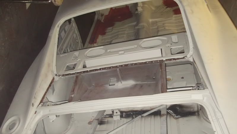

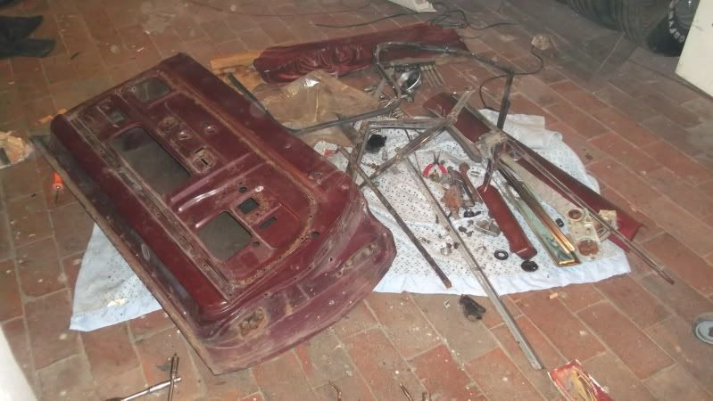

I then striped both door down
I hope you remember how that goes back together
<a href="http://photobucket.com" target="_blank"><img src="http://i73.photobucket.com/albums/i205/ ... CF0016.jpg" border="0" alt="Photobucket"></a>

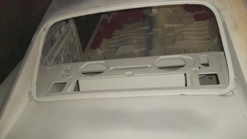

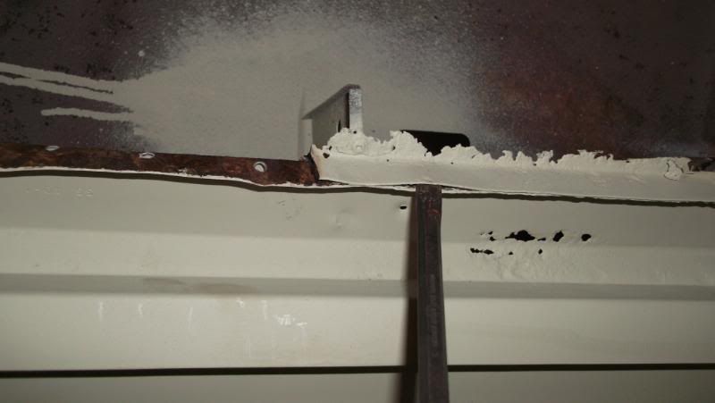

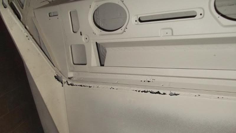

I was told buy the sand blasting company that the drivers rear wing where it meets the door handel area was not welded correctly (full with filler).
Was told this should be de welded and moved out and re welded.
I offered both door up and all seems well
<a href="http://photobucket.com" target="_blank"><img src="http://i73.photobucket.com/albums/i205/ ... CF0019.jpg" border="0" alt="Photobucket"></a>
<a href="http://photobucket.com" target="_blank"><img src="http://i73.photobucket.com/albums/i205/ ... CF0022.jpg" border="0" alt="Photobucket"></a>

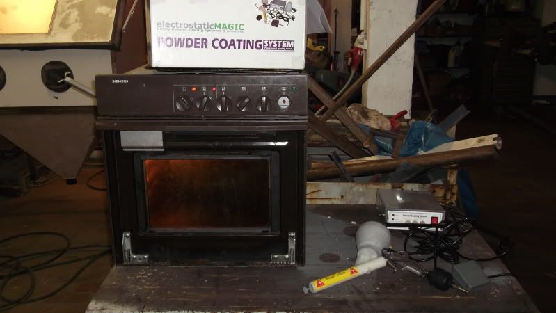

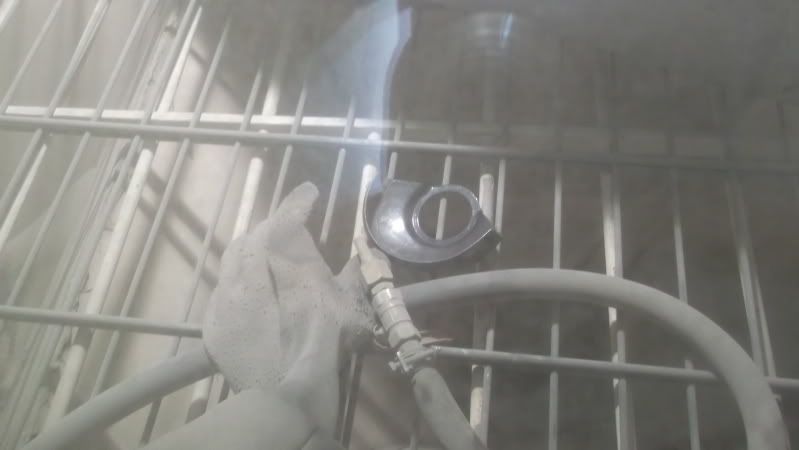

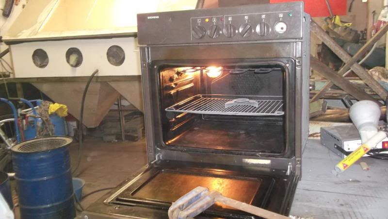

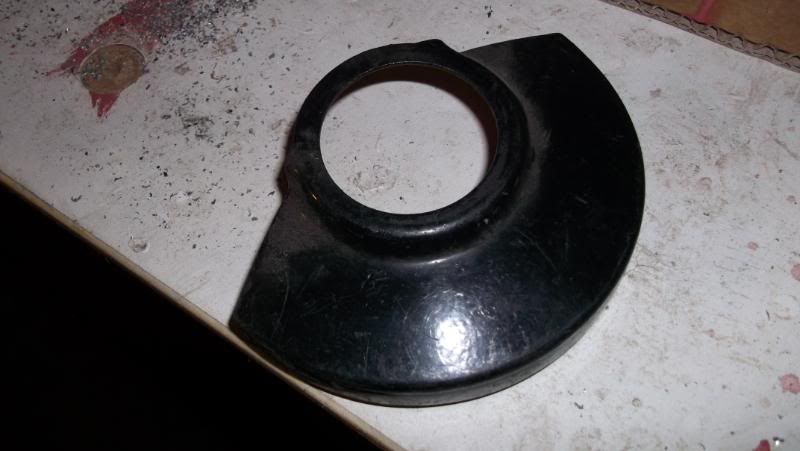

Powder coating

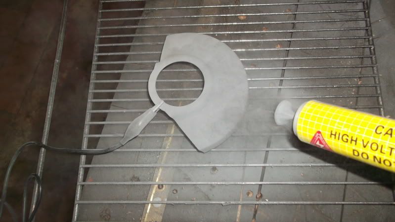

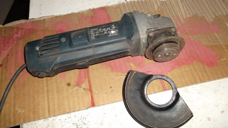

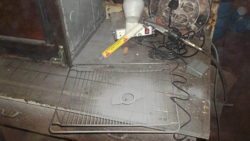

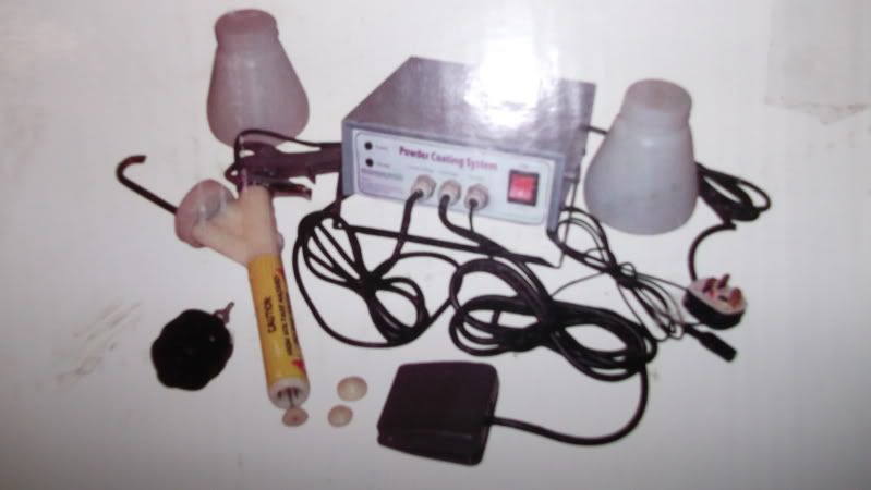

So i just brought DIY powder coating kit from http://www.electrostaticmagic.co.uk/
kit cost me 120 quid and i got a old normal house oven off ebay for 99p

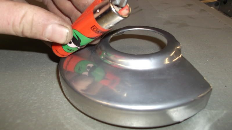

Im using the High Chrome powder. wont be using this for a while but had to take it for a test drive and im well impressed.

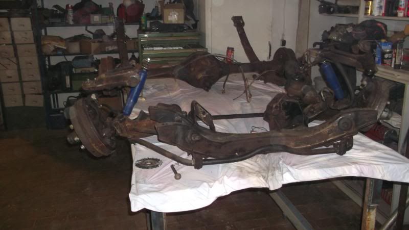

I intend to do my complete front and rear axle the same way.
I took the head off the angle grinder for a test.
2min in sandblaster
Connect the - to the metal and the powder is +
20 min in the oven at 200 Degrees
not bad for dirty oven
dirty hands and a dusty garage

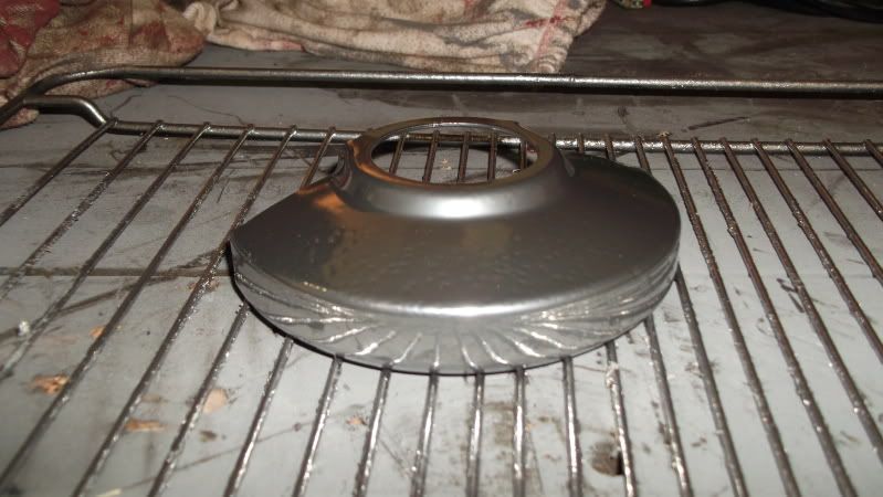

Have now attached the angel grinder head to the underside of my daily driver to test it on snowy salty roads
<a href="http://photobucket.com" target="_blank"><img src="http://i73.photobucket.com/albums/i205/ ... CF0025.jpg" border="0" alt="Photobucket"></a>
<a href="http://photobucket.com" target="_blank"><img src="http://i73.photobucket.com/albums/i205/ ... 0027-1.jpg" border="0" alt="Photobucket"></a>
<a href="http://photobucket.com" target="_blank"><img src="http://i73.photobucket.com/albums/i205/ ... CF0030.jpg" border="0" alt="Photobucket"></a>
<a href="http://photobucket.com" target="_blank"><img src="http://i73.photobucket.com/albums/i205/ ... CF0031.jpg" border="0" alt="Photobucket"></a>
<a href="http://photobucket.com" target="_blank"><img src="http://i73.photobucket.com/albums/i205/ ... CF0034.jpg" border="0" alt="Photobucket"></a>
<a href="http://photobucket.com" target="_blank"><img src="http://i73.photobucket.com/albums/i205/ ... CF0037.jpg" border="0" alt="Photobucket"></a>
<a href="http://photobucket.com" target="_blank"><img src="http://i73.photobucket.com/albums/i205/ ... CF0038.jpg" border="0" alt="Photobucket"></a>
<a href="http://photobucket.com" target="_blank"><img src="http://i73.photobucket.com/albums/i205/ ... 0039-1.jpg" border="0" alt="Photobucket"></a>
I applied the first coat to thick and it pitted went straight over with another coat and back in the oven
<a href="http://photobucket.com" target="_blank"><img src="http://i73.photobucket.com/albums/i205/ ... CF0040.jpg" border="0" alt="Photobucket"></a>
<a href="http://photobucket.com" target="_blank"><img src="http://i73.photobucket.com/albums/i205/ ... CF0058.jpg" border="0" alt="Photobucket"></a><a href="http://photobucket.com" target="_blank"><img src="http://i73.photobucket.com/albums/i205/ ... CF0059.jpg" border="0" alt="Photobucket"></a>
Im going to need a bigger oven
<a href="http://photobucket.com" target="_blank"><img src="http://i73.photobucket.com/albums/i205/ ... CF0047.jpg" border="0" alt="Photobucket"></a>
<a href="http://photobucket.com" target="_blank"><img src="http://i73.photobucket.com/albums/i205/ ... CF0046.jpg" border="0" alt="Photobucket"></a>
2min in sandblaster

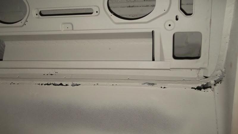

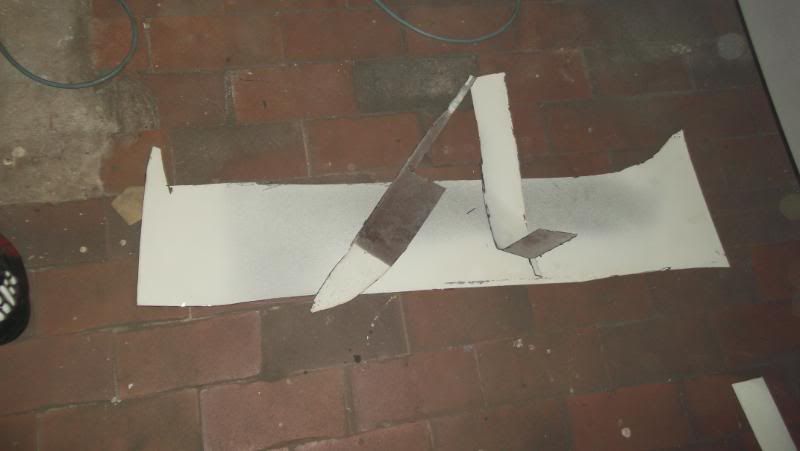

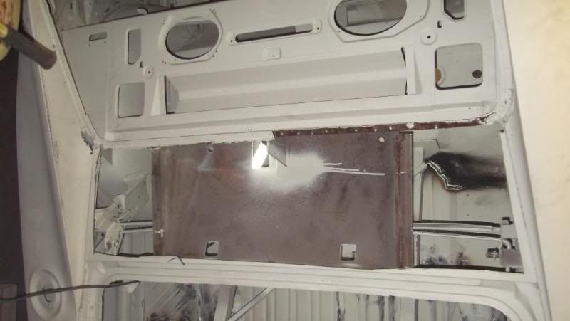

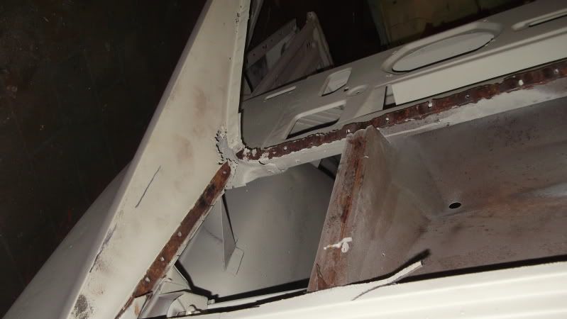

Next looks like the charger favorite the rear sail panel.
Thanks to Jules i have some great photos to go by.
Started slowly cutting it out the rest tonight
<a href="http://photobucket.com" target="_blank"><img src="http://i73.photobucket.com/albums/i205/ ... CF0049.jpg" border="0" alt="Photobucket"></a>
<a href="http://photobucket.com" target="_blank"><img src="http://i73.photobucket.com/albums/i205/ ... CF0050.jpg" border="0" alt="Photobucket"></a><a href="http://photobucket.com" target="_blank"><img src="http://i73.photobucket.com/albums/i205/ ... CF0051.jpg" border="0" alt="Photobucket"></a><a href="http://photobucket.com" target="_blank"><img src="http://i73.photobucket.com/albums/i205/ ... CF0052.jpg" border="0" alt="Photobucket"></a><a href="http://photobucket.com" target="_blank"><img src="http://i73.photobucket.com/albums/i205/ ... CF0053.jpg" border="0" alt="Photobucket"></a><a href="http://photobucket.com" target="_blank"><img src="http://i73.photobucket.com/albums/i205/ ... CF0054.jpg" border="0" alt="Photobucket"></a>
