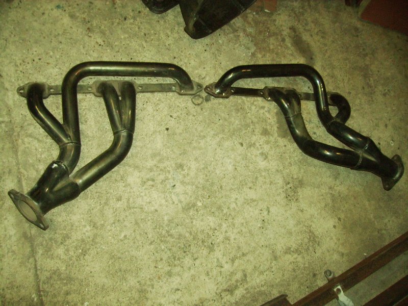

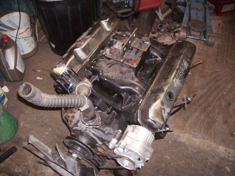

today was a good day for me. dawn called to tell me the schumacker tri y headers i bought from dave billadeau had arrived and i collected the engine and box too

i'm making a start on pulling the engine and box today. i'll get the engine out first so i can slide the box out without removing the trans crossmember. that way i won't need to slacken the torsion bars off (not my first mopar rodeo ;) ).
updates later.

mygasser wrote: Fri Aug 17, 18 10:02 am i'm making a start on pulling the engine and box today. i'll get the engine out first so i can slide the box out without removing the trans crossmember. that way i won't need to slacken the torsion bars off (not my first mopar rodeo ;) ).
updates later.

yes mate it was a new yorker i was breaking. don't i need to worry with this a body then? i've just been extra careful since.
Re: 68 valiant signet 2 door
No the torsion bar crossmember is welded to the floor, the centre of it is bolt in so you can get the trans out. Personally I find it easier to remove/ refit the engine & trans separately anyway.

thanks blue, good to know mate. i've always been one to err on the side of caution 8-[
