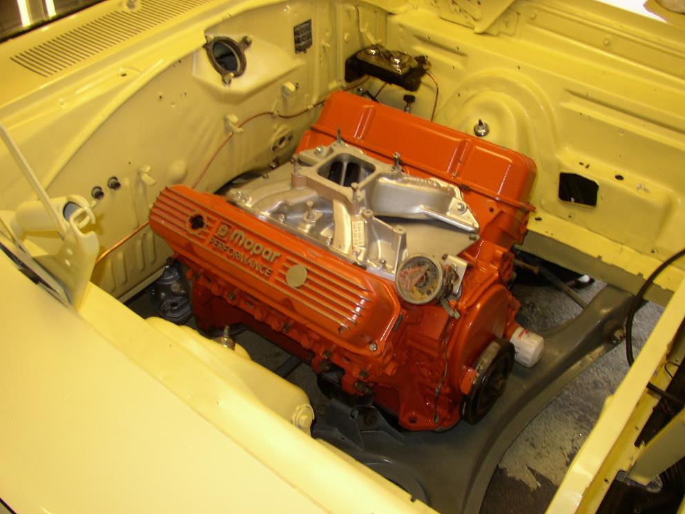

hi stall converter went in and new gearbox and engine mountings, after a few hours of struggling a rang kiwi to find out how to fit the headman headers he sold me, they fitted fine once i removed the left hand mounting through bolt and jacked the engine up.took them back off to spray them. fitted a high torque mini starter(also from kiwi) and cranked the engine i have good compression on all cylinders looking good.i will remote wire the starter to a cotten reel block on the n/s inner wing if i have to remove the starter it will be easier not having to remove the wiring from the soleniod.

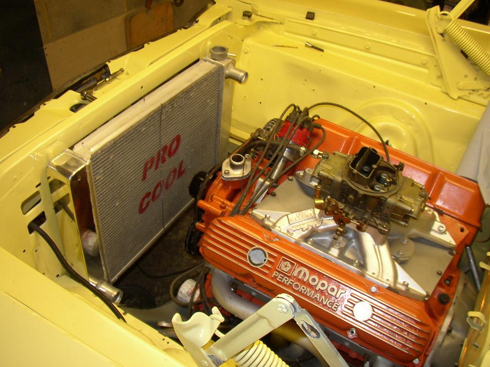

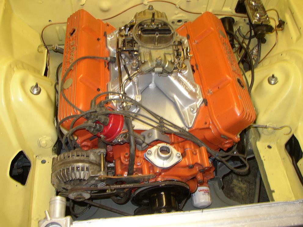

Nick Eagle 68 Roadrunner
after refitting the painted headman headers the water pump and pulleys were refitted, alternator bolted in and alined. i dont have the right power steering brackets to low sling the power steering pump so will have order a bracket set. dizzy went in plugs and leads to run the engine i have a set of moroso leads to fit later.fuel pump and fuel line connected to the tank.
750 double pumper off my chevy fitted and new pro flow radiator fitted nicley.
thanks for the great comments, sorted the power steering bracket today looked at the lower slung brackets on ebay and have modified the one i had. also have sorted the right saddles for the propshaft i have a ally propshaft with a balance/damper on it so i couldn't use the billet u/j saddles i had.also fitted new u j joints.
