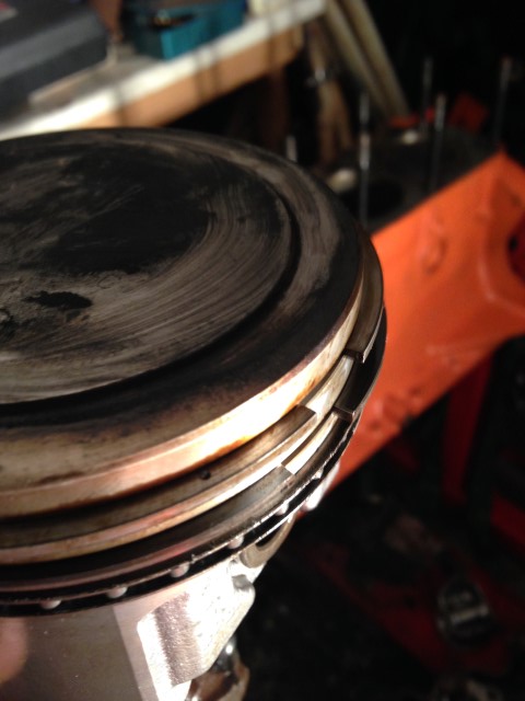

some engine progress
Pulled it out last weekend
got round to taking off head sump and 1 rod n piston out last night
rings look like new
no ring land damage
piston coating slightly worn
top ring is shiny ring, dot faces up
middle ring is dull cast ring taper to inner bore faces down
oil scraper ring is fully expanded correctly butted and non of the ring gaps were aligned with each other

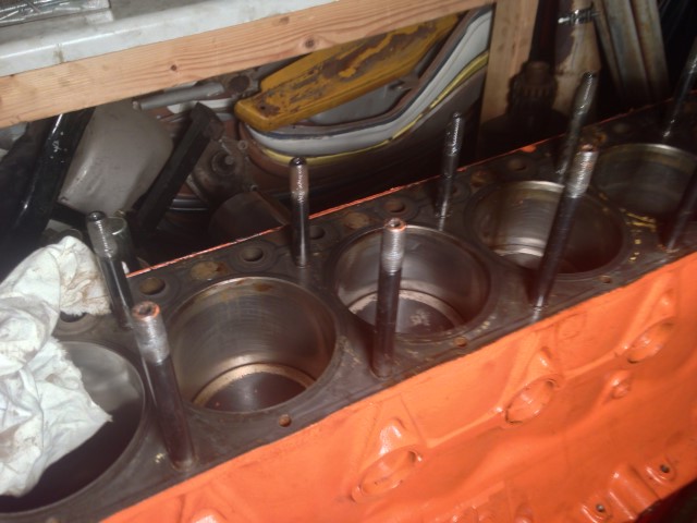

there is cross hatch on the bore...might be too little but still visible
can only assume at this point
1) bore wash
2) too slippy oil or oil standing up on baffle and getting whisked up onto walls in excessive amount
what do you think
i have missed something
my garage is a home to mr cockup on a regular basis but i can't see whats missing here
top ring looks untouched
second ring has slight ware (shiny) but uneven...more towrds ring gap than oposite side
other things to note
light circle scored into tha face of one lifter
slight scuffing to big end bearings near the joins i guess they never get near the journal at the split
head looks good
uniformly carbon covered around all vlaves if i had a leak i'd expect it to be a bit scorched with some kind of marking where the hot gasses whistled out.
do i invest in a dingo bollock hone
if i do that do i stick with part worn in rings or go for new

- IMG_0982 (Small).JPG (65.36 KiB) Viewed 1905 times
- IMG_0977 (Small).JPG (89.48 KiB) Viewed 1905 times
- IMG_0969 (Small).JPG (40.6 KiB) Viewed 1905 times
- IMG_0961 (Small).JPG (78.94 KiB) Viewed 1905 times
I guess you put Moly rings in Dave? Hence mentioning a 400 grit hone, 180 is far to course for Moly rings. I would stick a set of total seal cast iron rings in, no need to re-hone, chances are the rough surface has rubbed the moly coating off so you will need new rings anyway.

i'll dig the rest out and see whats what
yeah 180 would be too rough according to the sppedpro/sealed power info
but the top rings once the oil is cleaned off look like they haven't been used...this is odd
if i can avoid taking it all to bits that would be great

OK
pulled it to bits
honed it
crank in
rings gapped
rings installed
pistons in
head gasket sperated out cleaned and glued back together with a thin coat of hylomar
but 1 thing i did note was the thermostat fitted was 160F
i still have the box, said 185 on the box.....i should have checked it. ebay purchase
so i guess running cold would not have helped matters either, activly making any bore wash scenario worse

OK quick update Engine was pulled down
bores were smooth
bores honed for moly rings 400 grit flex hone
new rings
back togther
new stat
rubber main seal off a poly engine, the rope was working fine but was never happy that i'd done it right
painted it red this time not Wrong US hemi orange but daft aussie hemi orange which is red kind of but not orange
got it in 4 weeks ago
runs great

bores were smooth
