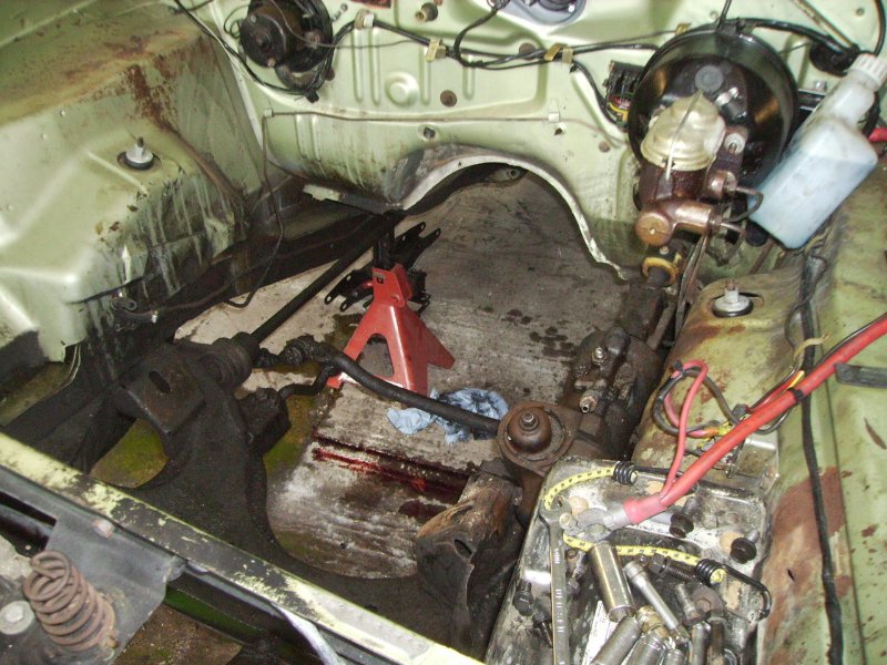

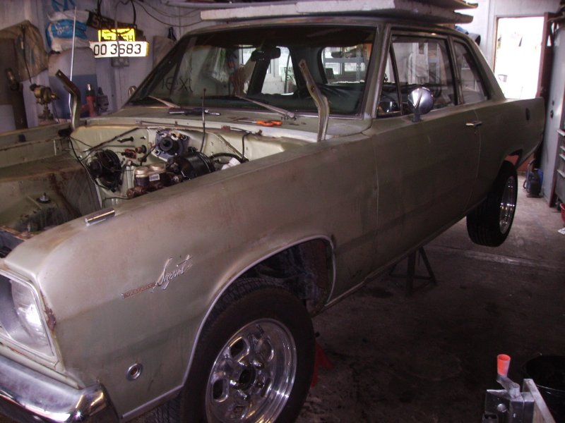

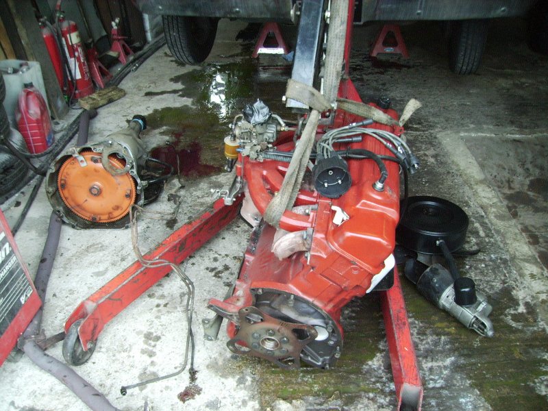

with those jobs done we removed the engine and box from the valiant as it's being collected in the week. that all went well with no problems so i can start the mock up of the 383 next weekend.

the s/six and box are being collected wednesday evening so i can clear up all the anti freeze and trans fluid in the garage #-o
then i've decided to mock up the 383/727 (make mounts etc) before i pull them apart for a freshen up, i'm not fitting the torque convertor either for this. reason is if i fit it all in i KNOW i'll just get it going and use it as is. i want to paint the engine bay and the engine/box so this way i have to take them back out and they'll get what they need before the final fit up.
