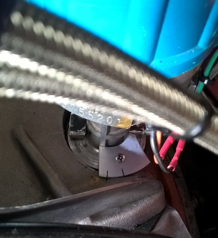

The timing is quite different- I made this marker plate to help line up the dissy, the right-hand mark is for the Mallory and the left one for the MSD.

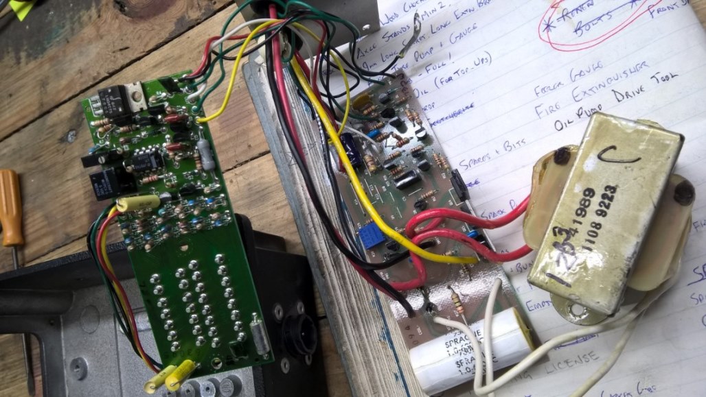

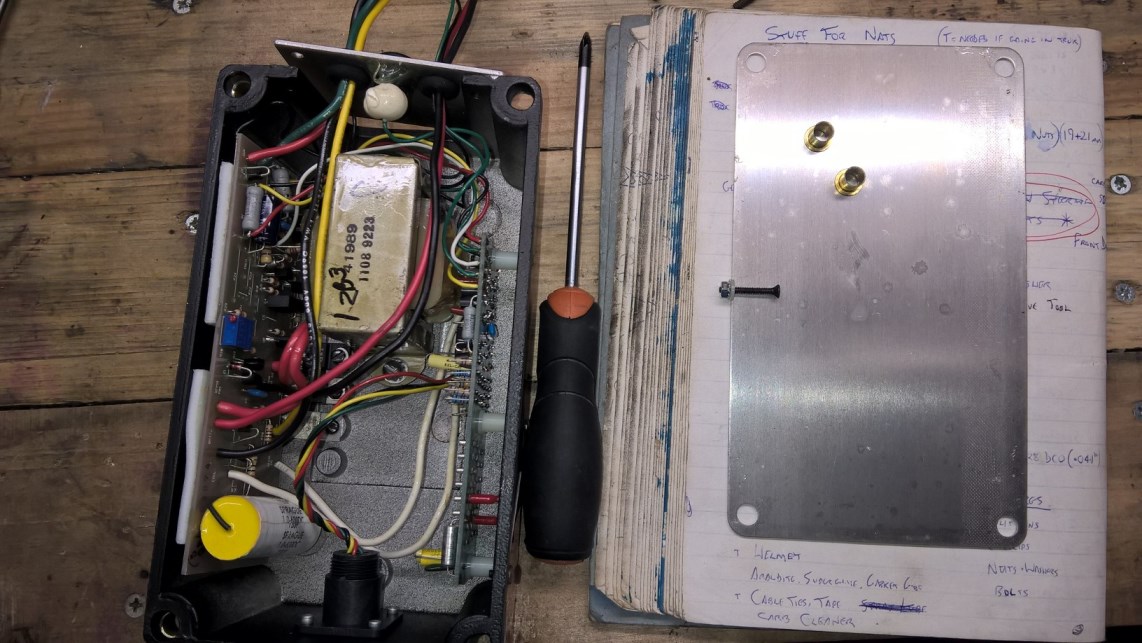

With Dave999's advice, I opened up the faulty box.
There's nothing obviously burnt, broken or swollen, so I got my meter out and started measuring. One of the first things I checked was the transformer and the primary side (red wires) measures 0 ohms- definitely not right!
So thanks Dave, I have a chance of fixing it now, I just need to find somewhere to buy a matching replacement transformer, or maybe get it rewound?
I've got the Mallory retard wiring worked out now (luckily they write what each wire does on the circuit board- shame you have to open the units up to find out!)

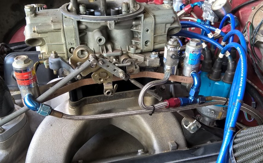

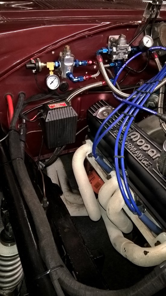

I had a spare nitrous solenoid so I've plumbed that in as a purge. I've stripped out a bit of redundant wiring, tidied and taped up the engine bay loom for the first time, much nicer!
So while looking for a replacement retard unit, thinking mine must be faulty, I found the wiring diagram for the MSD version. This has the same wire functions, just different colours!
I worked out I'd connected the wrong one of 2 green wires. I swapped them, connected it up and it fired! Yaay!
