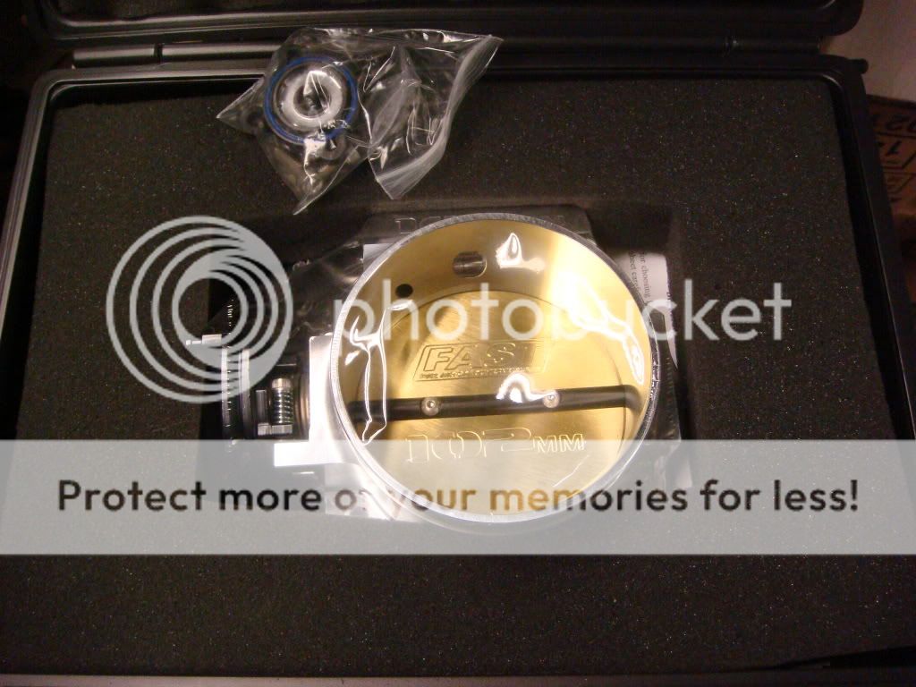

Finally the Throttle Body turned up, ordered a month ago, then package was lost, finally turned up in Australia ? Vendor was good about it & sent a replacement.
Came in its own plastic & foam protective case, so god knows why it had to be shipped in a box nearly 2ft cubed.

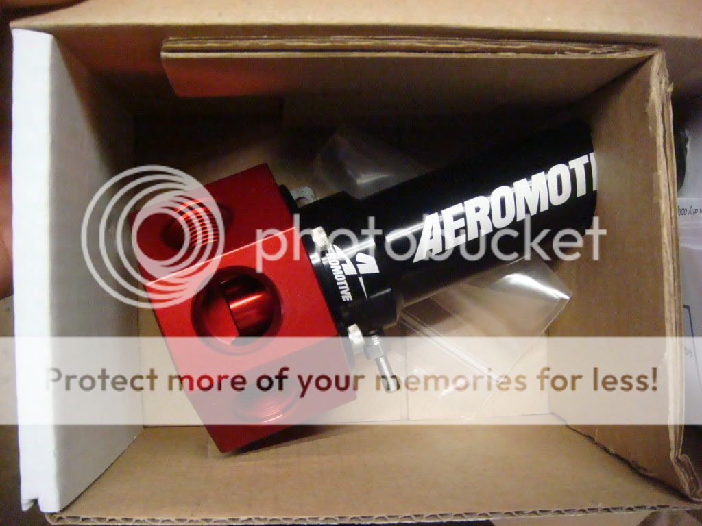

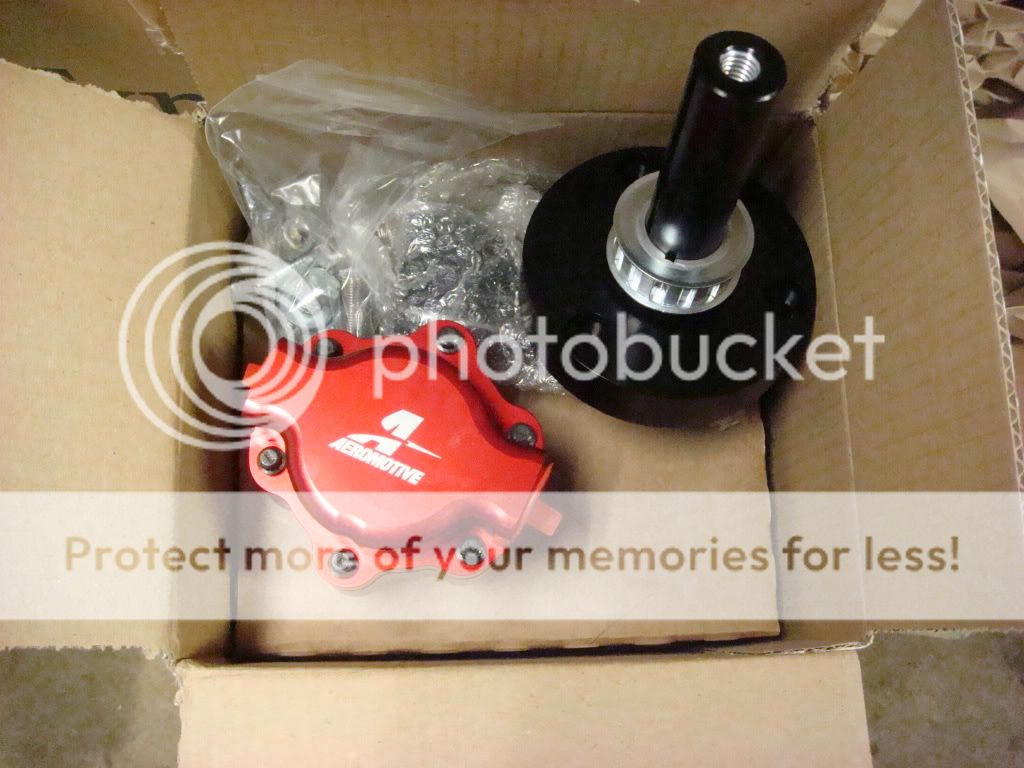

New mechanical Fuel pump & Reg arrived this week, that only took 4 days to my door
Posts: 13000
Mechanical fuel pump Mark? Now you've got me really interested, got any more detail on that? ;)
Posts: 6738
Ivor wrote:Mechanical fuel pump Mark? Now you've got me really interested, got any more detail on that? ;)
Nothing special Ivor, the 2 x Aeromotive pumps I had previously, can't keep up with the fuel demands.
This is just a EFI mechanical belt driven fuel pump, I was originally going to drive off the end of the cam, but limited space was available due to the rad. I will drive pump using a mandrel mounted on the end of the damper, with a 2:1 Drive ratio.
The plus side being no electrical load, pump is considerably lighter than the two elec pumps, also rated to 3,500HP (More than I need ) ;) Actual cost of pump was far cheaper than the elec pumps, should of considered this route the 1st time.
Different regulator required, but still 'Boost' referenced
With a mechanical fuel pump do you have to manually prime the car on start up or is cranking sufficient to get fuel in?
Posts: 6738
Pete wrote:With a mechanical fuel pump do you have to manually prime the car on start up or is cranking sufficient to get fuel in?
Cranking should be enough, if not, I will add a small priming pump.
