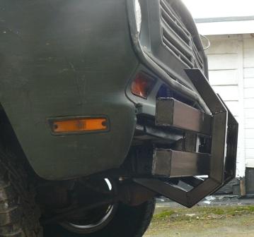

It's all back together now and painted. I had a slight hitch, i managed to touch one the transcooler ally pipes with the grinder blade, cut into it in a millisecond :roll:
It's turned out ok as the pipes were a pig to fit- all right angles and bracket stubs. I've chopped them back to stumps, flared the ends with a pair of pointy pliers and pushed on some braided silicon hose i had knocking around instead, lovely!

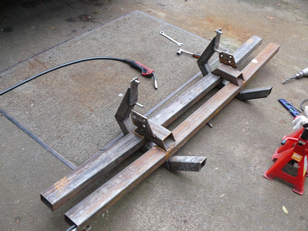

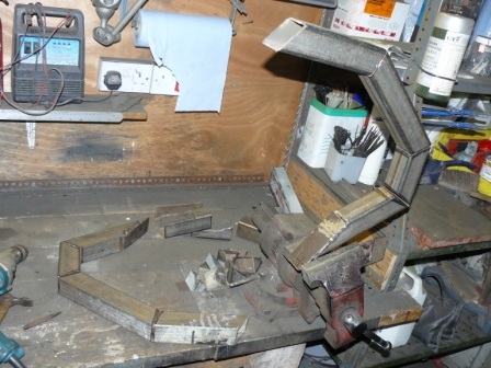

Just have to design & weld up the new bumper (2 lengths of 3x2" to match the rear) then mod & refit the crash bar over the lot.
Can you tell what it is yet?
I take it you give in then... :roll:

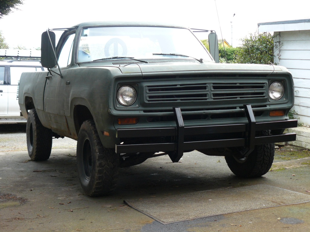

New nerf bars for me new bumper- all done now :D
I've made 'em so they run back to the chassis underside for a bit more strength.
Might add crosspieces top and bottom between the bars :-k

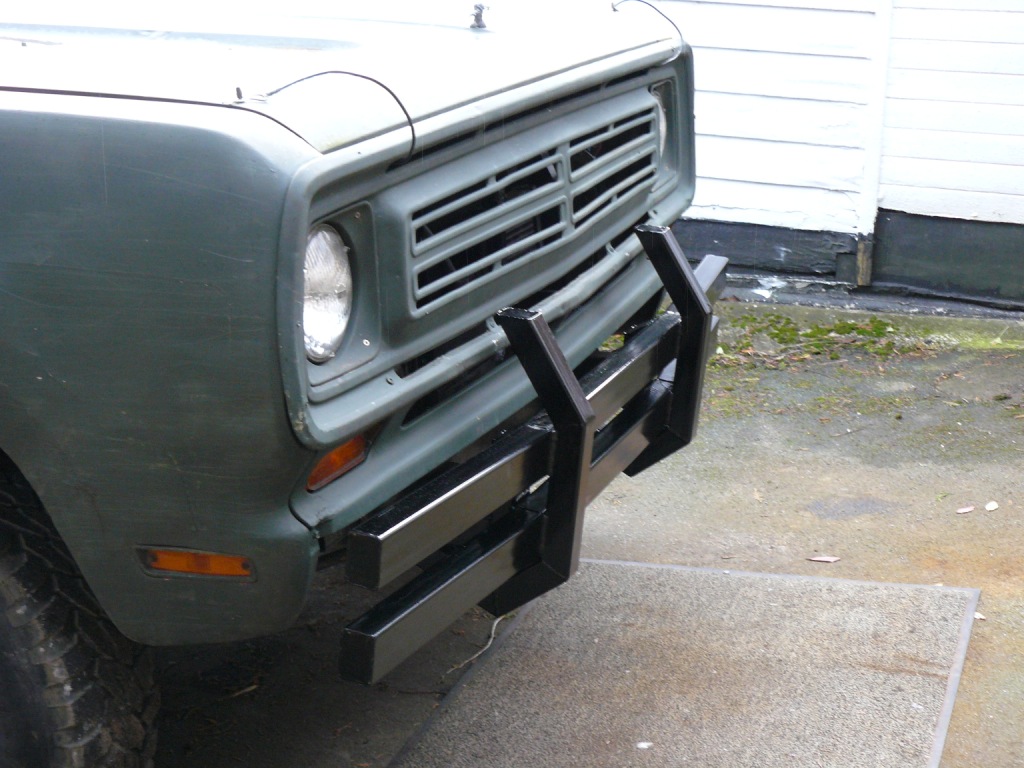

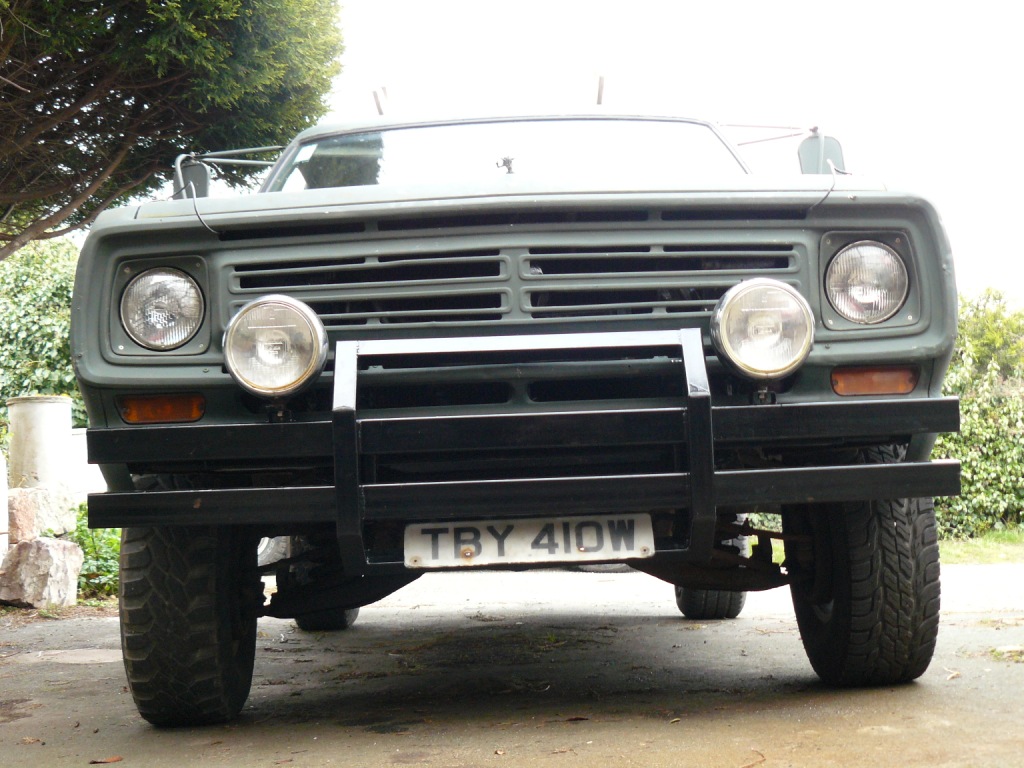

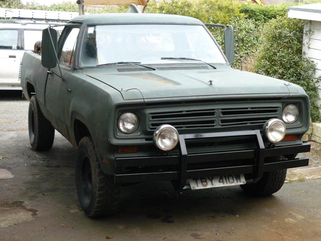

Added a couple more bars and stuck the cibies back on...
Now, i've finished enjoying the shinyness.
Do i matt black it like the rear or Green 'em both???
Ah well, enough pampering...back to work!

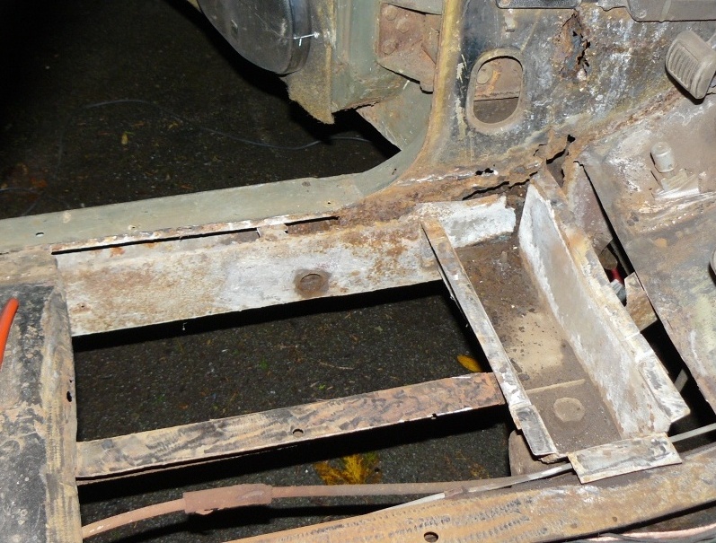

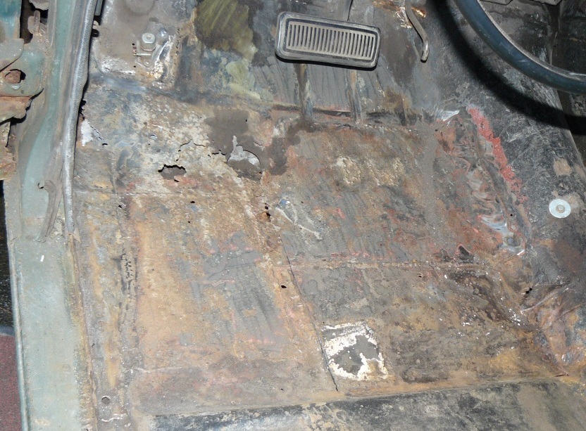

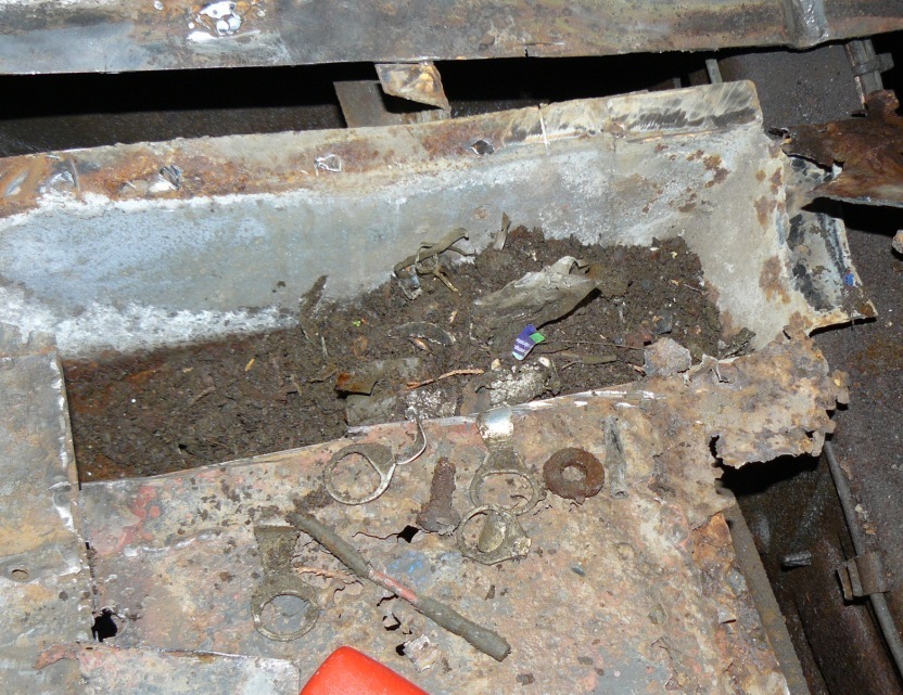

Well it's MOT time and even my lovely half-blind MOT man won't turn a blind eye to the big hole growing in the cab floor beneath my feet.
As with all rust problems, it's always worse than it looks... :cry:
Patches on patches on patches, it's like a bloody archeological dig :roll:
1st piece ready to tack in.

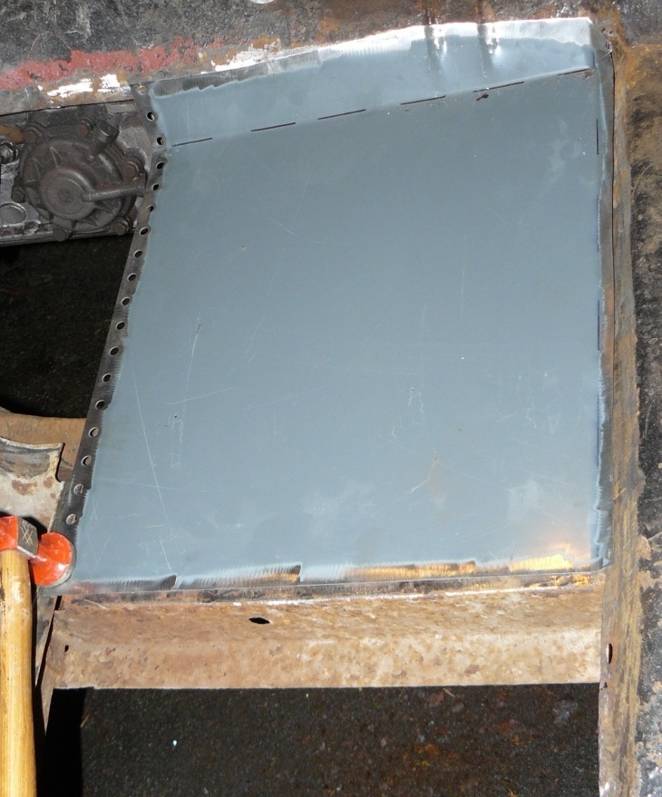

The scary bit. I'm just gonna ignore the holes in the sill, side panel and inner workings for now, i'll tackle that another day...
Remember when the ring-pull came right off your can? Yes, this chassis section has been gathering history a LONG time!
Count the patches...
