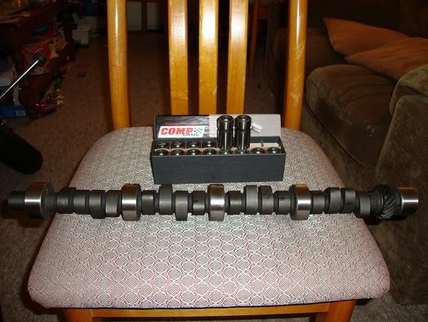

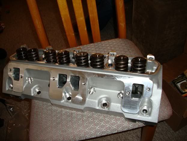

Good to see it's all happening.
Have you ordered the correct valve springs for the cam as your haven't put it on your list. Just a thought.
heads come complete heads and cam should be a good match ;)

Si, do those heads include adjustable rocker assembly, it might not need it as the cam is very mild especially in a 400+ci stroker motor, but you may still need the adjustabillity to get the correct valve train alignment.
I think it does guy im not fully sure,i just told chris what i was after and let him go nuts lol so when i see the heads will be when i know

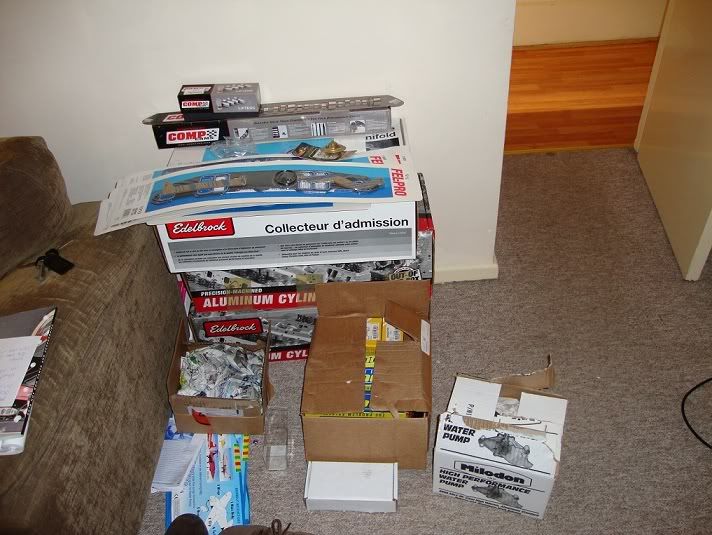

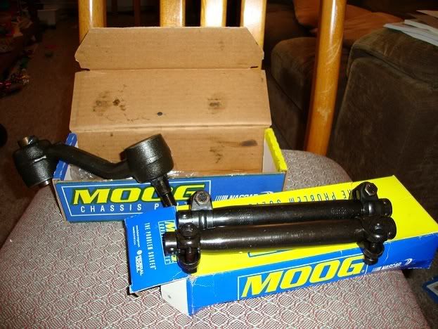

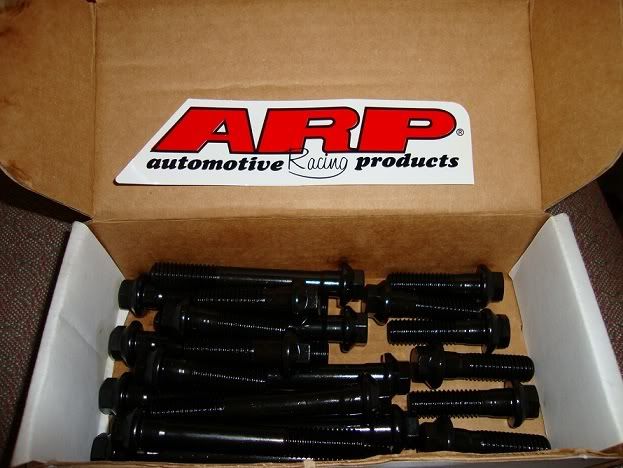

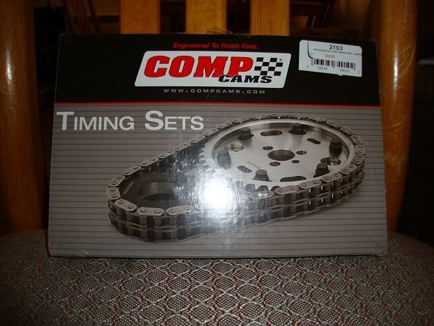

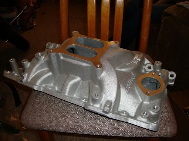

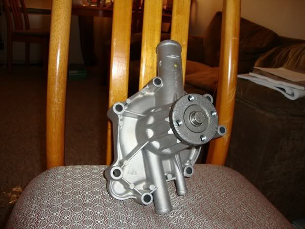

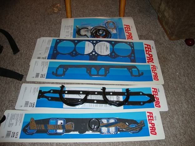

here we go then,this is the stuff i could be bothered to take a photo off,there is ALOT more,and also a lot more to come
Woohoo Si, lookin good. Bet you can't wait to get that lot bolted on. Same deal for me with leaf springs, rather than replace I just had them retempered.
What is in that bottom box though?
latil
Posts: 12076
Post by latil »
Drogo,that'll be a type of "supercharger" ;)
1965 Belvedere 2 426 Wedge.
Ha ha very good dave,king of photoshop :thumbright:
:lol: Well spotted Dave!
It's a good job you had a 'passion pump' laying around to photograph and use for yer trickery ;)

Did you end up getting adjustable rockers? I've got procomp rockers for my stroker, not tested yet but I've heard bad things about them. :(
