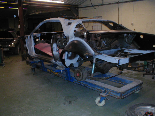

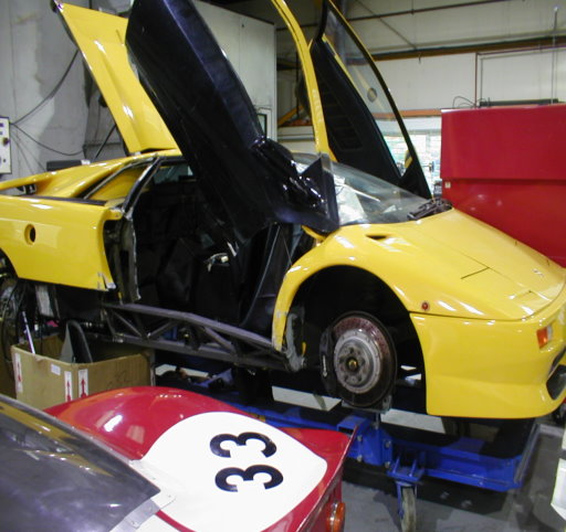

i do do cars for a living but had a few to many projects on the go at once, heres a few of them,
sold eveything now just got the challenger, never knew there was still so many people doing this era of car as at most shows now there tends to be mostly later cars there,

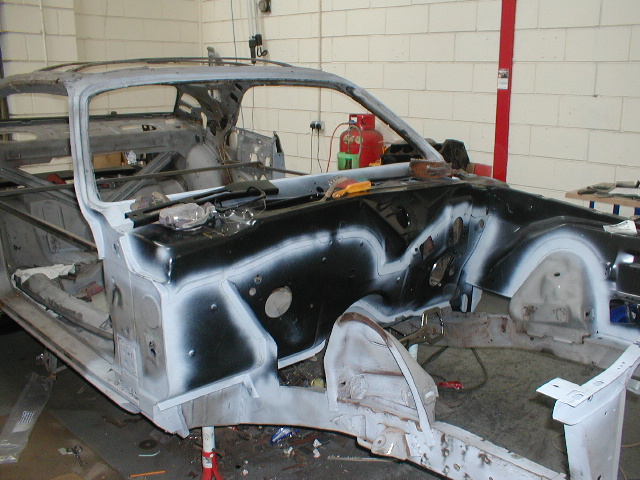

march 2009
panels finally arrived from tamaraz in the states, amd and goodmark now do quite a few repair panels, some of which were not avaiable at the time hence the repairs to the lower a posts,
these panels are all godmark except the corner cowl sections wich were amd, the fit ofthe panels was fairly good.

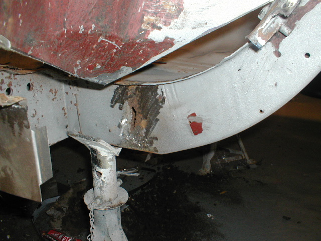

74challenger318
Post by 74challenger318 »

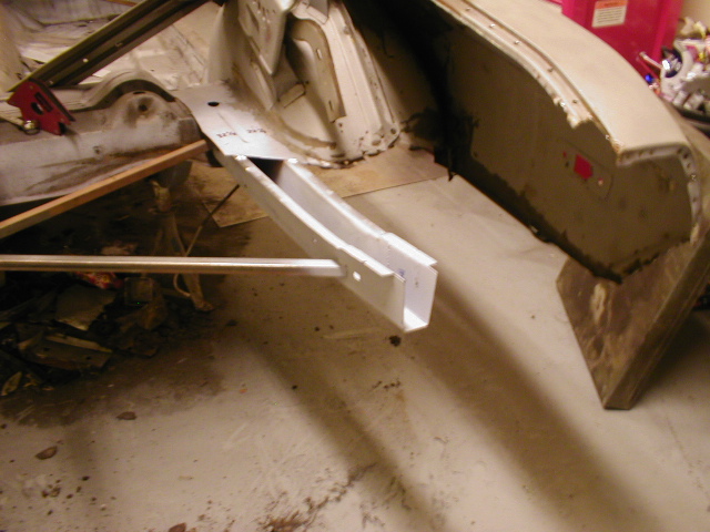

rear chassis rails rotted through from inside, these were not available at time so i had to fabricate them,
lh leg2.JPG (146.67 KiB) Viewed 1673 times
lh leg.JPG (149.84 KiB) Viewed 1673 times
leg end2.JPG (137.82 KiB) Viewed 1673 times
leg end3.JPG (143.92 KiB) Viewed 1673 times
leg end7.JPG (137.99 KiB) Viewed 1673 times

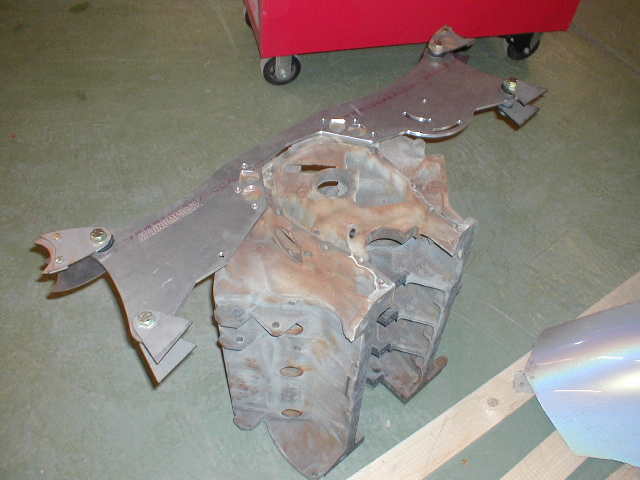

january 2010,
have decided to build car as a modified restoration , pickedup a 68 440 motor from woolhouse`s yard been sat in back of a pickup for over 20yrs,
can belive it if anyone has ever been up there, its not changed much since the 70`s apart from the cars have rusted away to nothing,
will be running it with twin turbos hopefully, suspension independent, with coilovers all round , usuing a btr hydratrac diff, aluminium uprights front and rear, with chrysler hubs

Love that firewall panel, what a terrific way to do it properly. 8-)

74challenger318 wrote:these panels are all godmark except the corner cowl sections wich were amd, the fit ofthe panels was fairly good.
Outstanding :thumbright: gets better and better. BTW, AMD panels are generally reckoned to be excellent, Goodmark get very mixed reviews so glad yours were good.

Watch out for the filler cap area not being deep enough on the replacement quarter panel. The body line at the far end of the panels can be wrong too. Always best if you can find a car with original panels to check against if possible.
