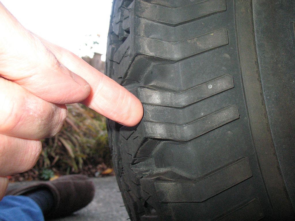

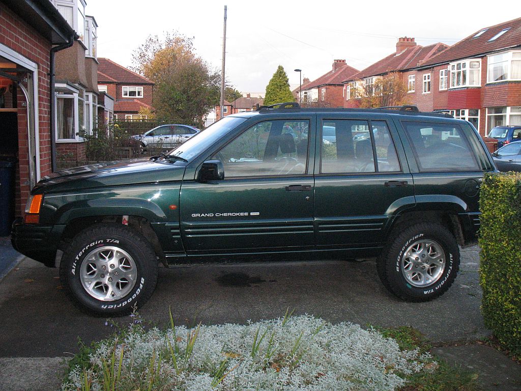

Got the 255 wide BFGs fitted this morning.
I did worry about them catching on something (I really wanted the 245s but couldn't get any from anywhere) and they do catch a little.
At half lock on a bump they just catch a plastic lip on the front bumper. Easy fix to trim it.
On full lock the front tyres rub the chassis and anti roll bar a little. Nowt I can do about that.
So if anyone is thinking of fitting bigger tyres on their Grand Cherokee please take note!
(They do look the business though :) )

Tyres rubbing anything is MoT fail. Are there no lock stop adjusters?
1965 Belvedere 2 426 Wedge.
latil wrote:Tyres rubbing anything is MoT fail. Are there no lock stop adjusters?
Dunno? :?
It catches the anti roll bar one side more than the other. This is the worst side. But as you can see there is little to see on the edge of the tyre itself and if push came to shove there is plenty of meat on the tread. I could just shave off a quarter inch.
But the guy that fitted them is also my MOT bloke so I don't expect problems.

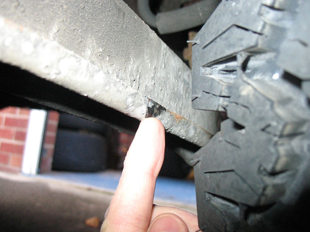

Here is where I thought it might be rubbing the chassis.
It is just on one side and in fact it is the control arm that it Bananarama!. You have to have the steering as hard over as possible to get it to catch there. I could maybe ding that area with a hammer?
Also i didn't want the white letters showing on the outside. But I forgot to tell them that. :oops: :oops:

That control arm will move a little with a lump hammer :thumbright:
How about 1/4 inch wheels spacers to clear to the arb?
latil wrote:That control arm will move a little with a lump hammer :thumbright:

white letters on the outside is cool :thumbright:
The reason its rubbing is cos sometime in it life somebody has adjusted the tracking & centred the steering wheel so it will turn a tighter circle in one direction than it will in the other direction, not all cars use lock stops but instead rely on the limits of the steering rack, so if the rack aint centred then it will have slightly more lock in one direction

It has been messed with for sure because the steering is off centre but the tracking rod is rusted solid so it will need a lot of heat and effort to get it shifted.
However it hits the arb on both sides of the car. Just slightly more on one side than the other.
