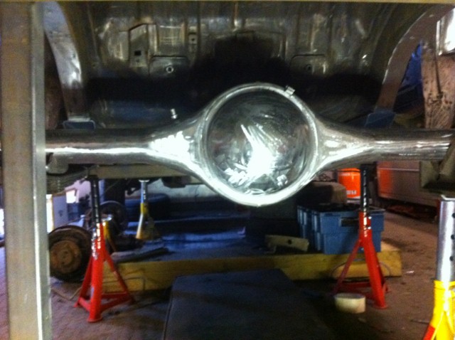

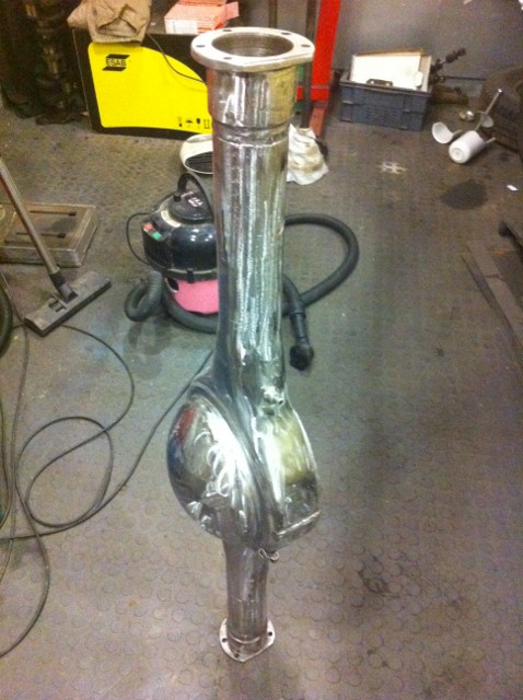

got all excited and couldnt resist resting the axle case in there :thumbright:
dont know about anyone else but i love the look of an 8 3/4-there is something about its smoothness :oops:
axle sat in-only just but had to do it!
IMG_0515 (640x478).jpg (78.58 KiB) Viewed 1224 times
axle cleaned up and devoid of all the 4 link brackets now- much nicer.
IMG_0511 (478x640).jpg (89.18 KiB) Viewed 1224 times

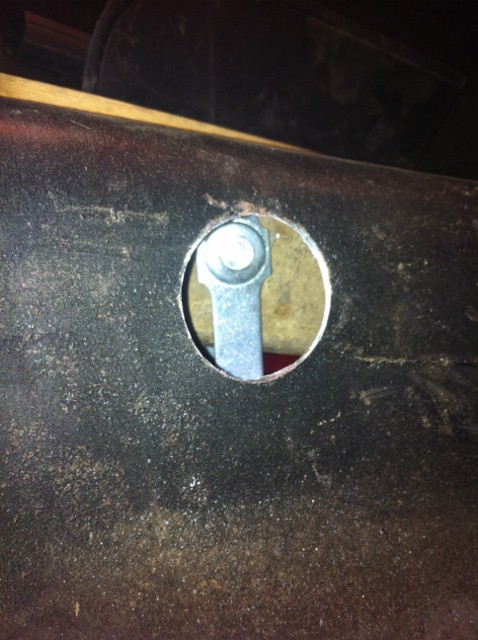

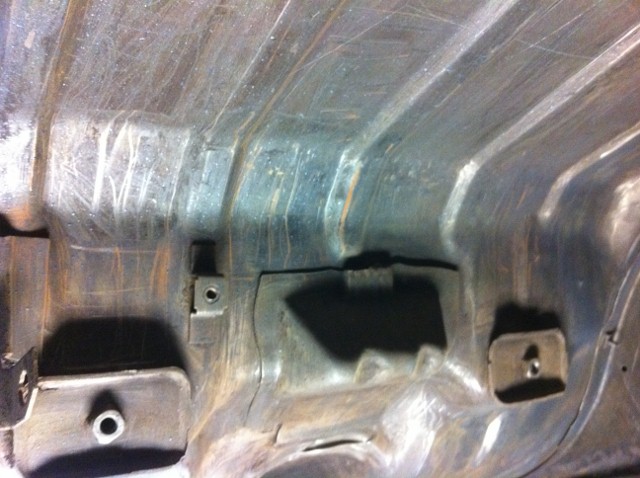

this is the hole in the chassis -its in exactly the right place-thanx ma mopar-sleeve is in place after drilling to suit.....
IMG_0552 (640x478).jpg (82.71 KiB) Viewed 1206 times

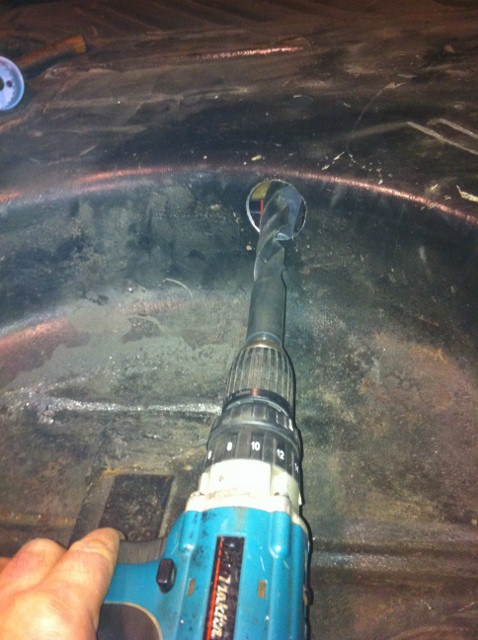

after much scratching of head the only way to do it properley was thru the spare well
IMG_0533 (478x640).jpg (86.81 KiB) Viewed 1206 times

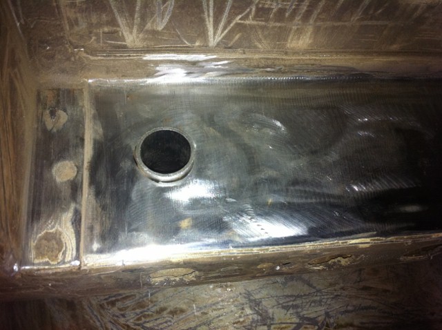

drilling out the hole already in the chassis to take the tube for the rear spring mount
IMG_0532 (478x640).jpg (82.27 KiB) Viewed 1206 times

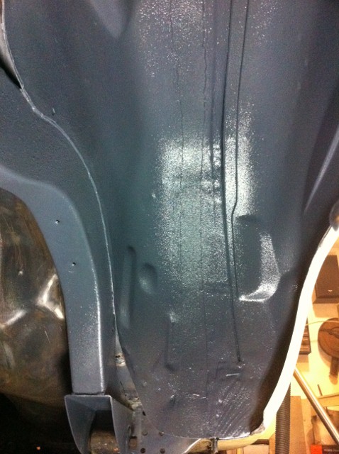

arches both now welded so time for <br />a lick of schutz
a lick of schutz
IMG_0553 (478x640).jpg (88.87 KiB) Viewed 1197 times
now welded in place and the first signs of coating......
IMG_0572 (640x478).jpg (68.09 KiB) Viewed 1197 times

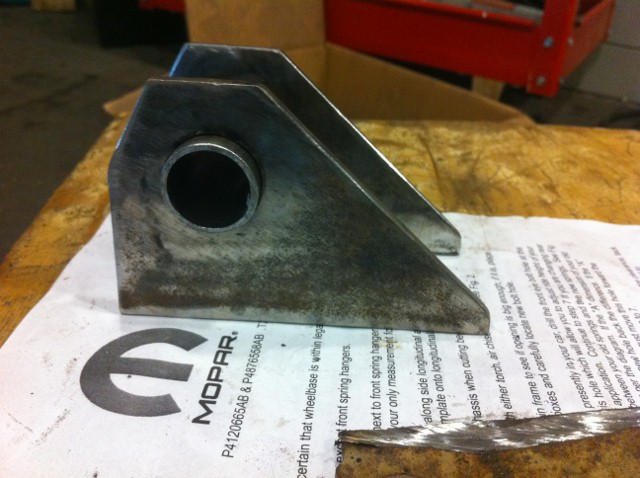

ready for welding in place.....
IMG_0550 (640x478).jpg (81.69 KiB) Viewed 1197 times

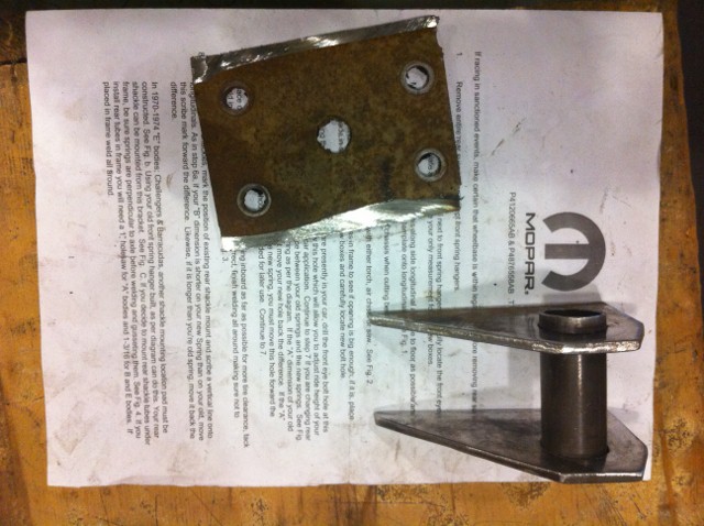

here i used the ears off the old spring mount which are spot on for strengthening either side of chassis
IMG_0549 (640x478).jpg (90.69 KiB) Viewed 1197 times
