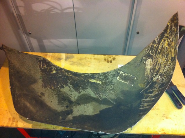

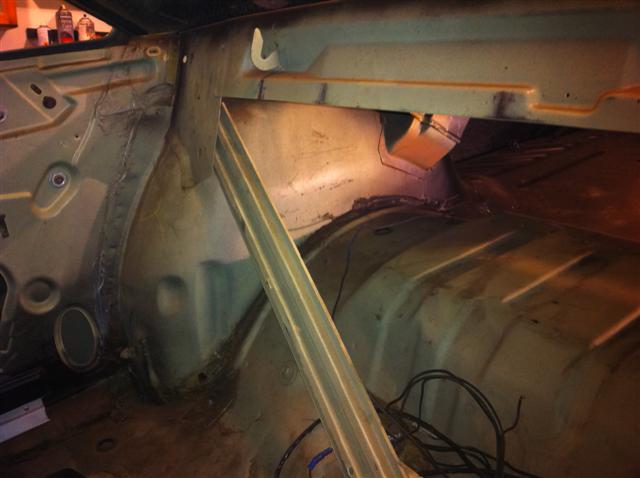

trunk view
trunk view
IMG_0446 (478x640).jpg (88.67 KiB) Viewed 1958 times

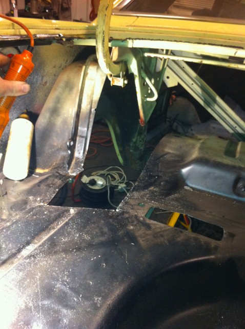

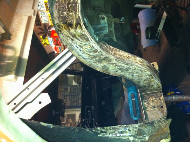

inner arch caked in goop<br />zero rust tho!
zero rust tho!
IMG_0451 (640x478).jpg (79.99 KiB) Viewed 1958 times

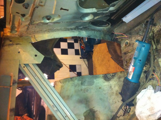

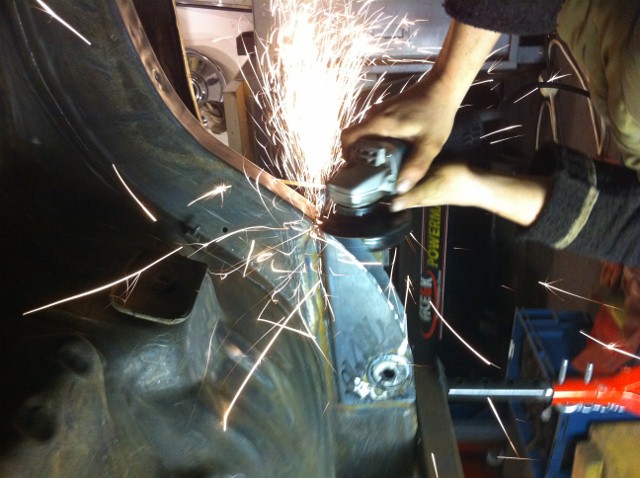

cutting out-spent plenty of time getting the line right so it installed factory look again
IMG_0450 (640x478).jpg (89.22 KiB) Viewed 1958 times

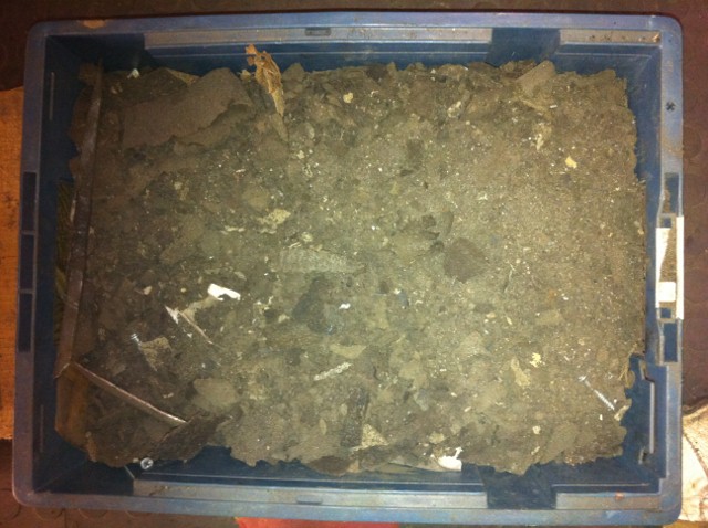

worst part of this stage was heating and scraping all the underseal off
a whole box full of underseal !

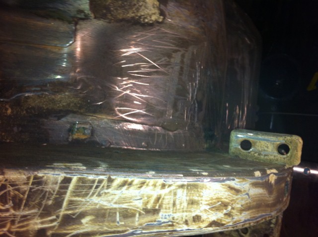

brake cable bracket-this has to be removed..
IMG_0453 (640x478).jpg (75.82 KiB) Viewed 1926 times
pre cleaning
pre cleaning
IMG_0448 (640x478).jpg (93.99 KiB) Viewed 1926 times

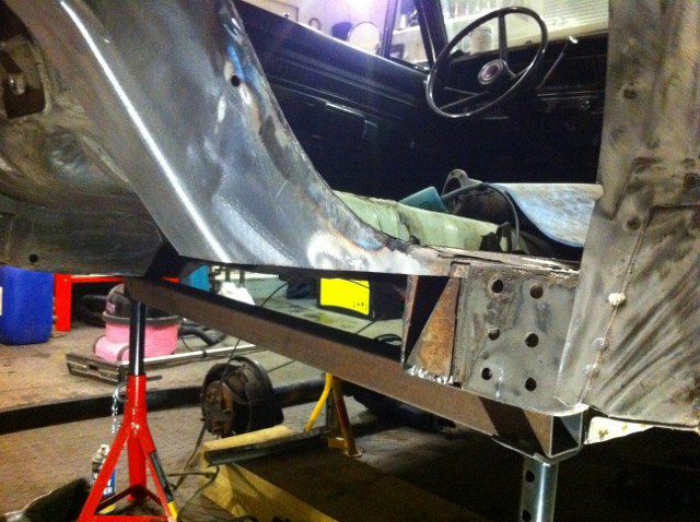

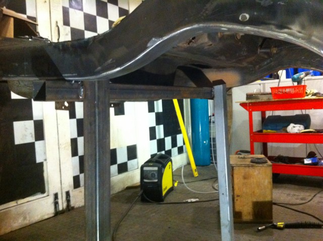

before cutting out for spring boxes <br />we made a support for the back end<br />better safe than sorry
IMG_0482 (640x478).jpg (85.38 KiB) Viewed 1901 times

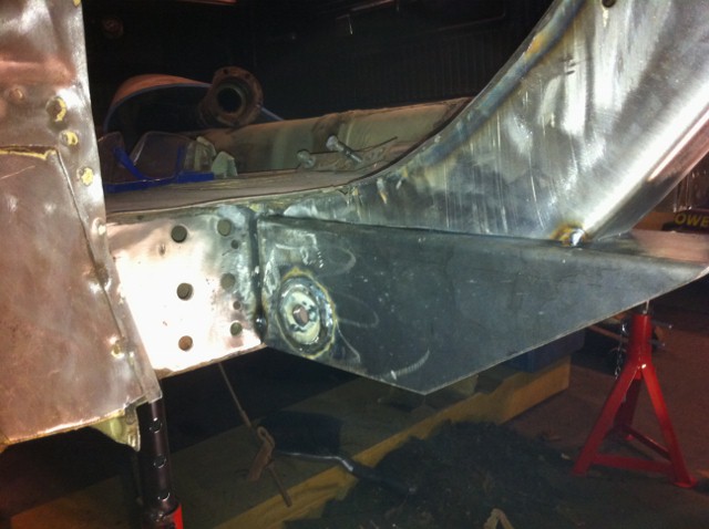

new boxes
Post by LONGSHOT »

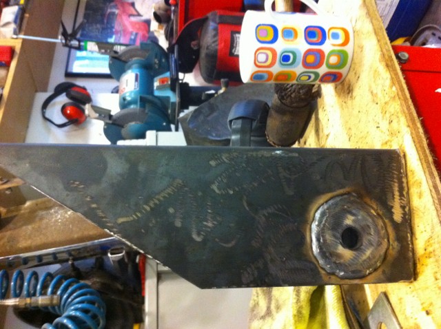

the spring boxes dont come as curved as chassis so once welded in we reshaped and added reinforcement to the holes.....

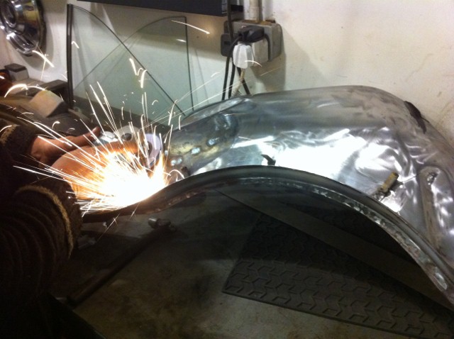

reshaping to match-action shot
IMG_0502 (640x478).jpg (86.6 KiB) Viewed 1893 times
new box welded in all round
IMG_0497 (640x478).jpg (69.25 KiB) Viewed 1893 times
chassis cut out ready for box
IMG_0484 (640x478).jpg (99.23 KiB) Viewed 1893 times
new spring box
new spring box
IMG_0495 (640x478).jpg (95.59 KiB) Viewed 1893 times

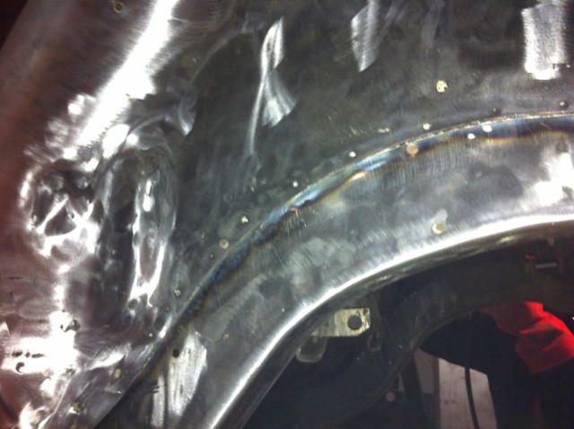

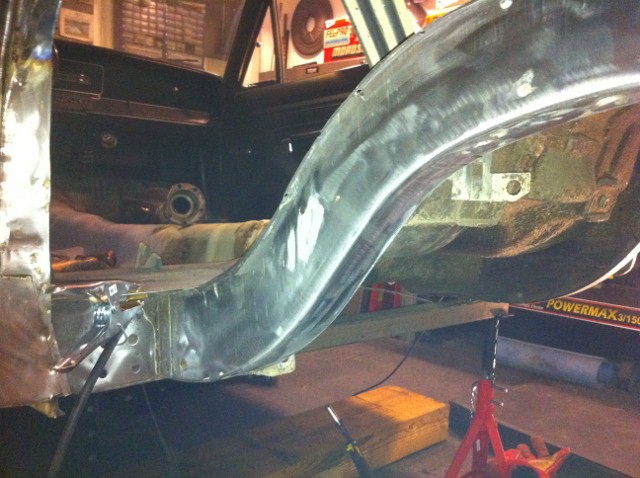

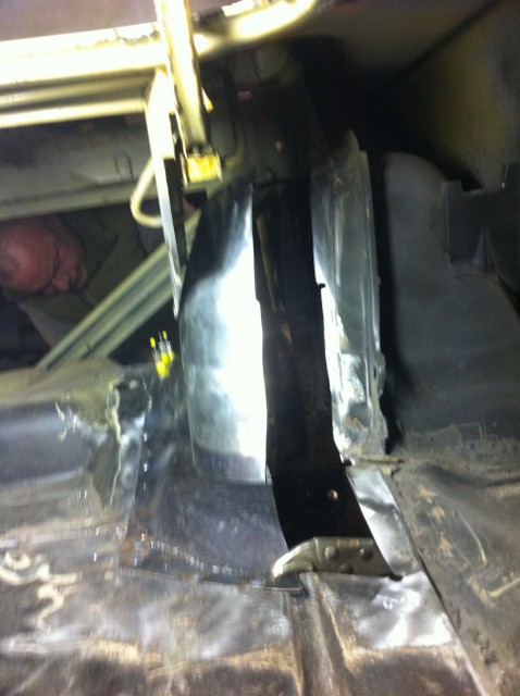

chassis closed with weld and arch now welded in place
IMG_0474 (640x478).jpg (72.44 KiB) Viewed 1846 times
arch in place for welding<br />take time to ensure even gap right thru-note skin pins-very handy
IMG_0506 (640x478) (2).jpg (74.21 KiB) Viewed 1846 times

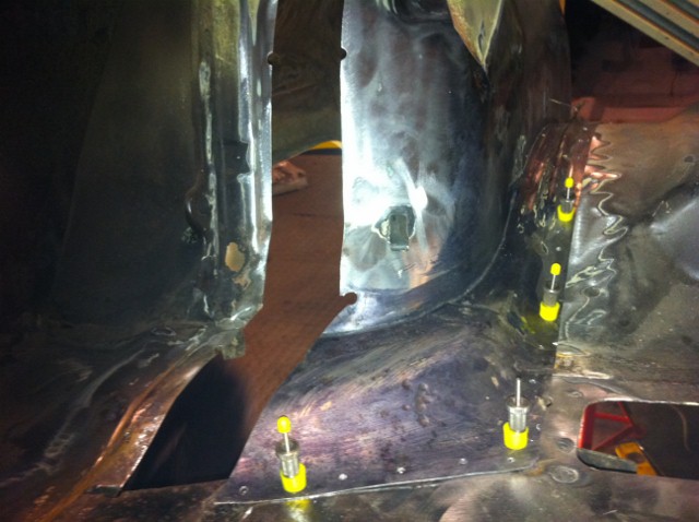

pre drilling ready for plug welds<br />on inner arch
on inner arch
IMG_0505 (478x640).jpg (67 KiB) Viewed 1846 times

LONGSHOT
Posts: 1009
arch
Post by LONGSHOT »
same as above pic showing extra width acheived-note how well with a trim the trunk hinge bracket relocates.
when doing this job it almost seems as if ma mopar had designed it to be done 8-)
