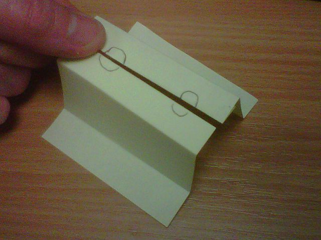

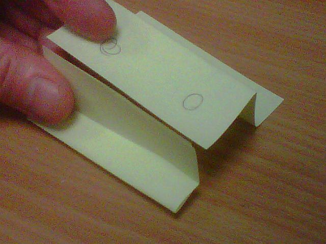

Dave is this what you mean made from 2 parts and joint down the middle
Yes because to bend a complete chassis rail with just a vice and a hammer is going to be tricky as it is a lot more narrow than your bit of card.
Also if you do not have steel hole cutters it would be easier to drill and file the holes in two halves too before welding together.
