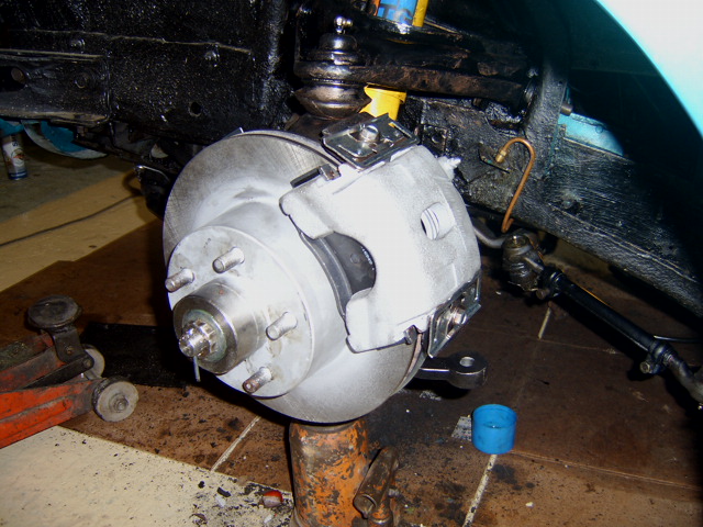

Had a few hours to spare this weekend so I went out to garage to assemble the hub and calliper - it was easy, the only complication being, although minor, was that I had to bend the metal part of the brake hoses as it was stretching a bit on full lock (see pic).
completed hub assembly
had to bend this a little to give a bit more slack

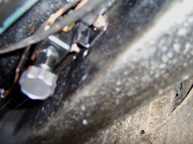

Brake conversion now complete, just got to adjust the proportioning valve to stop the rear brakes locking before the front.
The proportioning valve is plumbed into the brake pipe that runs to the rear brakes.  Also ran all new brake pipes
In goes the booster.
