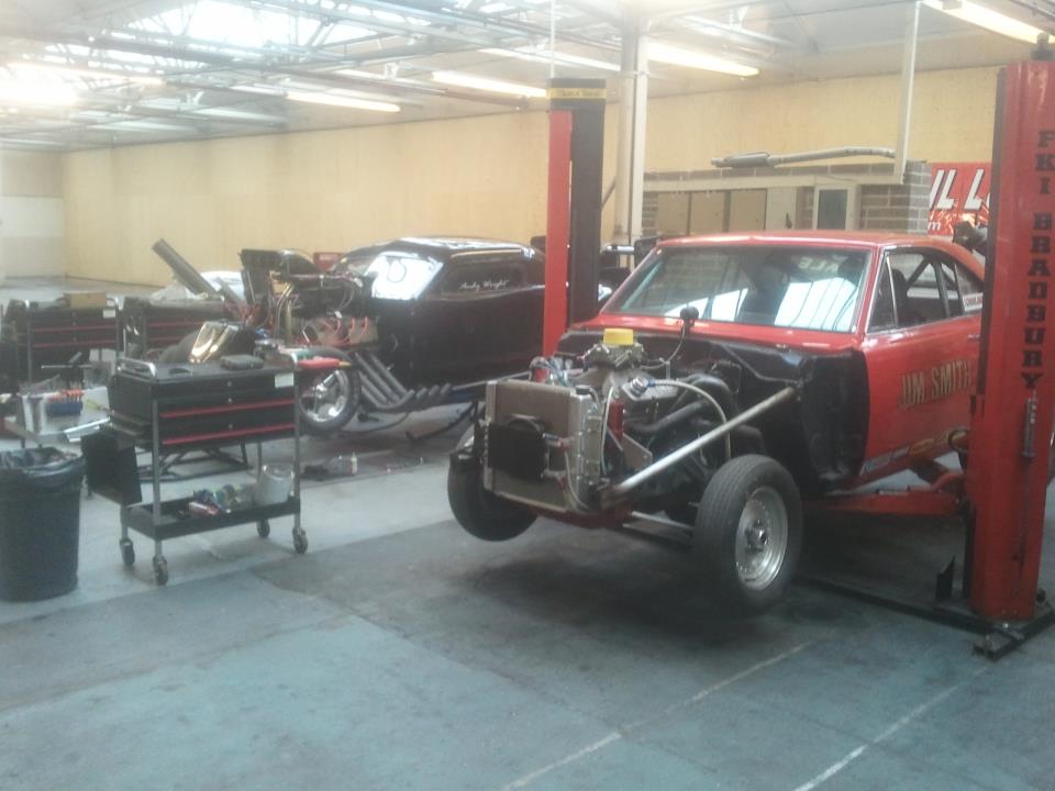

Well done Pete ,,,, I was told to mount trans cooler to the front of rad,,,,couple of bracketts welded to the rad and jobs a goodun..not a great photo...

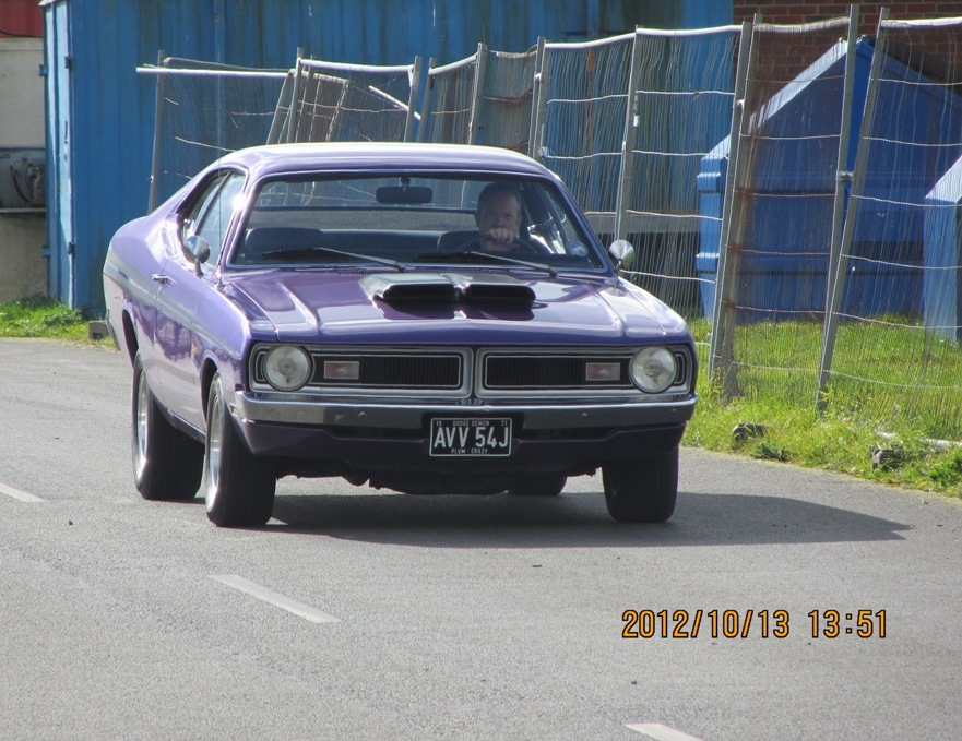

:thumbright: Great days driving, even better meeting people to put faces to names (not the best with names, see Billy Gibson on the Friday thread :oops: ) Loads of advice taken away with me to try and open my ol steam roller up :lol: soon be spring and we can start all over :thumbright: thanks guys.
Posts: 22109
Sweet car.
Also saw Chris (WASP) up there with a nice Camaro...

trouble with mounting the cooler on the rad is it comprimises the water cooling to a degree try to get it to the left of the rad pete under the headlight
