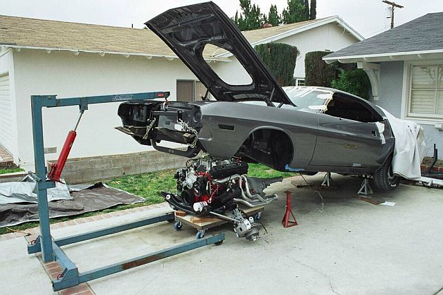

I made a dolly to take the engine and trans from 4x4 (or was it 4x2?) wood and six castors. So it rolls in and out.
Lift the front of the car with straps around the bumper brackets. A long reach on the hoist will allow most of the engine to pull forward enough to let the car down onto axle stands so you can remove the hoist and pull the engine out from under completely.
I found removing the intake and valve covers helped with lift height.
With the car on axle stands first I was able to get the engine and trans far enough under first to get the hoist in position. My hoist had V-shaped legs which meant I couldn't get the legs very far either side of the engine.

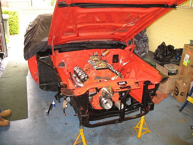

smashin
looks eminently possible in my virtically challenged workspace..
although if they are your feet i can't work out how you took the photo
teloscopic arms?

I normally put car on axle stands hood off ang the put engine in on its own with a small block of wood under the sump on the steering link bar to stop engine falling back and then I put the gearbox on afterwards.
I install the engine on my own with all the accessories bolted to it so less bending over the car installing all the parts.
