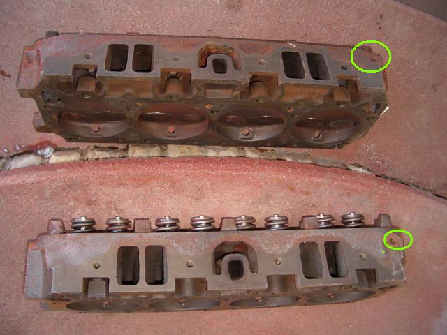

i use a chain on the 3/8 bolts in the two empty holes on the heads simples,

Cannonball wrote:i use a chain on the 3/8 bolts in the two empty holes on the heads simples,
That was my first plan of attack, but my chains are not really long enough.
I find that it is hard to get the engine suspended squarely on chains using the holes in the head as they are not symmetrical.
Not worried on a race car, but don't want this motor to come crashing down on the Fender.......
thats how ive taken my engine out many a time over the years , iron heads , plenty strong enough , even taking it out fully built up with everything attached iron intake & exhaust manifolds , water pump housing etc , since i done the resto , went to using grade 8 bolts & double thick washers , & a new 1 tonne rated chain just to be on the safe side , :shock:
use longest bolts as you can , to screw into as much of the thread in the head as possible ,
