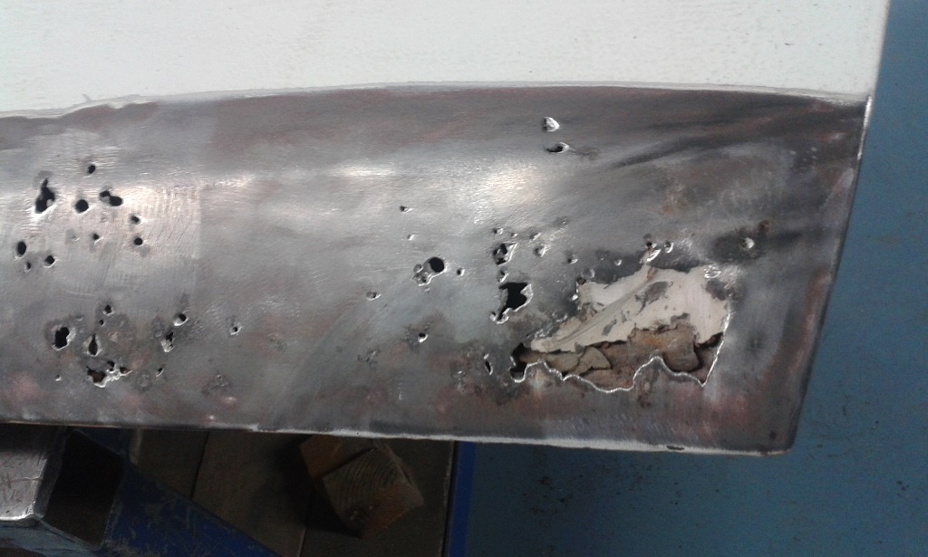

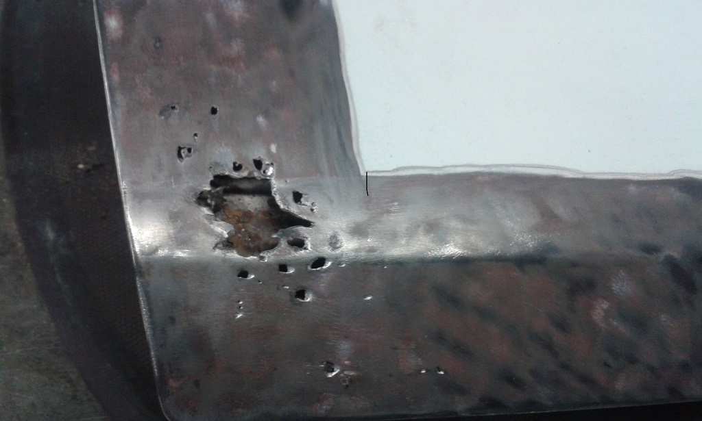

When I bought the car I checked the condition of the bottom of the doors and although I was aware that a repair would be required, it looks like the metal worm has had a bit more fun than I originally anticipated.
The most cost effective option is to replace the skin and as the driver's side isn't much better and has the added benefit of a previous repair, I'm biting the bullet and getting both replaced as Year One do replacement skins.

Bottom front of Passenger door.
20140902_171219 small.jpg (169.98 KiB) Viewed 2743 times
Bottom rear of Passenger Door.

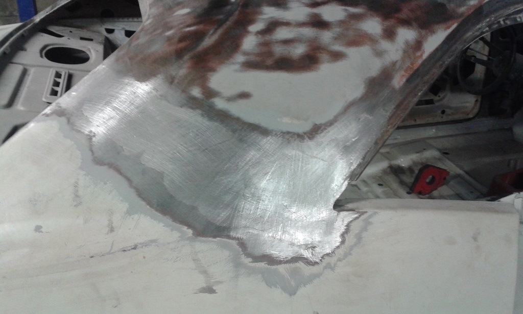

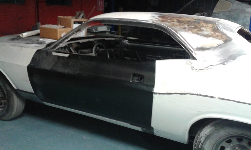

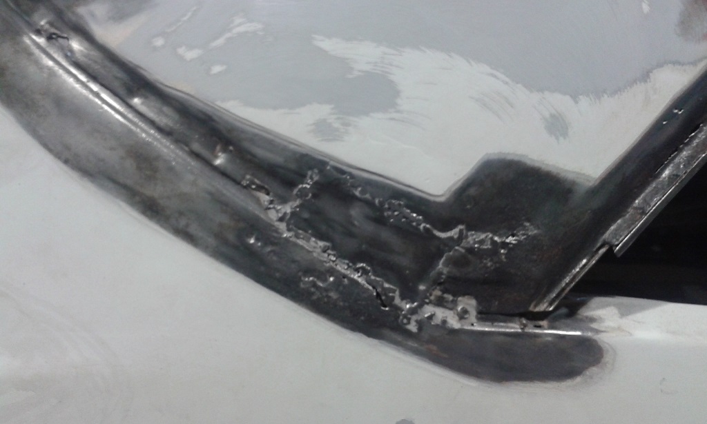

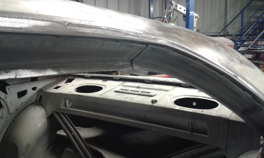

Whilst waiting for the new door skins to arrive a bit of investigation was done on the rear roof pillar join. A couple of pinholes on the left hand side and a patch on the right. Both sides cut out and new metal welded in and leaded.

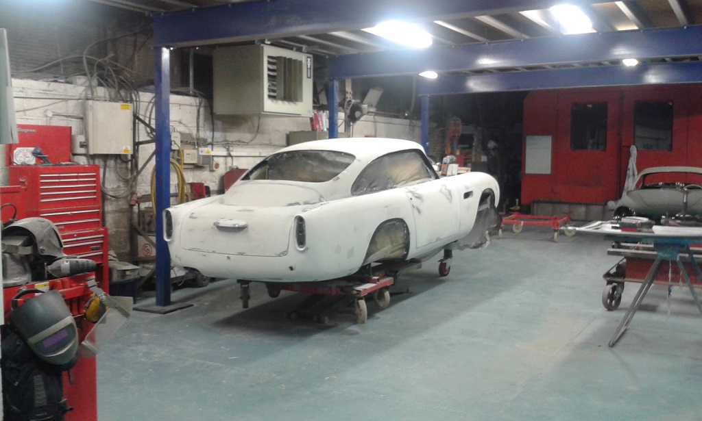

As I've said, I'm using a bodyshop to complete this work for me (as I have very little aptitude for bodywork). I've included one of their more usual projects for information.
Patched!
Patched!
20140902_172328 small.jpg (129.91 KiB) Viewed 2710 times
Refinished B pillar
Refinished B pillar
20140913_104201 small.jpg (162.57 KiB) Viewed 2710 times
Currently sharing floorspace with Faux
20140902_172236 small.jpg (180.73 KiB) Viewed 2710 times

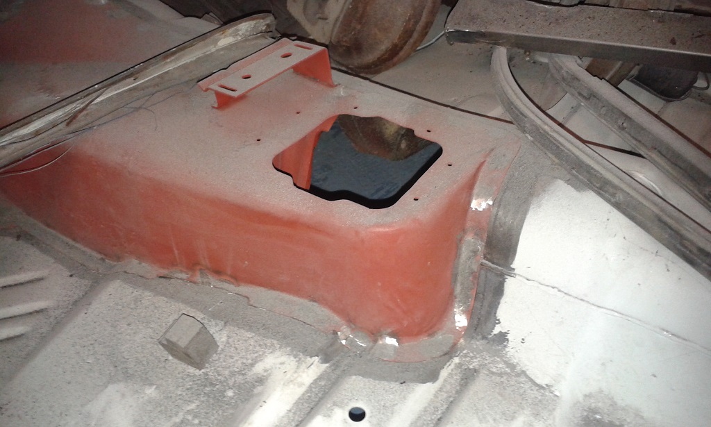

I mentioned previously that the intention was to convert this 318 Auto car to a 4 speed manual and as progress toward this, the 4 speed hump has now been installed.
On the downside, the metal worm has also been snacking up inside the roof gutter rails necessitating a bit more metal replacement so the window channels/gutters will fit properly.

4 Speed hump in situ

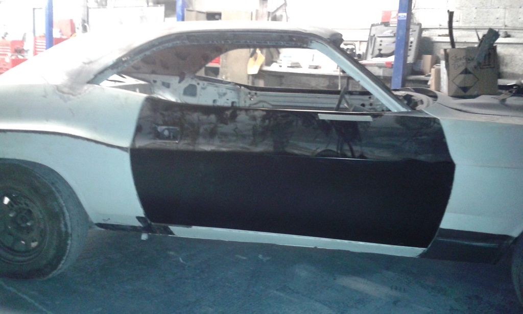

Well, looks like the bodywork is basically complete. New Year One door skins and deck filler panel installed and look good. Next thing, hopefully, is a trial fit of the 440.
Driver's side (masking tape line is a reminder to transfer mirror mounting holes across from the old skin)
20141018_110334 small.jpg (149.03 KiB) Viewed 2666 times

Pardon my ignorance but is that a TVR in the shop??

drewcrane wrote:Pardon my ignorance but is that a TVR in the shop??
Drew, it looks like an Aston Martin DB4 or DB5. :thumbright:
RW71 wrote:Progress is looking good Alan!:thumbright:
Ahh yes indeed ,my eyes ,I don't get to see these cars very much :oops: :oops:

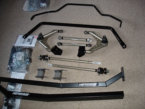

Well, it's been a while since the last update and to be honest, little's changed. This is not due the a lack of inclination on my part (for a change). I decided from the outset that Faux was not going to be a "stock" rebuild and to this end, I intended to go the Hotchkis suspension route.
The car had also had significant work done to the floors before I purchased it so it made sense to order the TVS kit so I could see what bits needed welding on before the underside got a liberal coating of stone-chip. A sound plan to my mind but I didn't factor in the fact that some parts (notably the sway bars) may be on back-order.
Finally, after about 4 months the shiny stuff's arrived so there should be some progress soon.
Most of the TVS goodies.
110415 013 small.jpg (94.4 KiB) Viewed 2590 times

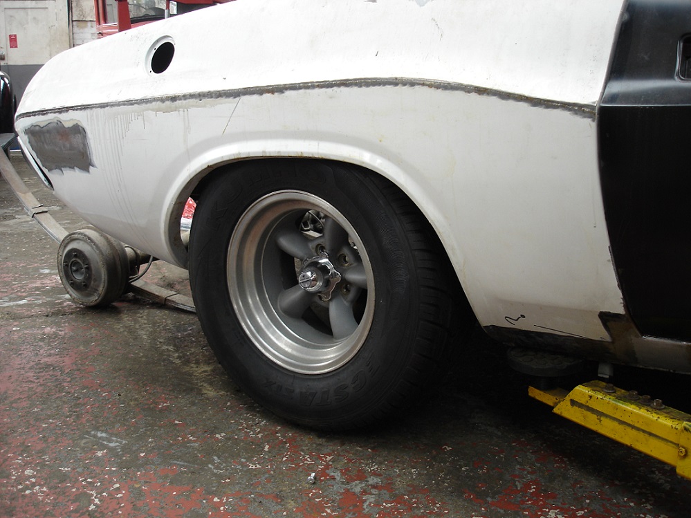

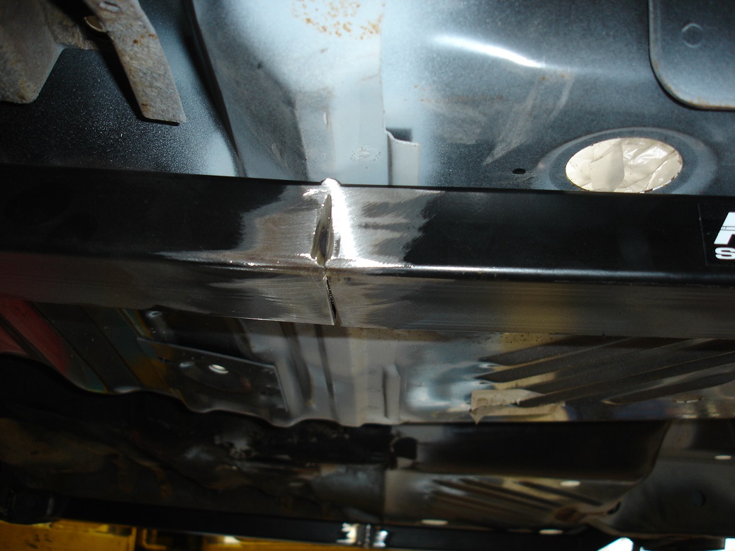

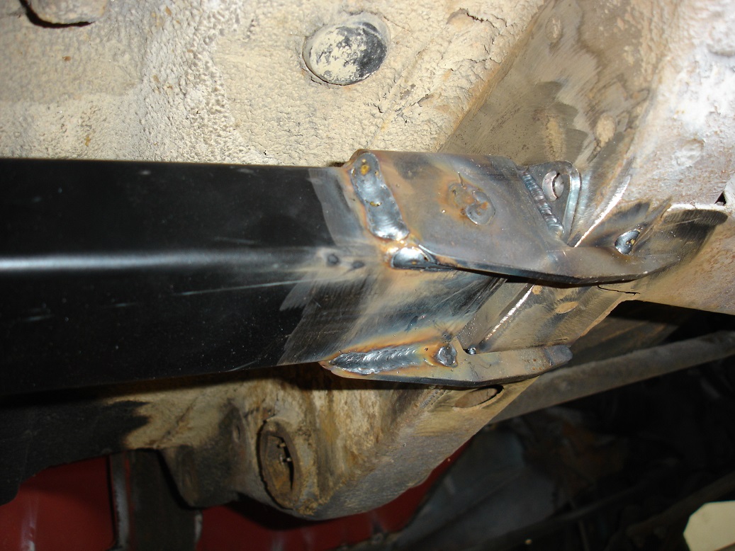

Next - a trial fit of the Hotchkis sub-frame connectors. These needed a bit of persuasion to fit where they'll ultimately reside. This may be due to the fact that my car had complete new floors installed before I bought it so they may sit slightly low but the end result is that the connectors have been notched and re-welded to clear the floor.
It also transpires that this car had the optional 2.76 final drive ratio diff rather than the 3.23 I was expecting.
On the plus side, a mock-up with a 15" Torq thrust shows the likely future stance.
Massaged to fit - awaiting welding.
Challenger 230515 011 small.jpg (197.48 KiB) Viewed 2524 times
Not my original vision for the wheels but I like it.
Challenger 230515 027 small.jpg (234.42 KiB) Viewed 2524 times

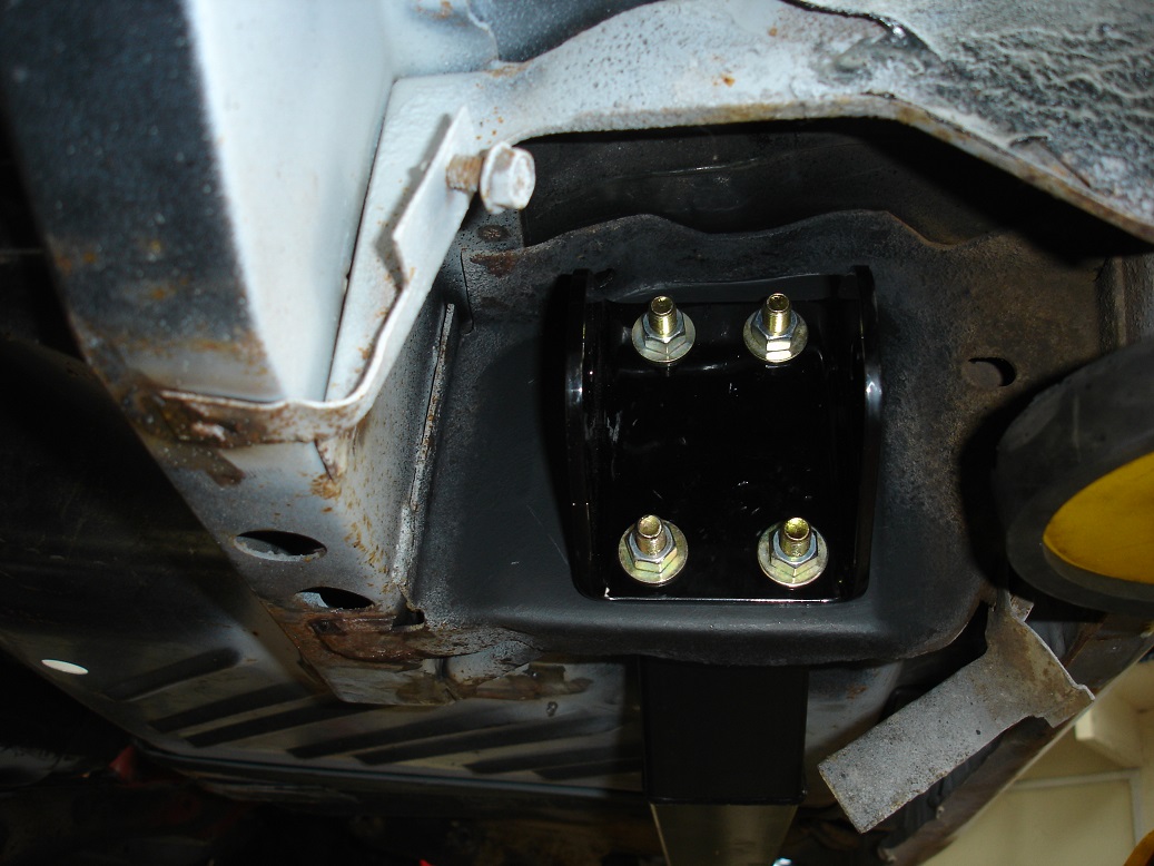

New leaf spring mounts -bolt to rear of the sub-frame connector.
Challenger 230515 010 small.jpg (218.54 KiB) Viewed 2524 times
Tacked on at the moment. Might need to adjust when the whole weight of the car is on it's wheels.
Challenger 230515 005 small.jpg (252.83 KiB) Viewed 2524 times

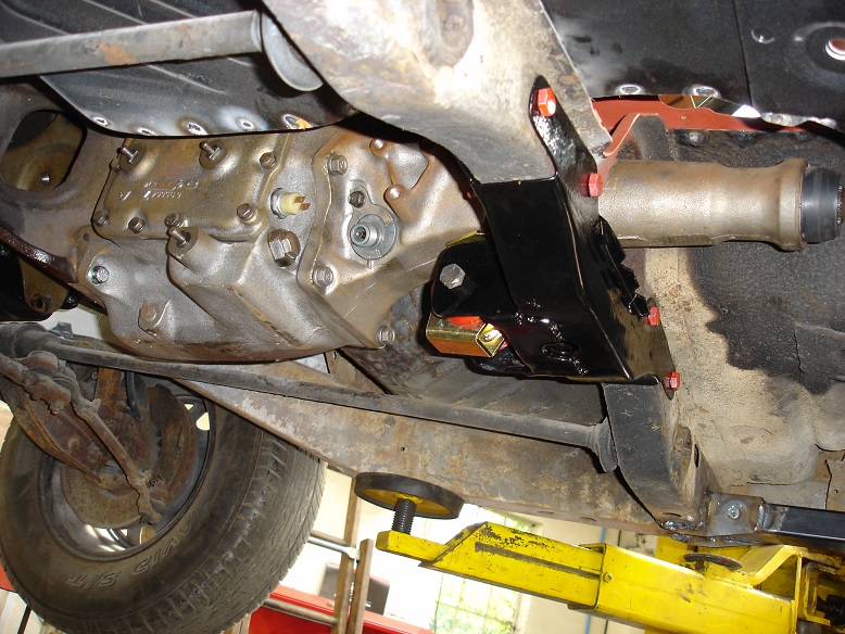

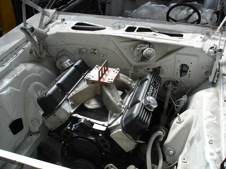

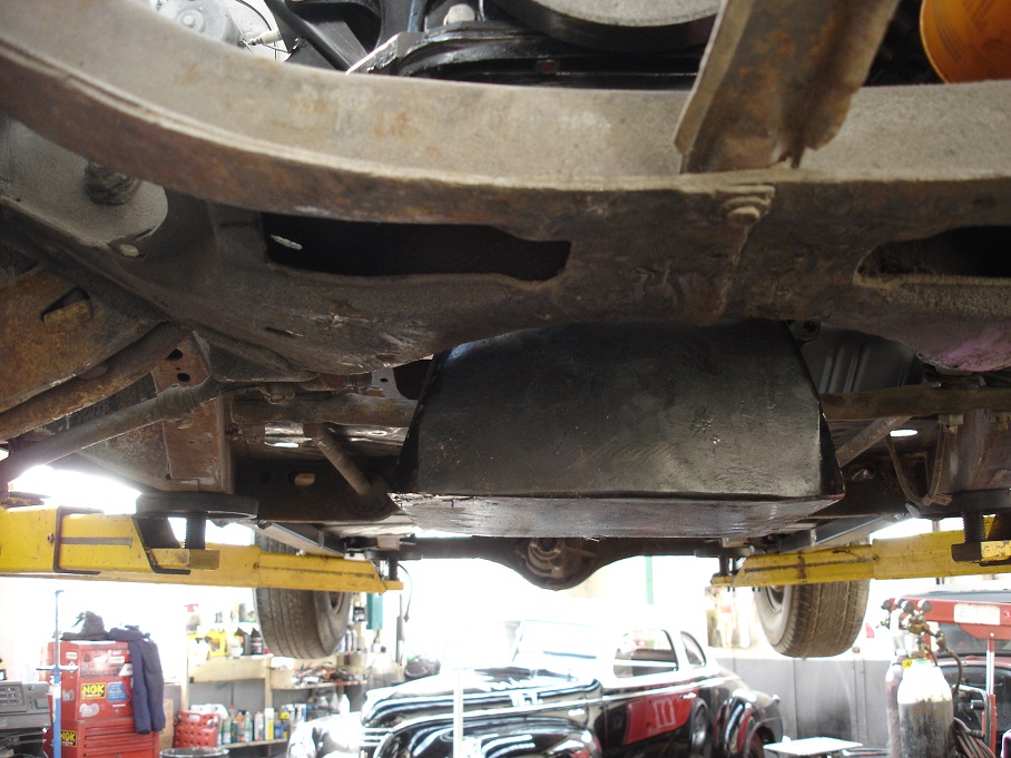

It was always the intention to trial fit the 440 and the manual gearbox to make sure everything lined up and, with the exception of the extended sump being a bit close to the K-member, it all seems to fit relatively well.
To balance the progress, it seems the steering box will need rebuilding/replacing at some stage.
More soon.
Transmission temporarily installed.
Challenger 300515 002 resized.jpg (223.18 KiB) Viewed 2463 times
Sump may need some additional clearance.
Challenger 300515 001small.jpg (221.58 KiB) Viewed 2463 times
Engine looks at home.
Challenger 300515 004 small.jpg (246.62 KiB) Viewed 2463 times
