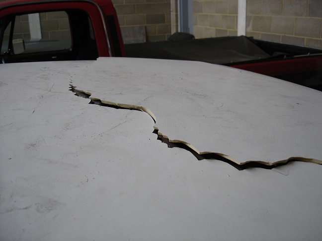

Ultimately it will be taken back to bare metal so I can see what's actually under the thick white gloss but I already know about the skim on the roof (which dramatically fractured when the panel was thumped from underneath) although the metal's still good so it should be repairable.

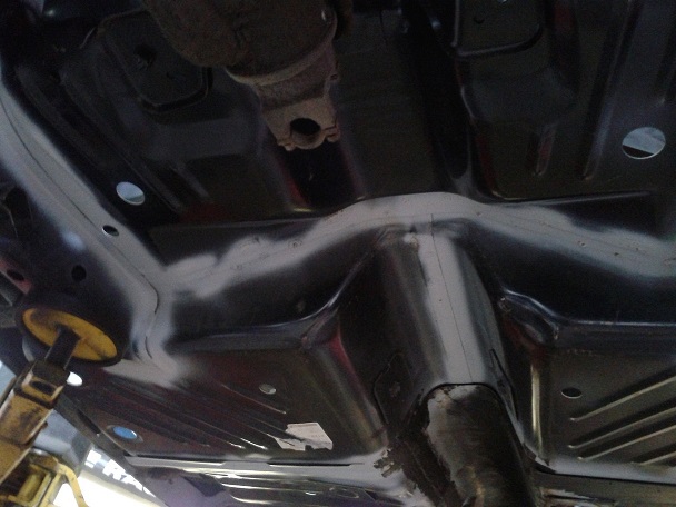

- Undercarriage - new metal - not covered in sealer/stone-chip yet.

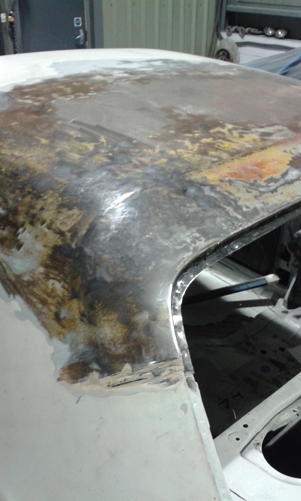

The end result (after a bit of panic) is that the car has now been moved to a body shop with the first task being to tackle the roof.
Just for clarity, I'm only paying the bill here (as I want a decent result at the end) but from the below, I'm fairly happy.

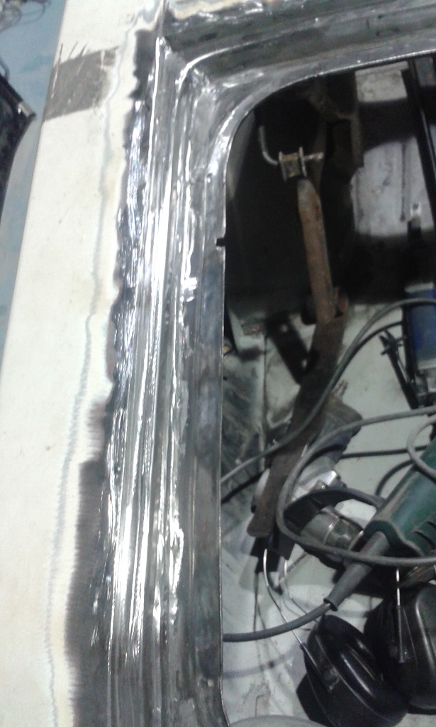

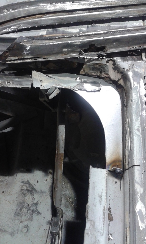

So, let me now bring you a bit more up to date. I mentioned previously that the car had already had some replacement metal work which included replacement rear quarters but as workmanship can vary, I wanted to be certain this was done to a decent standard. Fortunately the joint was found to be a continuous weld so there should be no issues going forward.
You'll note the running light aperture has been welded over - I've decided to remove these - partly because the lack thereof will suit the end appearance and partly to remove the bodge on the front wings which had been crudely adapted to take a 70/71 light.

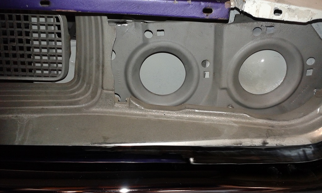

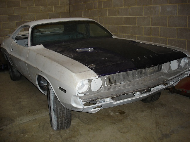

There's also been some work on the front end. The bumper has temporarily been fitted to align the grille and repaired/blasted headlight mounts installed (although they're not fixed yet in the picture).

- Right hand rear quarter - investigating the previous work.

- Front End with new headlight bracketry.

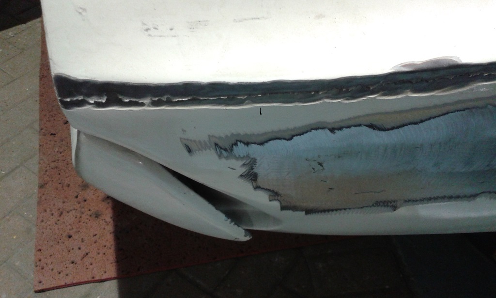

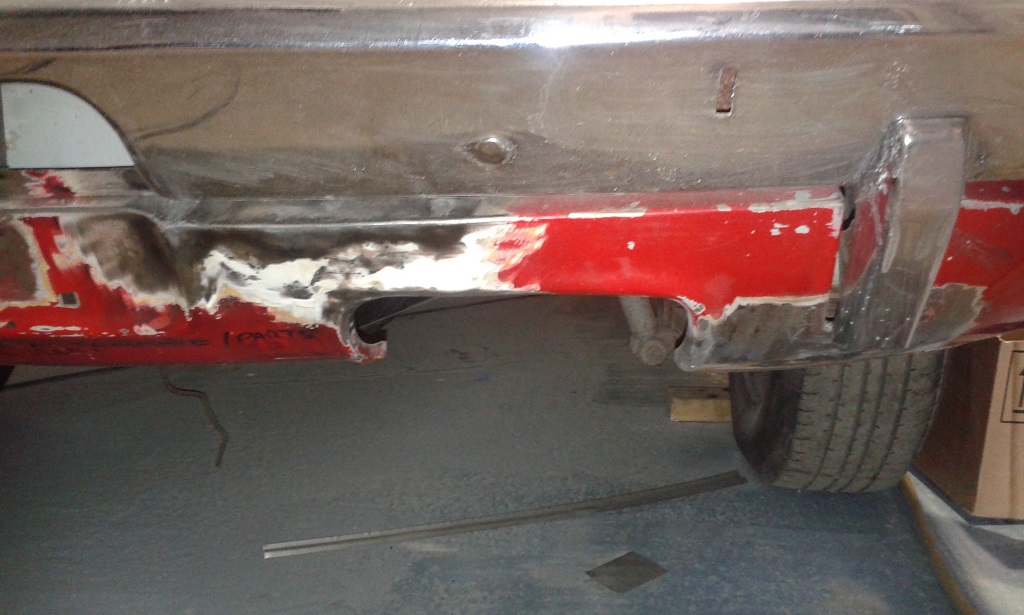

As I mentioned previously, the boot gutter has previously been the subject of some overzealous use of filler which has meant replacing the channels.
The original rear valance panel had a rust hole in the centre so this was always intended to be replaced. The replacement panel was obtained in kit form (as it had previously been cut to fit a 'Cuda) so there's been a bit of reconstruction surgery here too.

- Area around the overrider is new metal.
