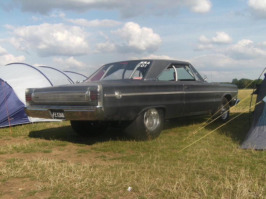

Got a few pics back from one of my mates :D
Nats pics05.jpeg (141.78 KiB) Viewed 3785 times
Nats pics04.jpeg (180.07 KiB) Viewed 3785 times
Nats pics03.jpeg (229.52 KiB) Viewed 3785 times
Nats pics02.jpeg (212.25 KiB) Viewed 3785 times

DB I love this car you have nailed together....Sorry to see the damage...I will tell you a story about a 289 ford engine I built many years ago ,,,triple valves springs are not a good idea with stock pushrods and pressed steel lifters...I never even got of the drive with that one :? Take your time sorting this out ,,, do your homework ,compatible springs with cam,installed spring height and seat pressure,,,and buy some good pushrods ....Guy gives some sound advice on locks etc ,,,,Do you run an msd6???keep an eye out for an msd 3....If you plan on hitting the strip the 3 step is your best option for engine insurance ,,,they turn up second hand on Eurodragster ......I have an installed spring height tool if you want to borrow it,,,don,t give up mate we have all been there ... :thumbright:
Thanks Pete, appreciate the advice.
The valve-train was well built initially, put together by Blue or Alex I think- the other Pete W may remember ;)
It has Barton-ported Indy heads, offset Indy roller rockers, Smith bros special length pushrods, not sure of specs on springs or retainers.
I'd like to measure the springs but I've no idea what they should be.
Ignition is an FBO unit, but the older one with no rev limiter :roll: I was going to go MSD6AL but I'm a bit put off after Pete's recent failures!! I'll look into MSD3 though, don't know about them.
Don't worry mate, there's no danger of me giving up, I love it even when it's broke :D

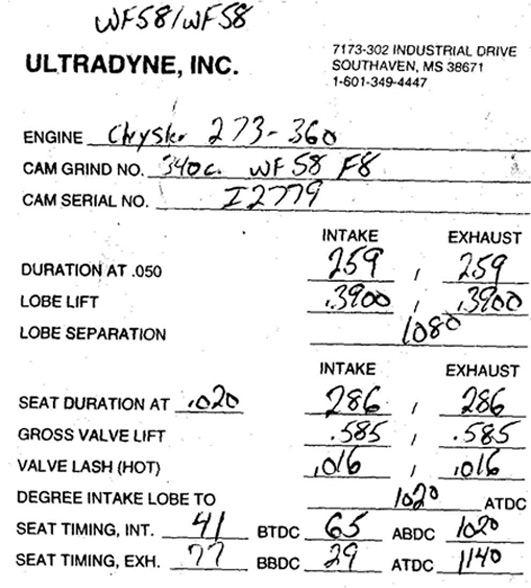

If you look up the cam spec it should tell you what spring to use with that cam....have you got the cam card???
I wondered why I couldn't get your attention Dunc ;)
Cam card below Pete... :)

Paul I think my mate EJ has a photo of you launching you might find interesting...plume of smoke underneath very clear. I'll get him to email it to me and try to post up tomorrow.
Gas for GOSH wrote:Paul I think my mate EJ has a photo of you launching you might find interesting...plume of smoke underneath very clear.
Clutch.
Posts: 22109
I agree - at the time I thought the car was over-fueling; but I was not aware of DB's "mis-hap" at the time.............
This vid (poached from Eurodrag) seems to support clutch fail... (jump to 40 secs if you don't want to sit through the embarrassing burnout stall :roll: )
Dave and Pete- I can hear you muttering 'told you so' from here :P

Paul
photo for you as mentioned above.
Simon
Santa Pod 2013207005-173-1 (640x426).jpg (254.15 KiB) Viewed 3604 times
Thanks Simon, yeah that's a dead giveaway!! :shock:
I'll be saving up for a fancy clutch ready for next year then...
Posts: 22109
db wrote: I'll be saving up for a fancy clutch ready for next year then...
It will drive like a Bear trap.
Ask Blue.
He had a nice chat with the gent who owns "Crowd Pleaser".
He will tell you what you need to get off the line without breaking on a repeatable basis - also dropping the clutch at over 7K :shock: :shock: :shock: :shock:
727 time with a MRPVB :thumbright: Its a long way home to the edge of civilisation on the back of a low-loader............
db your car looks the part, nice mean stance ,looks so cool ,and I am not in to drag racing as much as road racing ,but your has a place ,right on the strip :thumbright:
