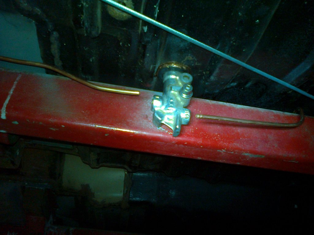

Here's mine- I mounted it on my chassis.
It pokes out under the drivers seat, I can adjust when I'm driving if it starts raining :thumbright:
Brake valve 02.jpg (116.48 KiB) Viewed 1058 times
Brake valve 01.jpg (102.44 KiB) Viewed 1058 times
db wrote:Here's mine- I mounted it on my chassis.
I think you might leak fluid without longer brake pipes on that installation Paul. :lol:
:P

Anyway here is my adjustable valve - I also decided to put it under the seat, though agree with Dave, in most cases it will be adjusted once and never again!
