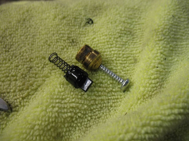

The other difference between discs & drums is that drums will have a residual pressure valve (usually in the master cylinder), because drum brake wheel cylinders use umbrella type seals they need a small amount of pressure to keep them sealing. The return springs are stronger so the brakes don't bind. If you don't remove this in the front brake circuit the disc pads will not release properly. Ideally you will change the master cylinder for a proper disc/drum one.
Yeah you have to use a disc/drum master cylinder but I think the residual pressure valve can be removed from a drum MC. I seem to remember you remove teh pipe fitting from the MC and it is in there?

Yep Dave a self tapping screw and two screw drivers to leaver it out:thumbright:

DaveBishop wrote:Yep Dave a self tapping screw and two screw drivers to leaver it out:thumbright:
Yes you can, but you will write off the taper that the pipes seat against so you will need an new one.......... ;)

Posts: 22137
Yes but if you take the valve out, it sits behind the boss that makes the seal with the pipe, and you have just destroyed the boss to get to the valve...........

Post by DaveBishop »
Hi Pete when you used to get rebuild kits that is what the instructions told you to do. They supplied a new one in the kit you only put them back when you had drums. I remember doing this years ago when I changed to discs on the front
